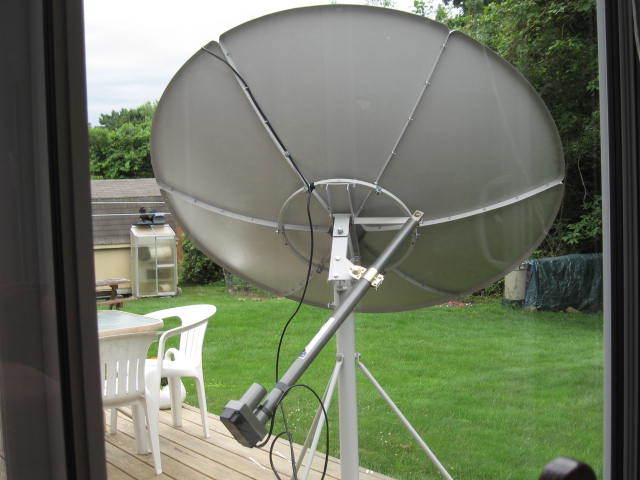

Hooked up the new QARL 3624 actuator and it works like a charm.This beast really looks tough and well built compared to the HARL.Still dont like the way my DMX741 seems to be working!Like tonight!strong signals on AMC6 then poof!! no sig or very little(no wind).Checked another sat i had stored and signals going all over the place.Maybe its the weather tonight but i dont think so! Dont seem to be having problems with my 36" ku set up.I will monkey around with the DMX741 for a while more but if i continue to have problems then i will get a c band only LNB and see if that solves my problems.Heres a pic of my new QUAL hooked up to the 6ft dish.
