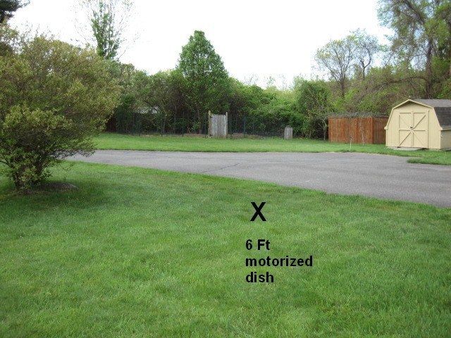

I have had my motorixed ku band set up for only a few weeks and now getting the itch to add the C band.Im thinking of getting this package from Sadoum Motorized combo Satellite Dish with HH Motor, LNBF, Offset Prime Focus Fortec Star Winegard (MKit 4).I would like to stick with getting a 6 ft dish!any larger and my wife might scream :eek:.Will i miss out on much if i dont get any bigger?.Here is a pic of Dish location!great views to the se/s/sw.Do you think that FTA C will be pretty active next few years to make such an investment worth while?

Iceberg has been using a 6' Fortec for quite a while and I think he has said he gets about 90% of the available C-band FTA stuff that is up there.
Size definitely matters, you will have issues receiving some of the weaker signals, DVB-S2 and high FEC stuff, with a 6 footer.
That being said, there is a lot of stuff you will be able to get and enjoy, and C-band FTA should be around for years to come.
On C band the bigger the dish the better it works. 6 foot dishes are okay for stronger satellites but do have a problem with 2 degree spacing. You can under illuminate the dish some, that helps with the adjacent bird spillover but you loose gain. I know your wife is a factor but if you can pull off at least a 9-10 foot dish you will be allot more satisfied with the results.
I would say go no less then an 8 foot dish. The size isn't all that unreasonable.
There are probably a lot of free ones around you if you look a bit, saving the $$ of a new one might be a factor in getting the missus to warm to a 10 footer. There is a lot more dvb-s2 on c-band than ku, you wont' see much of it with a six foot dish. That is a nice site you have there to plant a dish.

If you can put the dish out of sight in the back yard? Somewhere out of sight. The six footer is good. I had virtually the same dish with the Gbox and a 24" acutator. It does get 90% of whats on Cband. The S2- hi def stuff some of it with a six footer is iffy. Nice setup if you can do it. There's a lot of good stuff on Cband. I spend more time on those channels than the Ku stuff now....blind
Thanks Blindow!I do have a spot in back of the house where it would be hidden from the road and only my southern neighbor might be able to see it in the winter when leaves fall.The spot isn't as good as the front!may not be able to get some of the father west sats due to trees,but i should still be able to get a good chunk of the arc.Thinking of sending sadoun a email asking for a price on the c band motorized package with a 8ft dish instead of the 6Ft. 8ft is as big as I'm willing to go!Do you think the 8 ft will pull in what a 6 ft might miss?
You will for sure get a better signal if you can pull off the 8', it will make the difference in getting the ones that are on the edge of break-up or not getting at all.

Thanks LC :) I think i have the wife onboard!she just thinks i spend too much money!but we dont go anywhere so i figure why not spend it home and enjoy.Im just alittle worried about the town making a stink about a large dish!zoneing says 1 meter max.best thing i can do is not place it on the front lawn like i would like to do and place it in the back!hiding most of the view from the road.
Thats a real good reason not to spend money on a new setup, I'd look for a free one that someone is looking to get off their property, you can set it up and if worse comes to worse and the town says "take it down" then you are only out your time.
I have been looking!but so far no luck!Dumb zoneing law!I have a patio umbrella thats the size of a 8 ft dish and thats ok.I could set up a meeting at the town hall foe a excemption!Just have to convince everybody there that it wont be a eyesore.
I'd say go with the 8 footer over the 6 foot if you can. I noticed a difference on several channels. I've never ran across zoning issues like the one where you live. Maybe you try and get an exemption. If it's a small town they might work with you, especially if it's out of sight. Let us know how it works out....Blind
