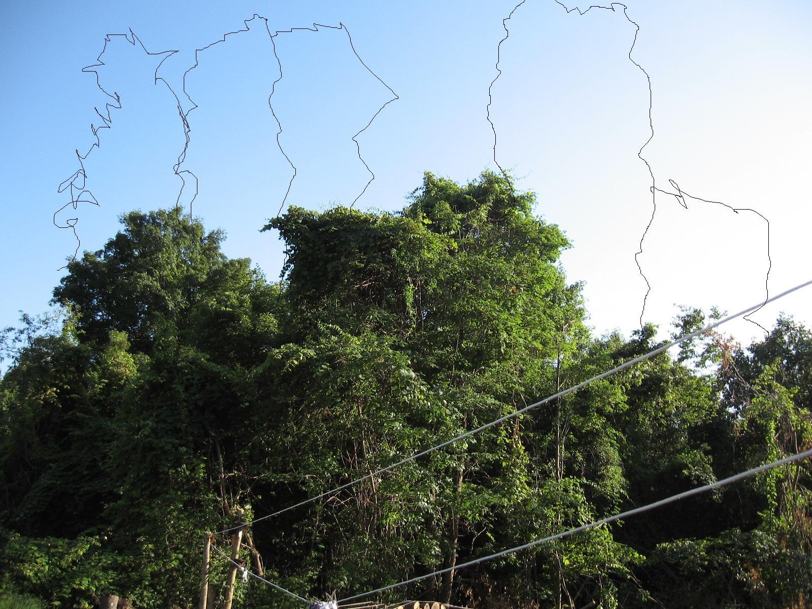

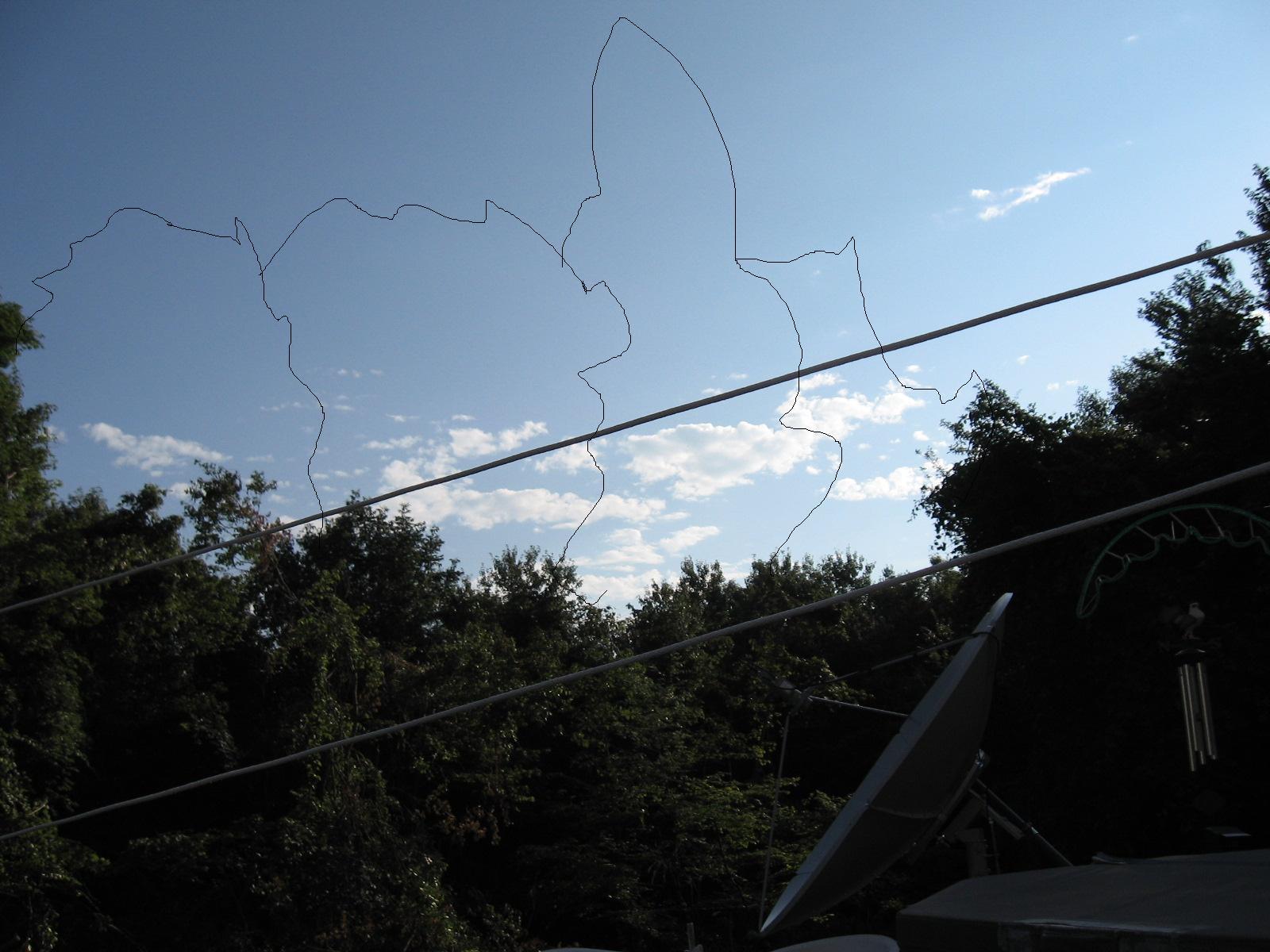

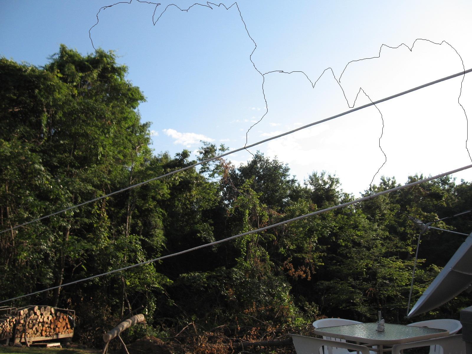

Cut the last tree today that blocked my LOS.It was hot all week but now i will get from 30 to 135w with no LOS issues and i will have lots of firewood for my wood stove:).Heres a few pics!The outlines drawn above the trees is where the trees blocked before.A total of around eight trees came down the last few weeks.
