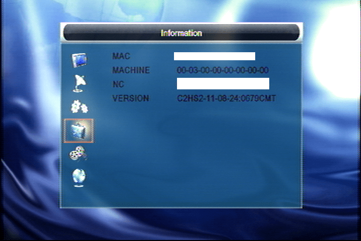

I've seen that on mine, but I think it started with a recent firmware version. Which one is he running?
Since it's not too usable that way, you might want to take a chance and try another version. There was just one released at the beginning of this month. http://www.wydvb.com/UploadFiles/HDS2_OPENBOX S9(20111202).rar
I put the version of firmware on it (and my S10) that was posted a few months ago, I think it was posted around August and there are a bunch of threads about that version being the SG approved version.

Next week I need to go over there and see what I can figure out. I need to know if when it locks up, does the motor move the dish when he tries to change channels. That was the problem with the last one, the power supply would stop sending power to the motor and LNB. Is it doing the same thing on this new one? It is a replacement they sent, I marked the original one with a few secret marks in different spots to make sure they didn't try to pull a fast one and send back the same one. And that's barely been a month. I think it came in just after Mom passed away then sat for a week before I set it back up.. The past month seems like it was a million years.. This has been the longest month of my life.. :(
Anyway, I'll go over next week and see what more I can learn and maybe try this new firmware too. I've got to do something, my dad has no tolerance for malfunctioning machinery and since I am the one that suggested all this stuff to them, I'm in the middle of it all.. :(
