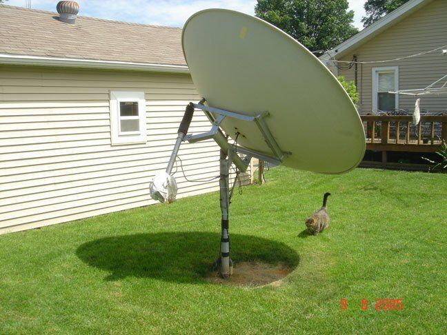

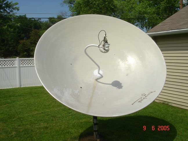

I've had this baby for over 20 years. Solid aluminum, no :no warpage here. If you are going to go BIG, it's worth a few extra bucks to get analog and 4DTV. You won't regret it. :yes
I'd love to have one of those, but there weren't many of them sold in this area. Been looking for years trying to find one hidden up a holler that I missed. :)
