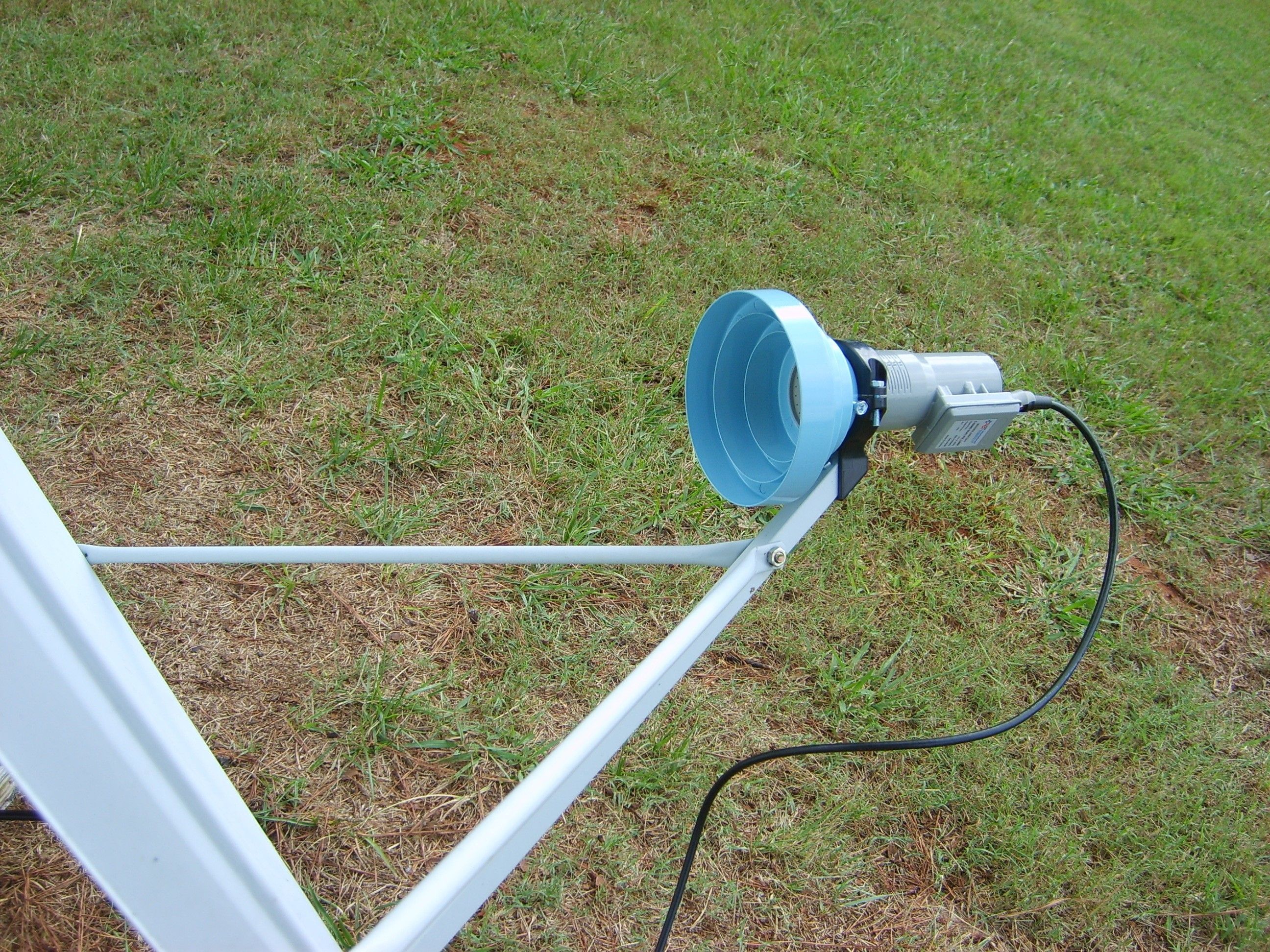

Proper skew for this LNBF is and always has been 12 or 6 O' Clock. ;)
S6000500.JPGOh, I think I know what you mean. Of course, the pin has to line up with no skew, straight up and down [with the other pin perpendicular] as you look inside the tube. But yes, I had to turn it into the opposite position that I usually put my DMSi BSC421 DRO LNBF in when using it on the microBUD. That is, the outside "boxy" casing, looking at the dish from the front, should be in the 4 o'clock position rather than the 8 o'clock position. Don't forget to slide the LNBF as far back as it can go in the holder (the end of the scalar should touch the holder). I didn't take photos of the Titanium. Pics are worth a thousand words :) Here is a photo of the BSC421 (ignore the alignment with the scalar...although I had good results with this configuration, I find lining the lnbf up with the first inner ring of the scalar is best). The lnb/box casing needed to be on the other side on the Titanium for the correct polarity.
