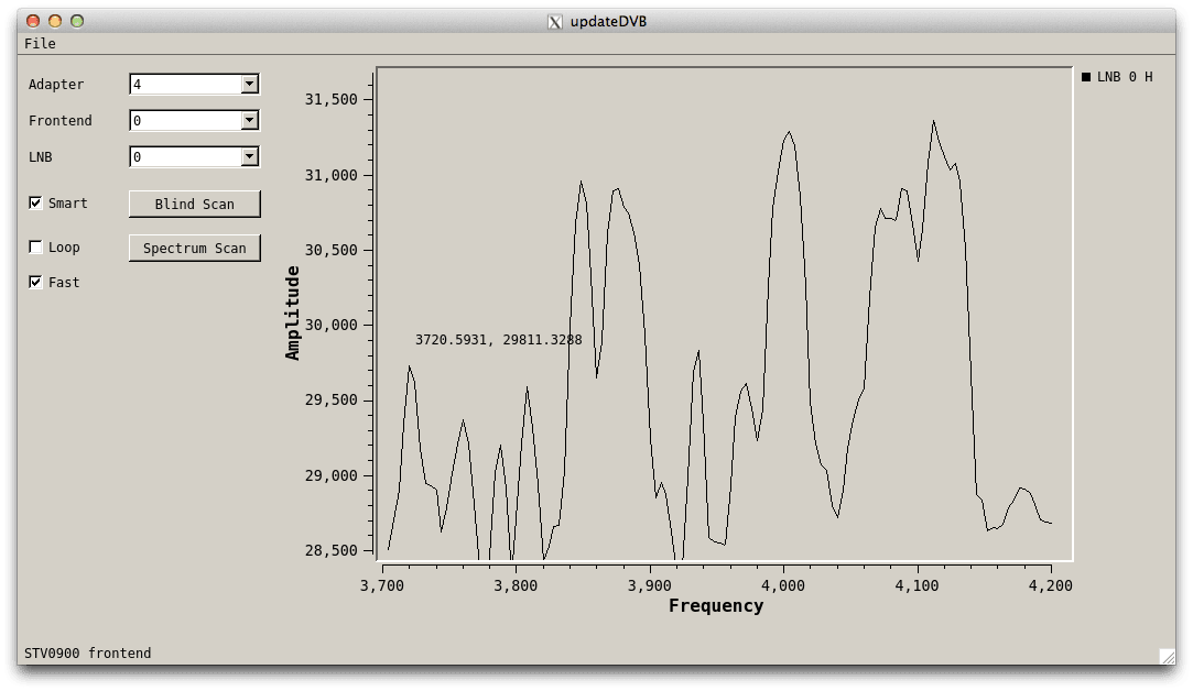

lyngsat shows it as 8/9 8psk which is not going to be an easy one to lock, combined with the fact its a low signal level compared to other tp's. I cant get it here at all.
Youve got a 10ft dish which will help, combined with the fact your farther south then me I bet will help more as well. But your still going to need a pretty finely tuned system.
