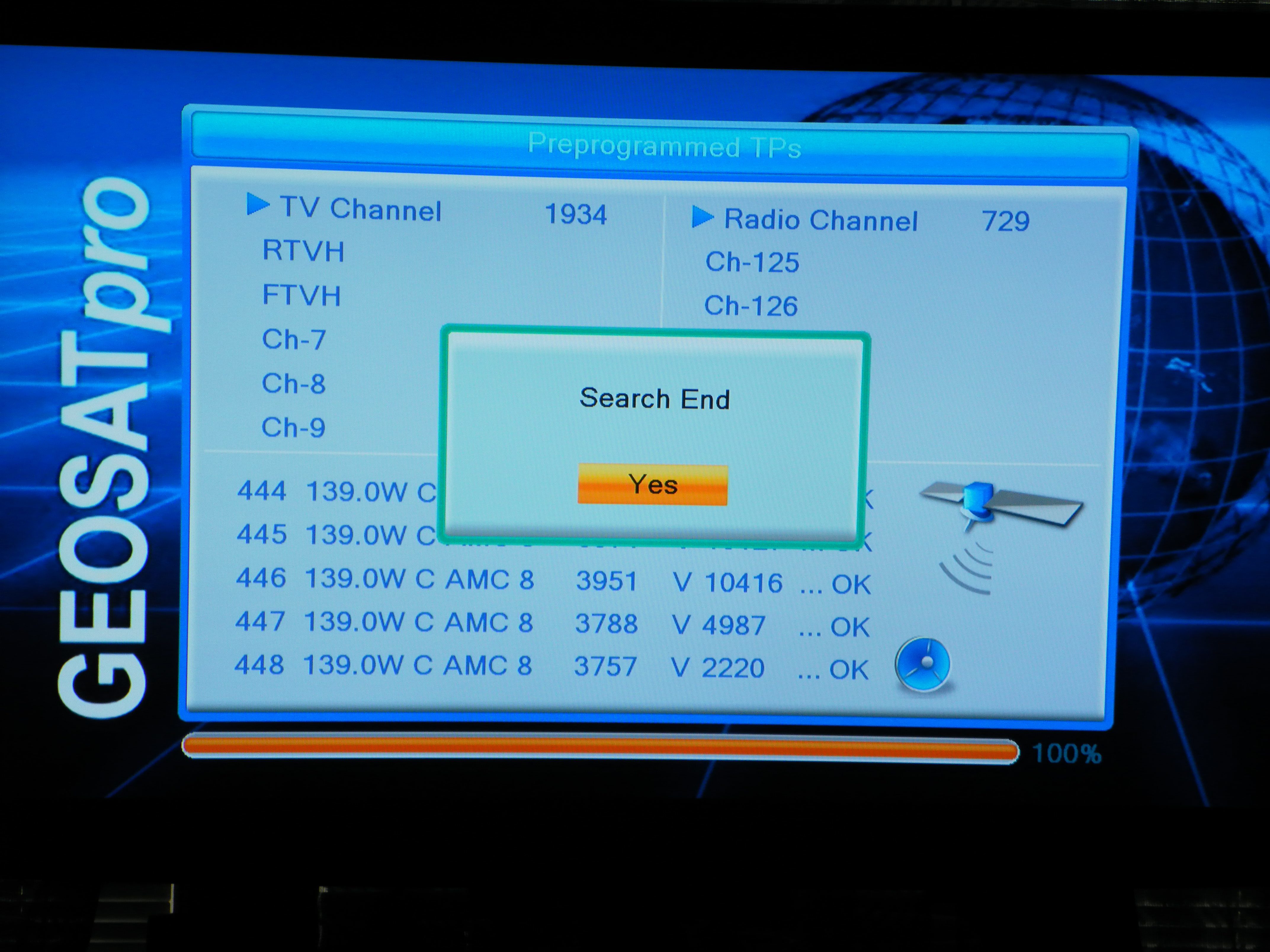

I created a new satellite list as suggested. With no transponders in the new list I did a detailed scan of all satellites begining with 55.5W C-band. After five hours the scan was completed. It skipped all the KU sats or didn't find anything. One position has a KU sat only. During the scan it moved to that position but never reported any KU band info. Scan performance on the C-Band side was less than satisfactory, missing several channels. I scanned KU sats individually afterwards and had good results. My efforts to improve the multi-sat scan have made it worse :(
Still working with the multi-sat scan feature. After populating all sats in the list with transponders, (performed detail scan each sat and deleted channels), I've completed two full scans of all KU and C-band birds. via Transponder search all channels, and deleted channels and FTA only search. These scans did not miss a thing. I figured why I was missing some C-Band channels from an earlier scan. The microHD labeled some channels $ that MyTheatre didn't, ie FTV HD on 55.5W C-Band.
It took 50 min to do a complete scan of 48 birds. How much of that time was the microHD waiting for the "moving dish" popup? A lot! In other words this thing is fast!
