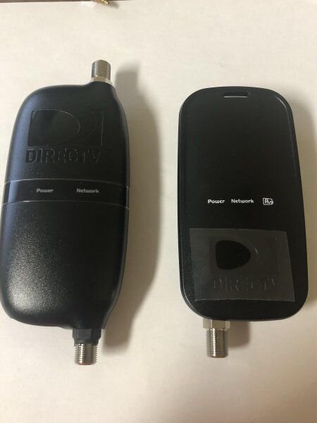

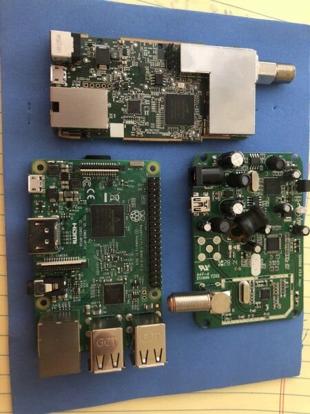

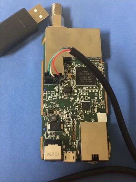

Playing around with a directv deca adapter. Installed pin header now trying to find win10 drivers for ttl cable. Wanting to see if stats are available console like.
The DCA2SR1-01 and DCAU1R0-1 are rock solid and dirt cheap ($10 a pair) for a 100Mbps over coax.

I believe the statistics for DECA adapters come via the network.

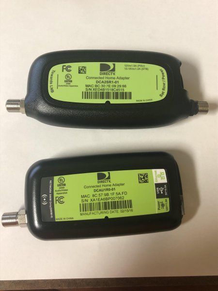

The nice thing about Ethernet is that it doesn't require AC power at each end of the cable as DECA adapters do. The power required for DECA is relatively high (as you can tell by looking at the label -- up to 18 watts). How do you plan on powering the DCA2SR1-01?
If you're thinking about diplexing, don't forget about insertion loss.

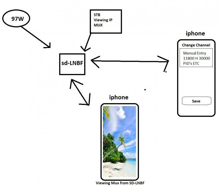

So the idea is. SD-TVRO
Software Defined FTA.
The heck with STB's. Why not use the devices power houses spend billions to development for viewing?

Have you given thought to what is involved in blind scanning in software?
Yes that's whats awesome. Think about having 4 SD-LNBF's you could be watching a TS stream via one of the units and have the other 3 blind-scanning using hardware based blind scan.
I get that a lot of FTA is about jumping through hoops, but avoiding the first hoop of being able to find and watch TV shouldn't be bypassed.
Nah man your not bypassing anything. In fact it would allow you to watch more stuff. It's just the TS('s) streams you choice delivered over IP.

Pi 3b
USB DVB-S2
Deca Adapter
Still need to figure out power?

Why add the complication of devices? If all of your terminal devices connect via Wi-fi, what purpose would something like a DECA adapter serve? What do you plan on using for a server to serve up streams those devices? For their part, DIRECTV uses RVU which requires a very special server running software that must be licensed on both the server and the clients.
Are you familiar with what goes into creating software for media servers and device apps?
Are you going to create this hardware to do blind scanning in association with your SDR tuners? If you're going to use conventional tuner chips to do your blind scanning, how will your streaming server collect the results so it knows what is available?
I think you may be getting all gooey about hardware and completely forgetting the software side of things.
What software is it that will do this magic on the server? What about the clients?
Do you know of any apps other than VLC that can handle TS streams or are you envisioning some sort of tuner plug-in for VLC?

You don't understand that's my fault for not being able to articulate it better. :)
Yes I do one of my companies does software development.
The DECA adapters don't matter its just a bridge you could use any bridge you want.
There is no server. The clients are whatever device you want to view the TS on.
ffplay
What do the terminal devices interact with if not a server? Devices like the iPhone and Roku depend on servers to make connections to things like satellite tuners. If you have to develop an API from the ground up, that's a tall order and that's not something that Apple, Google or Roku provides at this point (although Google is arguably the leader here with their AndroidTV product but it still depends on a media server).
What of the TS viewer on the client and how will it choose channels? I submit that you're expecting apps to do things that they have heretofore not done.
The SD-LNBF will be the "server" it will put the raw data on IP. UDP
To start just a few simple pages to run scripts.

What is this IP SD-LNBF that you're talking about? That may answer many questions if you have a magic feed horn that produces an IP stream rather than a RF signal. This still doesn't answer the question about how the client device chooses channels.
Bingo!!!!
