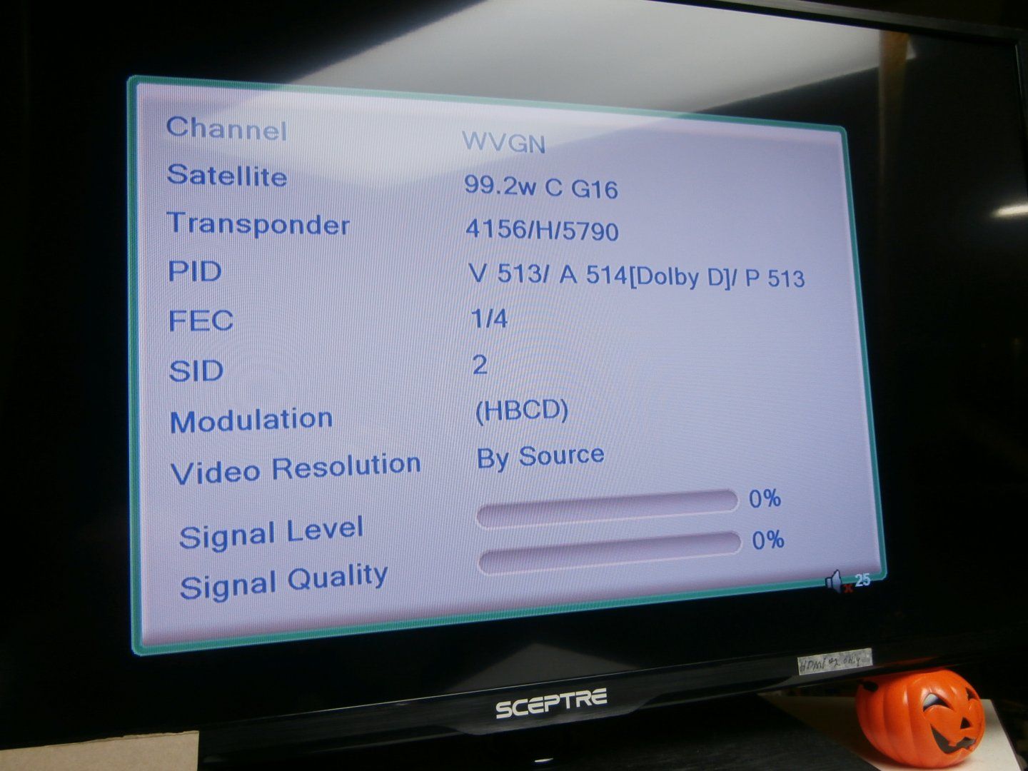

OK guys here is a pic of my Micro HD and tell me what you see listed for the FEC on that channel! Hint, it AIN'T 4/5! And keep in mind that this channel is the one that came on as soon as it finished booting up yesterday. And both my Micro HD receivers have that same FEC for these channels.
Reactions: FTA4PA
Don't believe I have ever seen a FEC of 1/4? :what

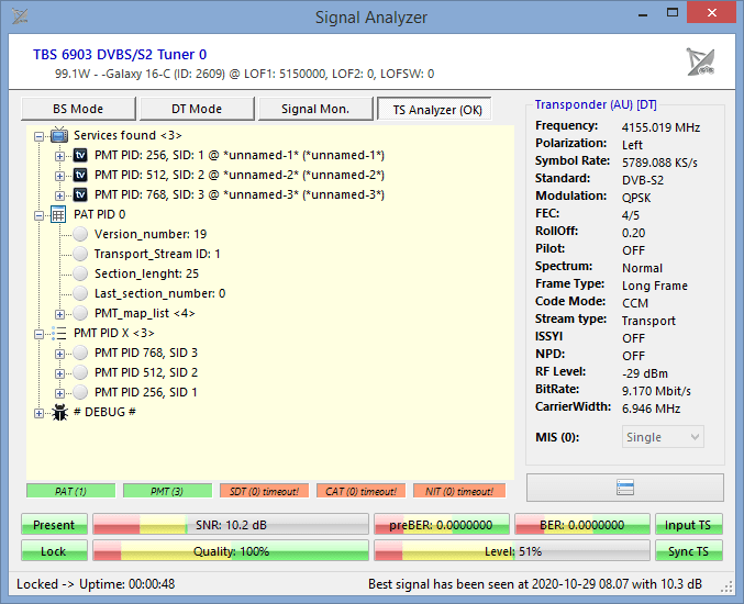

After some careful tuning, I am now receiving the 3-channel Puerto Rico mux on my mini-BUD tonight. An interesting set of channels.
I followed the procedure above exactly using my microHD. I see no problem here. I can move between the three mux channels or between different tps on 99W and all channels that I can receive lock in correctly. One difference in our situations is that my received signal is only just above threshold at about 5.3 dB as measured on the Edision or a reading of SQ 25% on the microHD.
