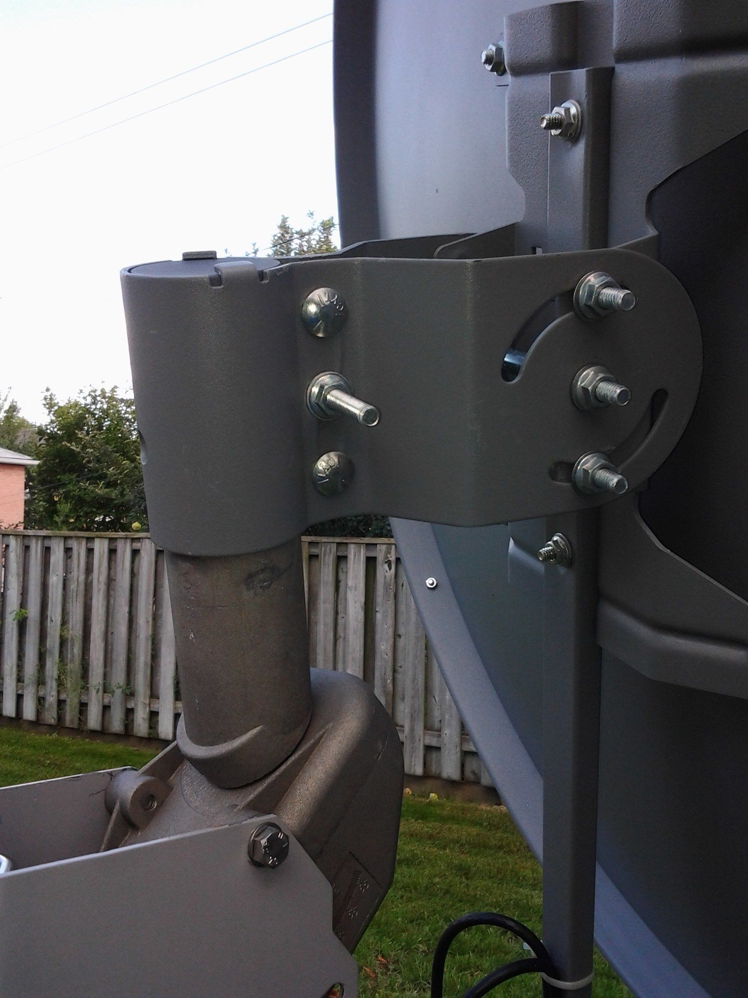

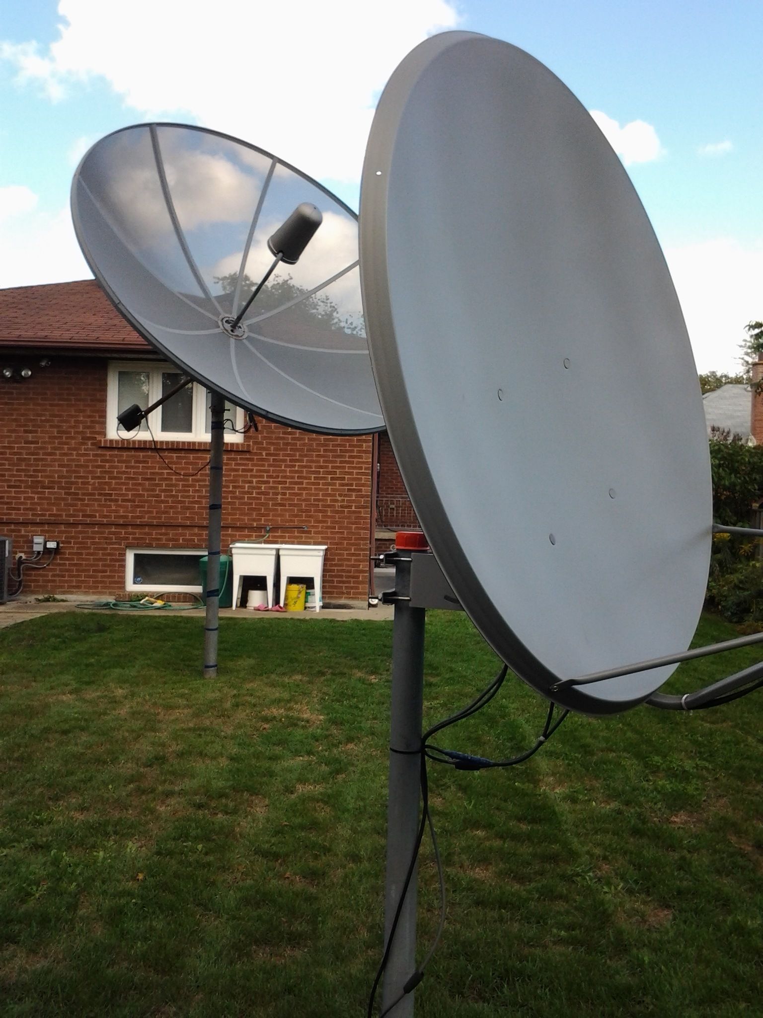

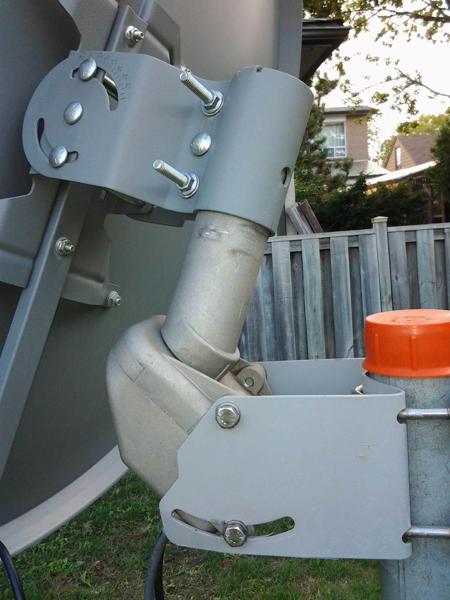

I did not have to do anything to the mount or to the tube, here is a couple of screenshot: 20120915_150851.jpg
Thanks for the reply and the pics, tede. I not really sure what issue the guy in the review at the vendor's website had an issue with so I just wanted to double check. That dish looks a lot like my 90cm (which has been a gerat dish) but these days I am missing a few feeds due to s-2 or weaker signals not locking as well as needed. So plan to get a 120 before too long.
