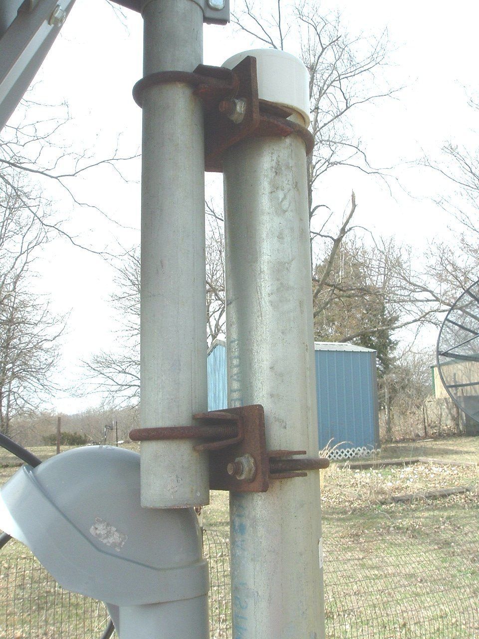

I have looked for adapters with no luck so I was thinking I could clamp a short smaller diameter fixed mast for a fixed small dish (20") to a larger motorized dish mast. The attachment point would be below the motor and the fixed dish mast would go up and past to the side or behind the motor. I know I saw a picture somewhere, I didnt save the location. :(
Well i had posted this picture a long time ago. However I cant find it now. The hardware was all new then. Now its rusty after a year or two. It was accomplished by two different size muffler clamps and a piece of flat steel. It is not on a motorized pole, but dont see how that would matter. This adapted
a 1 5/8 to a 2 3/8. Dont know if this was the picture your looking for or not.

Hmmmmmm. Interesting for sure and it might work for me with a motor above.
I'll have to check how far out the smaller mast must be, before it would pass by the motor.

Those are two separate conduit clamps bolted together (different sizes), they are holding an attached 1 5/8" pole for my OTA antenna :)
Sounds good for something very light weight.
I wouldn't imagine putting much of a dish on the secondary pole, but maybe a little DBS one might work.

I think it will work well for a single LNBF 18" pointed at 119°W. Even Dish 500 might not be too bad. Especially if you're not in a real windy area, or your dish is shielded.
Good point on the weight issue. My OTA antenna is a small Winegard Square Shooter, which doesn't offer a whole lot of wind resistance or weight. I'm not sure how well it would work if it were something as large and heavy as a typical FTA dish though... Also, keep in mind that my install is all on an NPRM and up on my shed roof.
