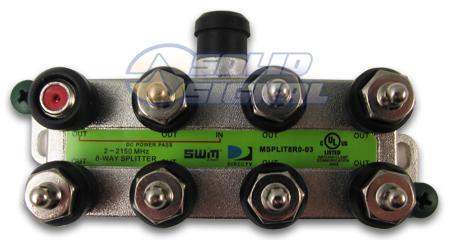

Everything works fine, but when I try to go to my old set up using two of these (image below)
I cannot seem to get a signal to the 2nd one and I'm not sure why? Its the same set up I was using at my other house. Its a single line.

Are you trying to use two 8 port splitters, that setup for 6 receivers would be much better with one 8 or two 4's, or even a 4 and 2.
Only thing initially that comes to my mind is the power passing, is your inserter inline with the power passing port on the splitter (top left)?
Oh no I need both of the 8 port splitters. I have a total of 10 tuners. My power inserted is counted at the genie. Should I move that the basement?

Hes got 11 tuners in all, doesn't he need more than the 8 splitter ?
I do mine the way some others have mentioned, off the LNB to the Power Insetrer, in and out then to the red port of the splitter and set up the recvrs from there ... that said, I'm only at 7 tuners at one place, so I am not dealing with the same exact scenario.
I will say this again since it has been said multiple times. Splitters ports are to connect "receivers" regardless of tuner count. So for 5 receivers an 8 way will suffice. So even if you had 4 Genies (20 tuners) a 4 way will do.
But will I have any tuner conflicts with dvr's?
I wouldn't have posted such if it wasn't a correct installation method. There was an installer urban legen where the splitter had to big as big as the tuner it needed. That has been busted long time ago. You can connect a single cable from teh LNB to a Genie wiht nothing inline and no problems. You can connect 2 Genies to a 2 way (10 tuners) no problems.

Tuners only matter with the swm equipment.
Not the splitters.
The Swm 13 LNB is fully integrated to support 13 tuners.
A swm 16 in not fully integrated with its tuners, It's essentially two swm 8.
(It's 16 tuners are fully Integrated with its MRV technology )
Meaning even though he has 11 tuners and 5 receivers, A single 8 way would not even work on a swm 16 for 11 tuner setup.
He would need a 2 way for his Genie,and 1 HD receiver, and a 4 way on leg 2 for his 2 HRs, and HD receiver.
As an example, there are a few ways he could do it. But he can't excede 8 Tuners per leg.
I think that's where Jimbo is getting confused about.
The 13 Tuner LNB is fairly new.
Previous installs over 8 Tuners required a tuner count thought process to not over load a single Leg of a swm 16.
