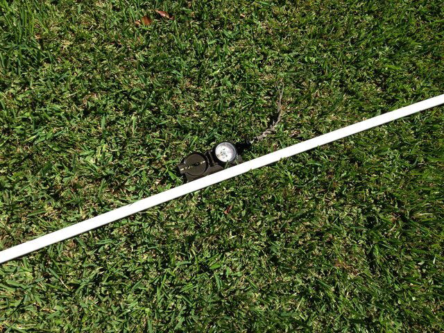

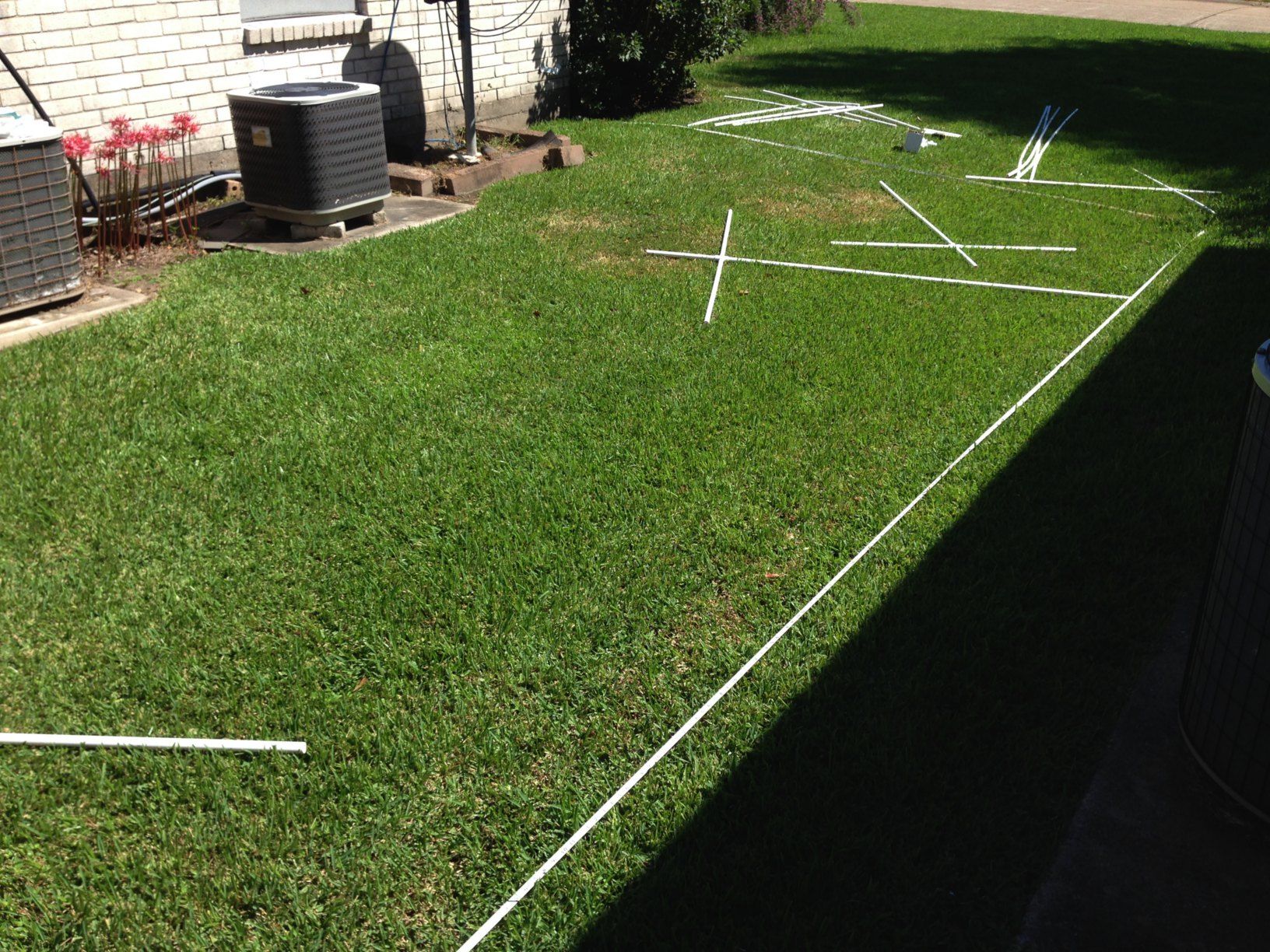

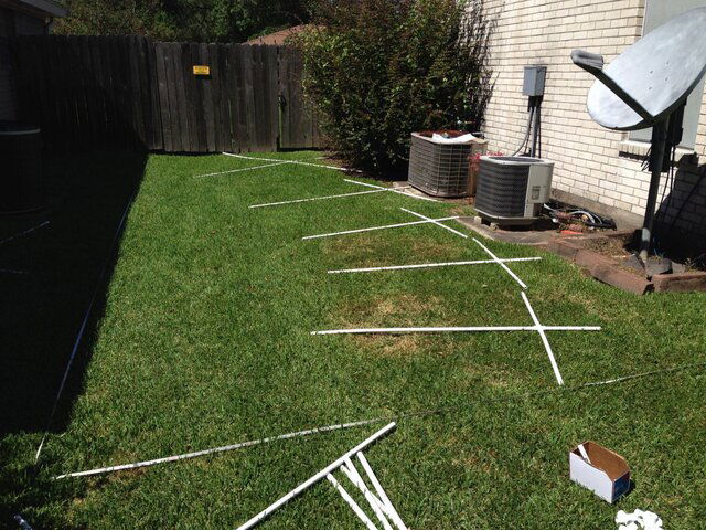

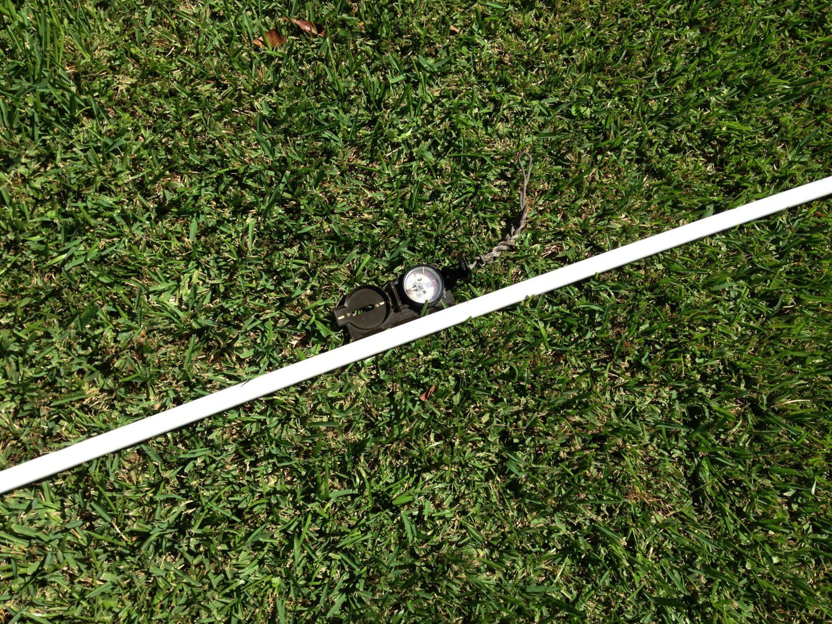

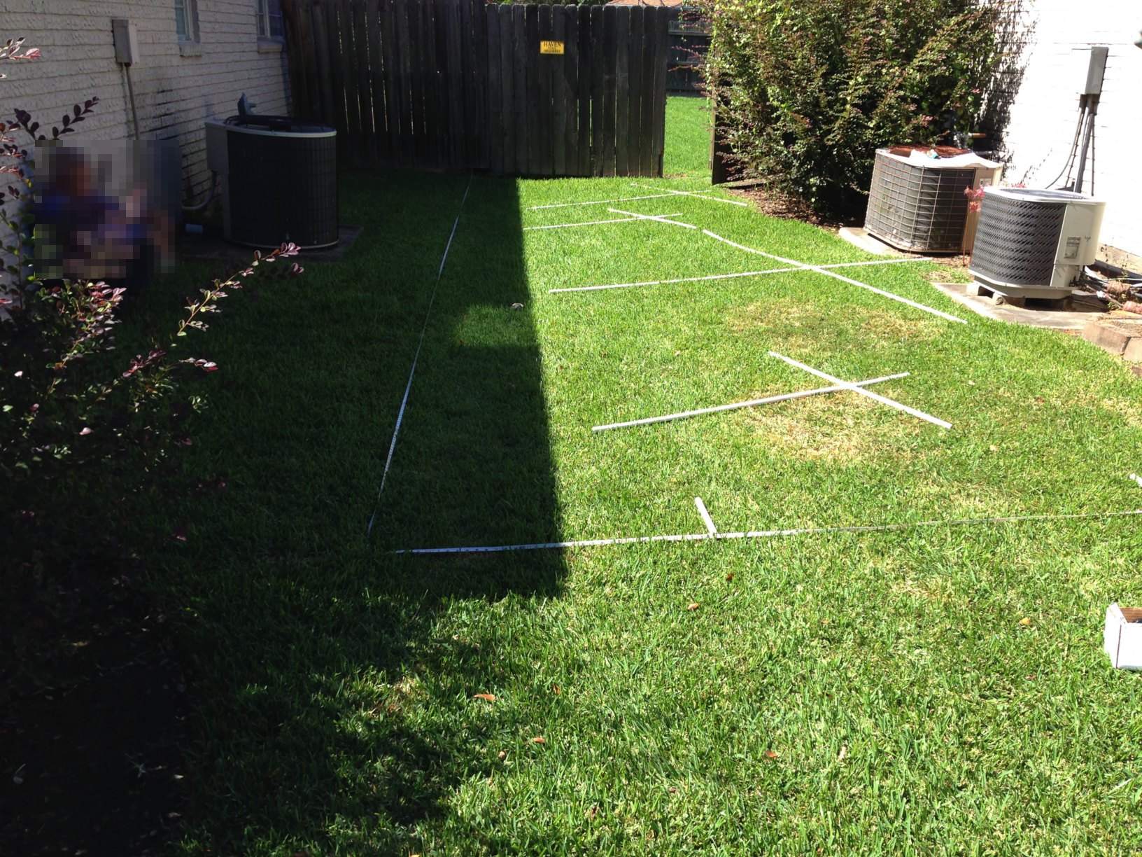

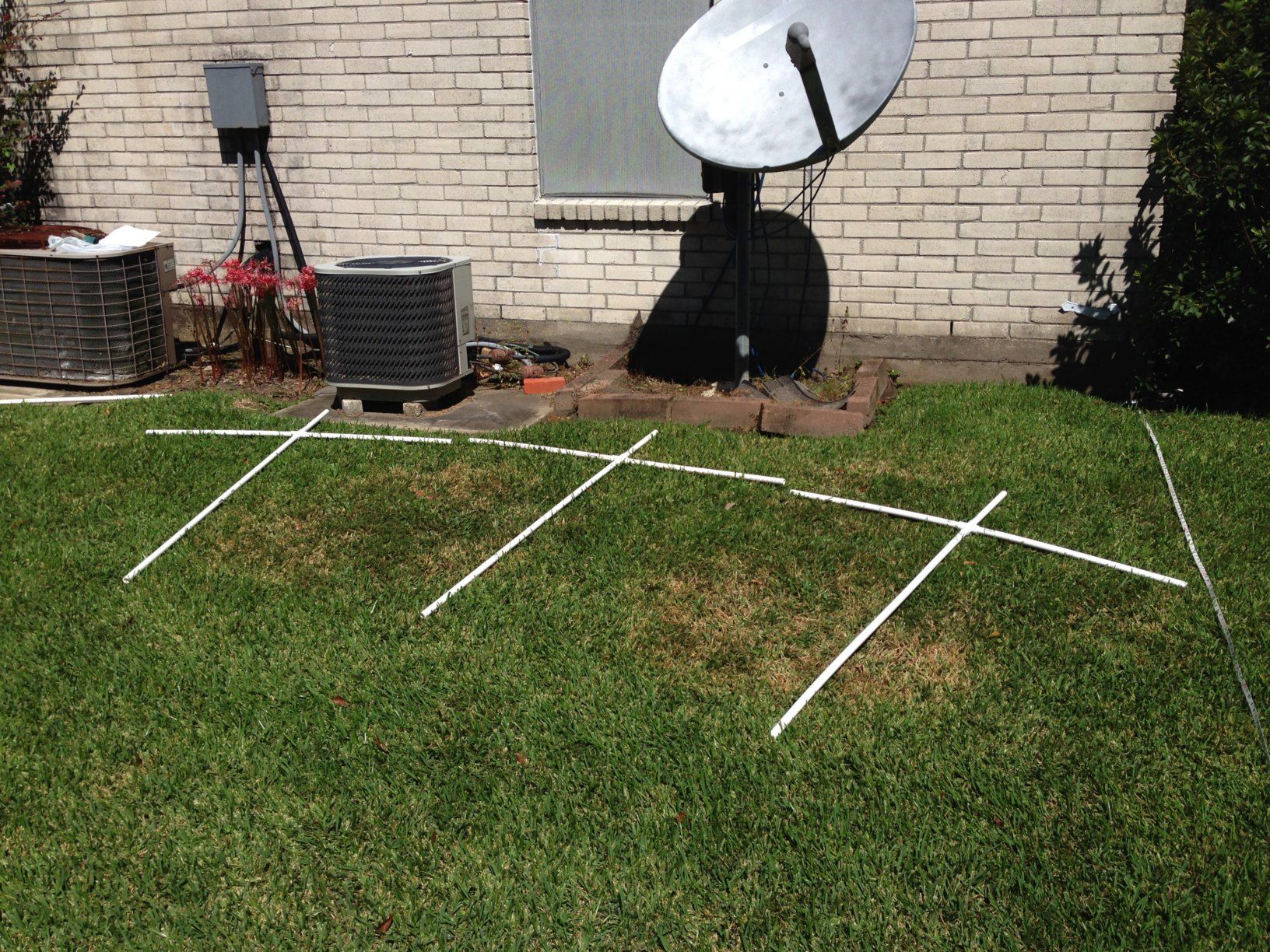

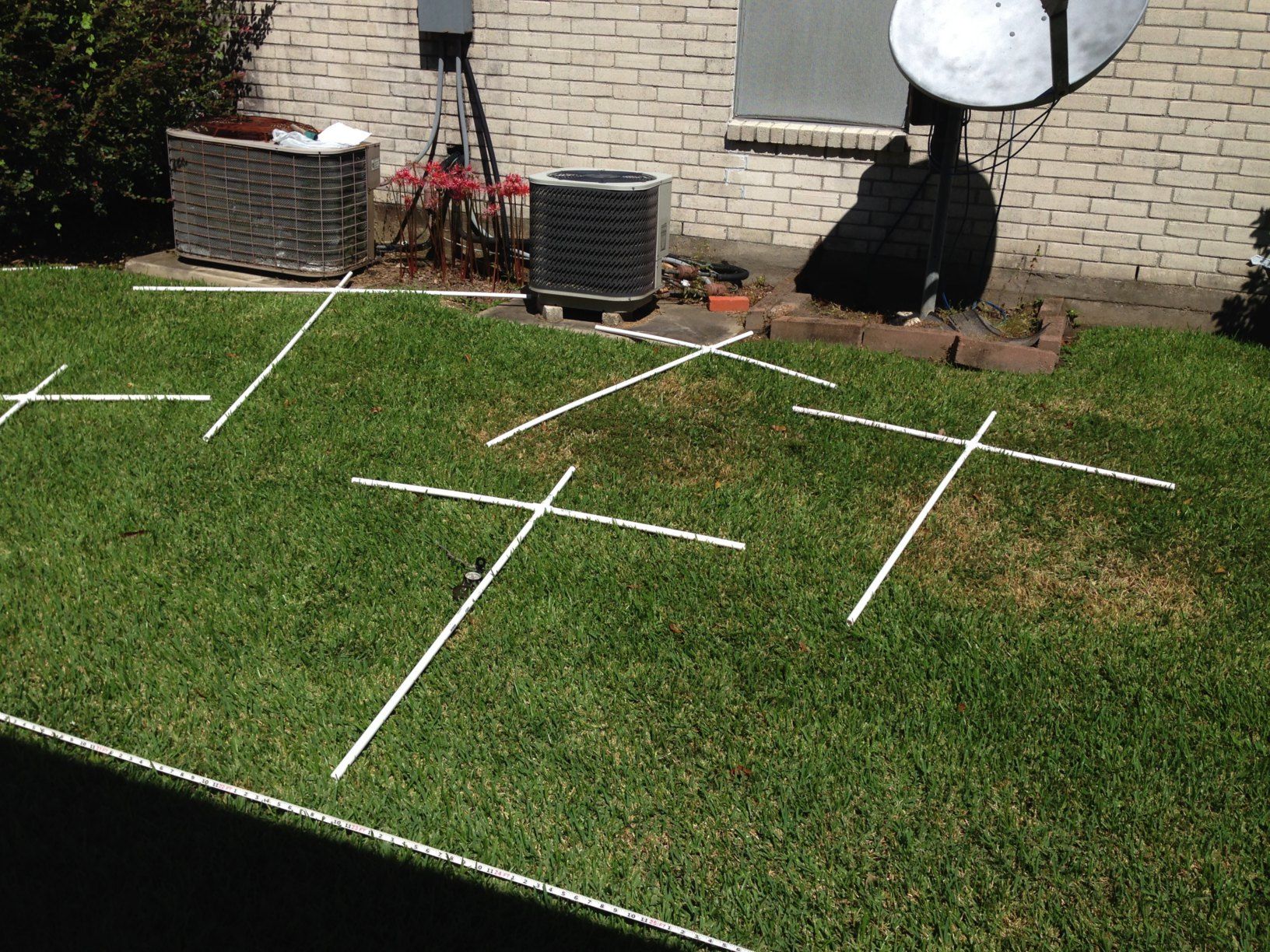

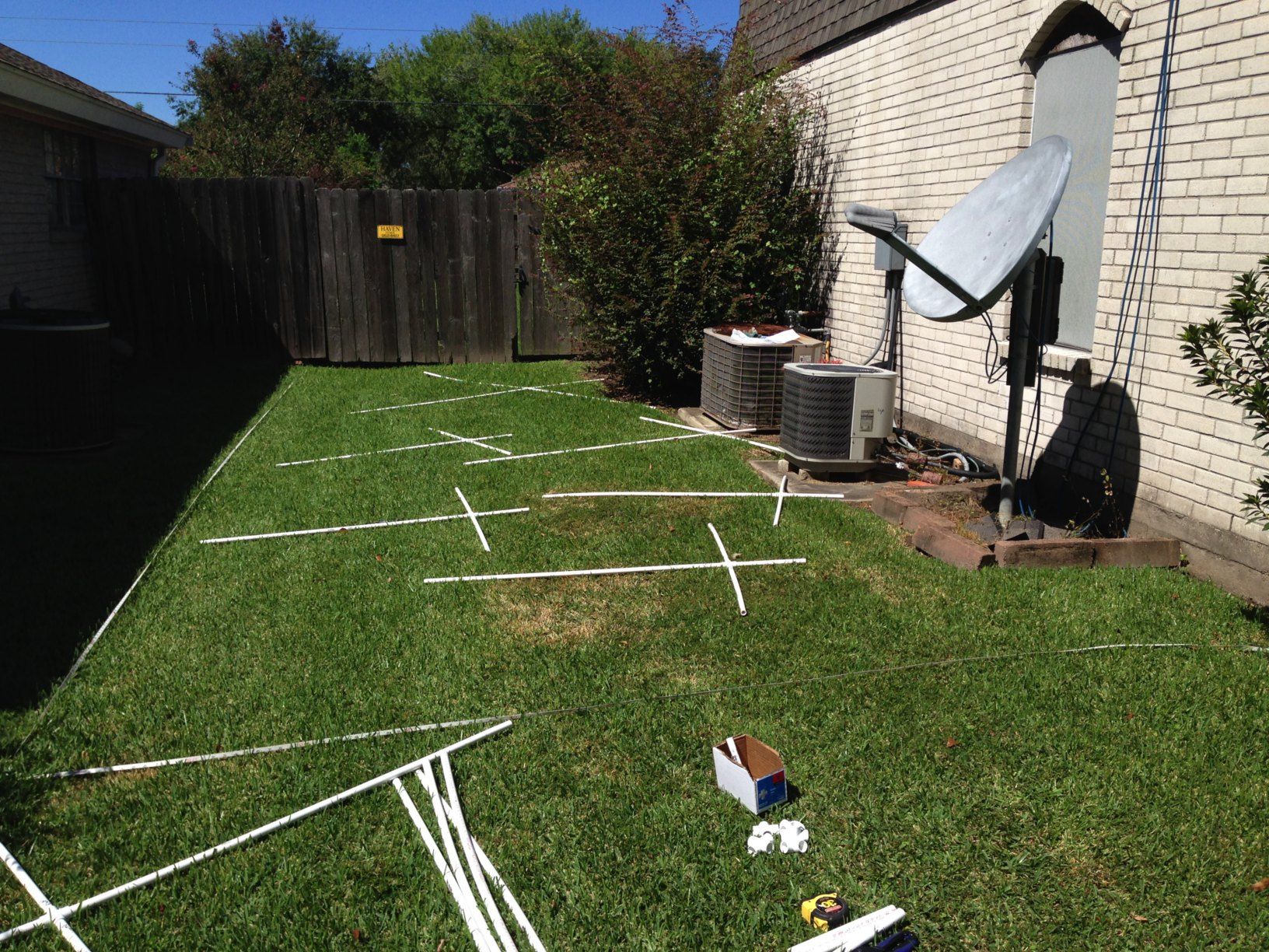

So what I did today over there was take a tape measure and stretch it out along where the new fence will go.
Then I cut PVC tubes and fit them together to represent the footprint each dish will require, I measured each dish I have and cut tubes to represent the clearance needed on the back, the sides and all the way out to the edge OR the LNBF, whichever protrudes the most. The X piece in the middle is where the poles will need to go.
I laid them on the ground to see if I can fit them all within the 14x30 area, to make sure that they don't overlap and cast "shadows" over one another or otherwise physically hit anything such as the fence, air conditioners or each other.
Much to my dismay I can just barely fit half of them on the side. Because I need to keep 'like dishes' together, IE FTA vs Dish subscription, I came to the conclusion that I can fit my FTA dishes on the side of the house but that my subscription dishes will have to go in the backyard along the side of the garage. I did not want any dishes in the backyard, I wanted it to be strictly tech-free back there, just gardens and stuff but there's no other way.
So I'll have to bury a conduit from the house to the garage then have my Dish SW31 switch branch out to the three dishes. I didn't take a photo of that, I was tired and forgot to.
I spent a few hours baking in the sun shuffling these things around trying to make everything fit. I also took into account that the C-band BUD will have to be up high enough to clear the air conditioners.
I'll actually have to have it's pole about 6' tall so it will clear. That will make working on it very much a pain in the backside and require a tall ladder. That part I'm not happy about.
Anyway, here's a few pictures of how I was trying to figure this out today. I laid a compass next to each "jig" and aimed them in the direction needed. The first few pictures were me trying different things, all of which were a flop.
The LAST photo is fairly accurate placement of where my dishes will go.
Furtherest back near the fence/gate will be my 6' mini-BUD. Next, moving to the front will be my 10' BUD. Closer to the front is room for my 1m USALS KU dish which will be close to existing KU (my dads)
Back in between the two BUDs I have room to drop in a 1m to leave on 97. Or better yet, 103 which will never become SES-3. Jerks... So I can get all my FTA dishes into the house on two wires then my subscription dishes on a third wire.
It's going to be a whole lot of digging. But since I'm having the fence extended on both sides of the house I'm going to have the fence people drill the holes for the dish poles and put the cement in but I'm going to do the leveling of them because I don't want "good enough" or "close to level", I want absolute DIGITAL precision with ZERO POINT ZERO percent error. They may not like a woman shooing them away to take over something they think they should do but that's just too bad, I'm paying them to do a specific thing, MY WAY. MY WAY....
So now I have a pretty good idea of what needs to go where and that yes, it can be made to fit. Mostly. I'm not really pleased with having to put dishes in the backyard but there's no other way.

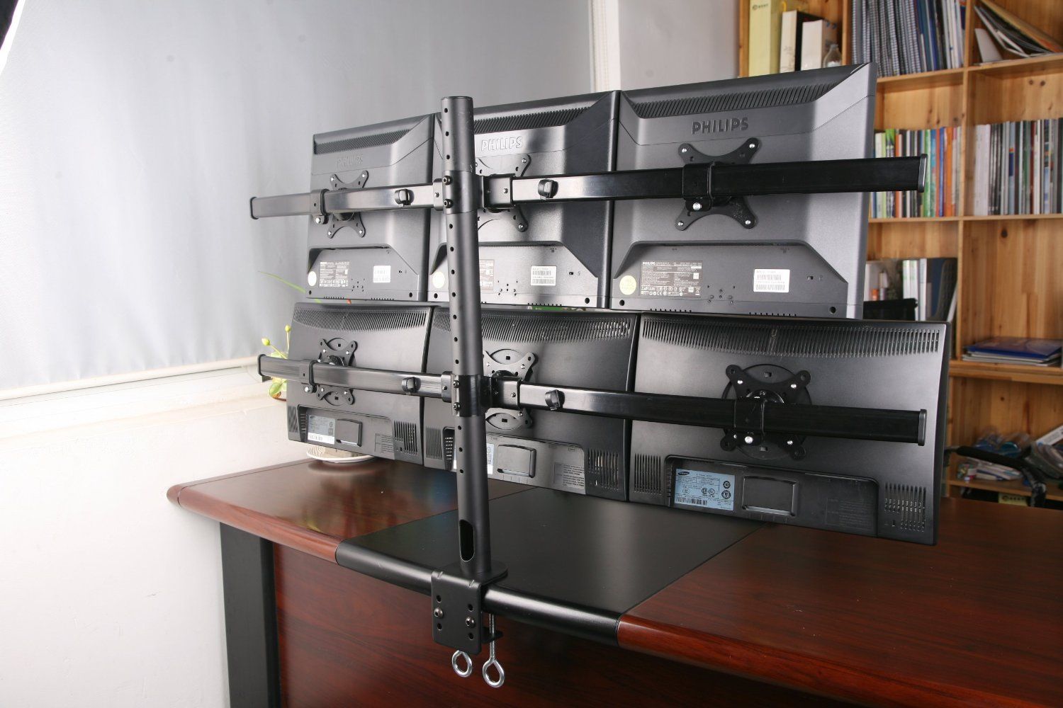

Sample picture from the Amazon site, this isn't my stuff, I just bought this display stand. I have different displays.
I just got one of these in today from Amazon. I can't believe how heavy it is! I think it weighs like 40lbs before even putting any displays on it!
When it's up and all the displays are mounted it's going to be almost 7 feet wide ! I'll feel like I'm sitting at Mission Control !! :D
On the bottom row I'll have my 24" iMac on the left (it's a stand alone, self contained iMac) that I've ordered a VESA adapter for so it can mount like the displays above.
In the bottom center will be 24" display for my Super Mac. It's a massive, high powered beast, the most powerful Mac you can get and then some.
The bottom right will be a matching 24" multi-purpose display that I watch TV on while I work. I have an 8 way HDMI switch so I can watch any of the many HDMI devices I have on it.
Top center will be the 19" screen for my security cameras, it displays 9 cameras at a time in a grid at 24fps smooth, real time and live.
Upper right will be a 24" HDMI TV for watching my Amiko A3. It has three inputs so I can switch it to different sources if I want.
Upper left will be a matching 24" HDMI TV for watching my MicroHD. As it's twin, it has three inputs that I can switch sources.
I'll also have three tablets at hand and a laptop. My workstation will be quite extensive.
Then above all that will be another row of three, small 7" TV screens that I use as spot outputs for my cameras, they cycle through all the cameras on each screen so I don't miss anything.
I can push a button and bring up any camera to any of the small screens if something is going on. With three dogs and many cameras mommy has many eyes.
With the large screens I can bring up any of my Macs or video sources. I can extend the Macs into all the screens at once if I want. Very handy when I'm editing video and doing my photography stuff.
