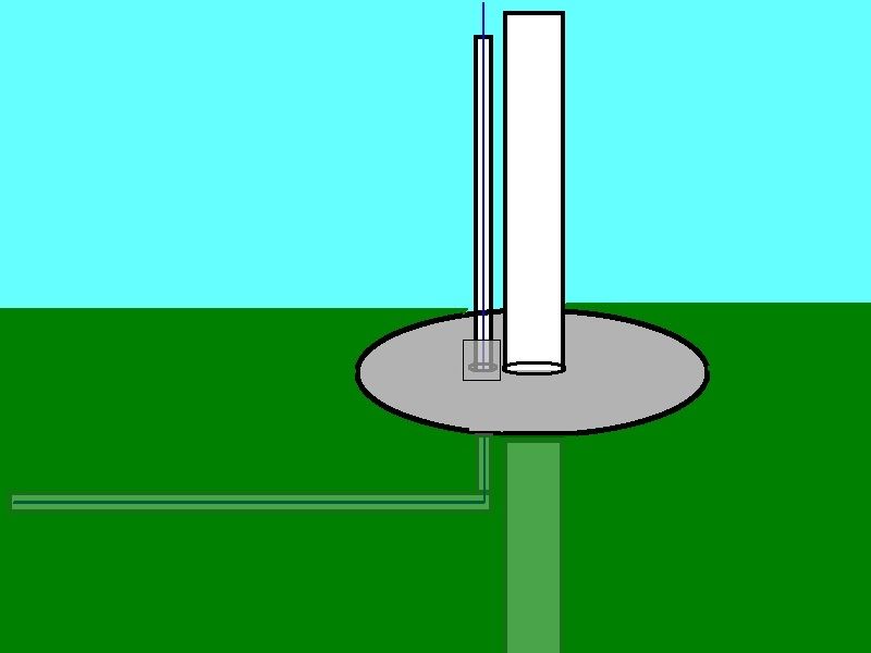

One thing that I looked at is where the first and second floor meet. The first story is brick but the second story is covered in shingles, it's like a French Provincial style I guess. The second story is clad in plywood and that's covered with stylized shingles. There is a cable internet wire coming through the second story wall just above the bricks. I imagine I could do the same thing with the satellite wires then run them through conduit down into a waterproof switch box. From there I want to run conduit to each pole, underground. I want to put the conduit in before the poles are cemented in so that the conduit will run through the cement and come up right next to the pole. That way it will be protected from lawn mowers and weedwhackers.
That's a pretty crude drawing but I never said I'm an artist. :oops: But I figure you get the idea.
One inch conduit running to each dish, buried then poured into the cement so it comes out of the cement right next to the pole.
I would put curved elbows on the conduit rather than 90 degree elbows so the wire would be easy to push/pull through it.
Also, put strings in the conduit before I put it in the ground so I can pull the wire through.
On the tops of each conduit, a couple of curved elbows to it's like a candy cane where water can not get in.
And stuff some wadded up nylon window screen in the ends to keep bugs out.
With one inch there should be enough room to get at least two wires in there if I had to.
Also I plan to put in high quality, shielded wires for the BUD motors. Maybe in separate conduits.
Doing it like this should give me a system with no wires above ground and where they come out of the ground they will be protected from damage.
I'm thinking I should probably put a cement cap around the wire conduit just in case. Or something to armor it from damage, I may continue with the current yard service that takes care of the place now so I want to make it impossible for their helpers to bumble it up and break my conduit & cut my wires.
I have several months to plan this all out so I'm not in a rush to get it done.
I've heard the saying measure twice, cut once. I need to measure 20 times. I really have to plan it out very carefully and do it right the first time. If I plant a pole in the wrong place I've got a BIG problem.
It's a bit stressful trying to figure this out in my head but it will be nice to have it done right and looking professional. What a relief from this haphazard redneck random placement I have going on here.

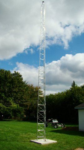

As long as you do not have any HOA restrictions....I would put up a 30 or 40 foot Rohn 25G tower, and attach it to the house, and make sure you put concrete to spec. Then put all of your KU dishes on it above the roof line. Just a thought.
Can't do that. It would look bad considering the neighborhood. I have to abandon my redneck ways and redneck days.
While there is no HOA it's a very nice place and I want to keep up appearances as they say.
I could get away with putting a 30' tower with a really large OTA ATSC antenna, no worries about that. But covering it with dishes, nope.
Besides, the dishes are large and heavy and this is hurricane alley. I want to keep them low to the ground on heavy gauge posts buried deep in excessive amounts of cement.
My goal is to keep as much of it below the fence line as possible. I'm going to have a minimum of 7 dishes and the smallest is one meter.

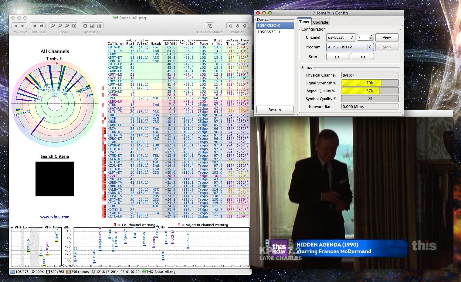

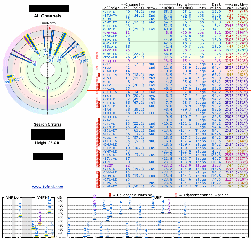

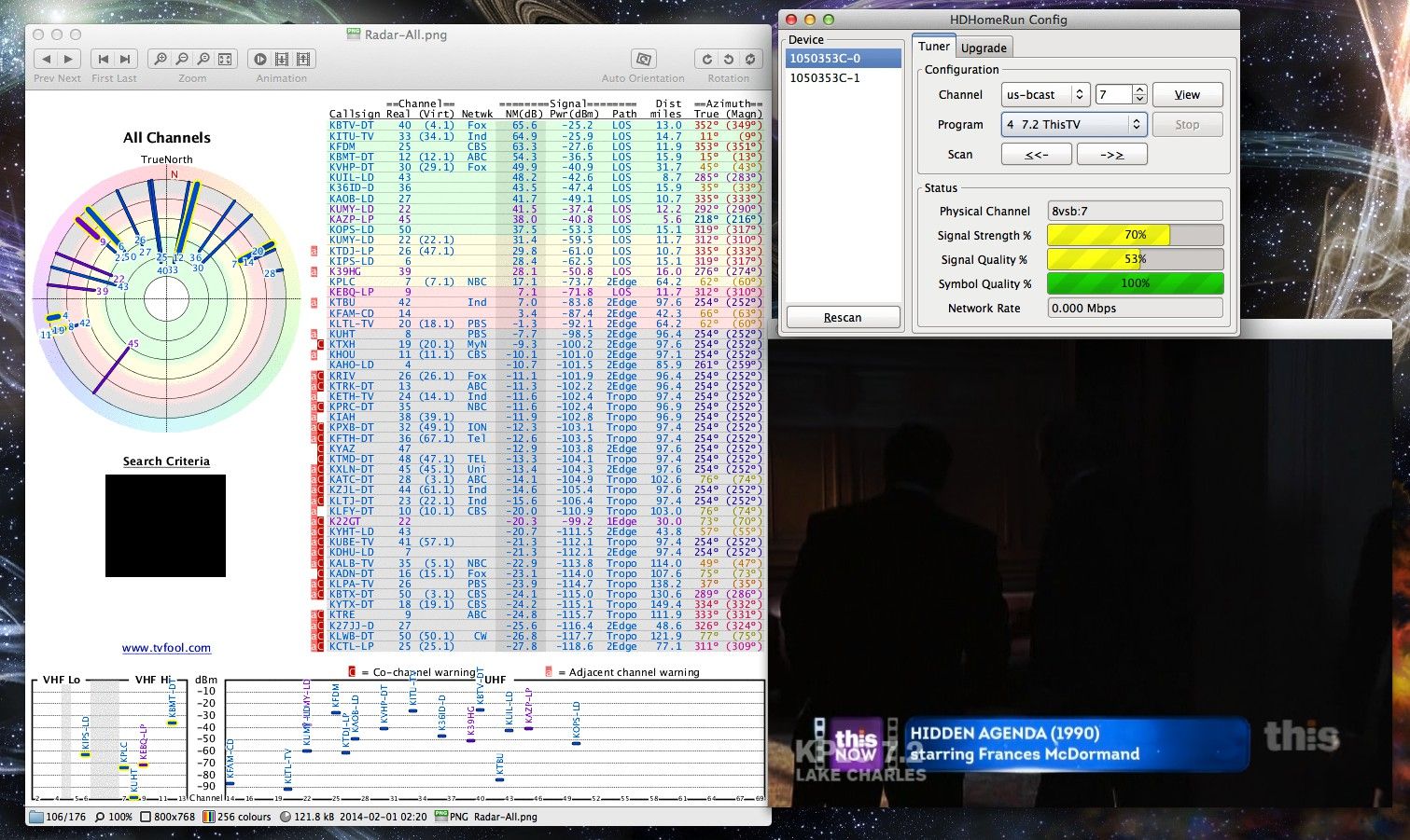

OH NO!!!!!!! WTH?????

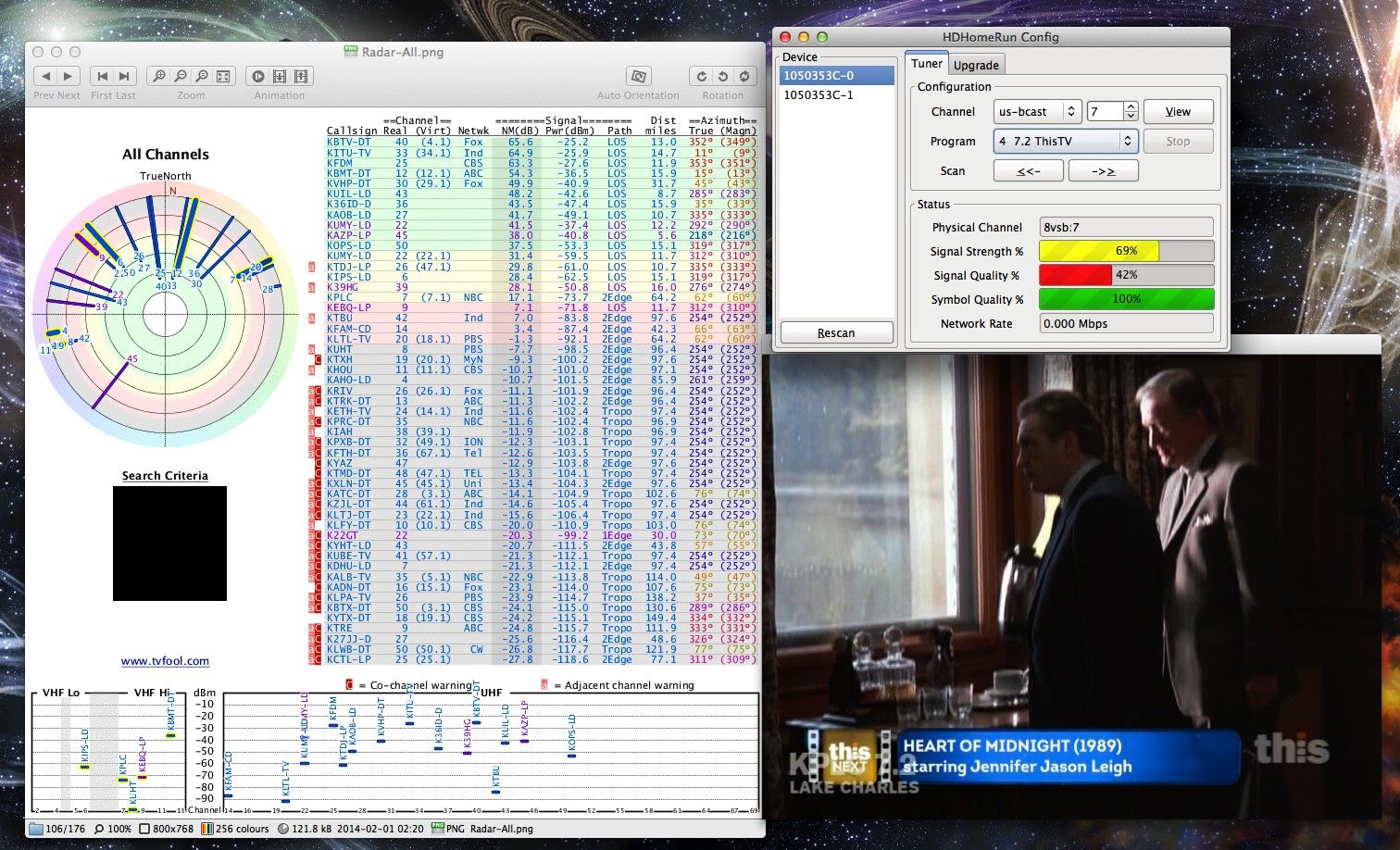

After I read this I jumped over and did a deep scan for ATSC and I found KPLC 7.x channels and they are still airing ThisTV as of this moment.
Maybe they are planning on dropping it?
I did some screen grabs. The signal drops out every few seconds, like a kid playing with a light switch. The picture freezes and pixelates frequently so it's just not viewable.
I see they still have that huge, nasty, eyesore of a watermark on the lower left quarter of the screen. That's just FOUL and immature of them. Like a dog marking it's territory.

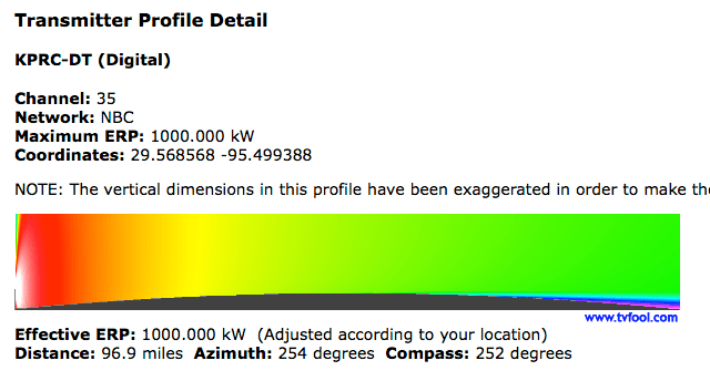

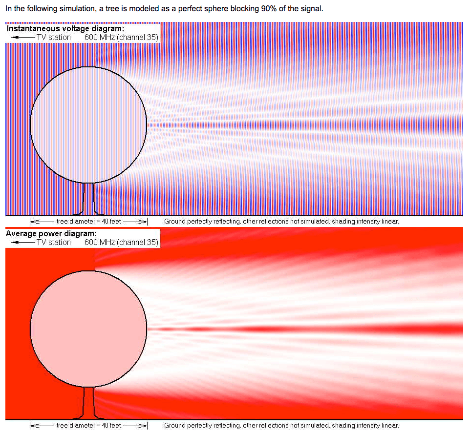

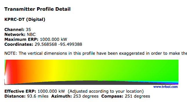

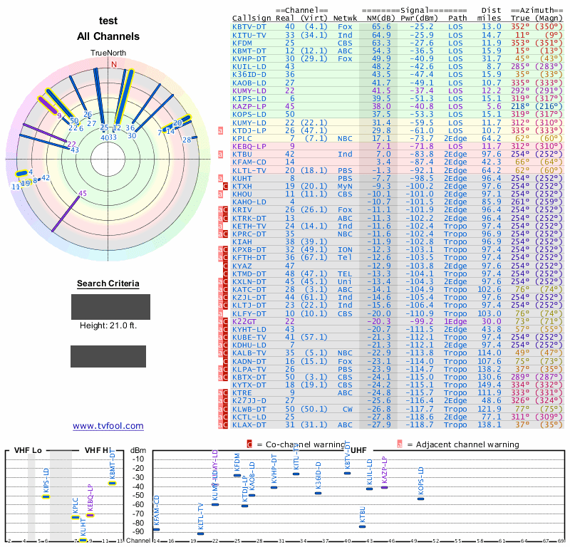

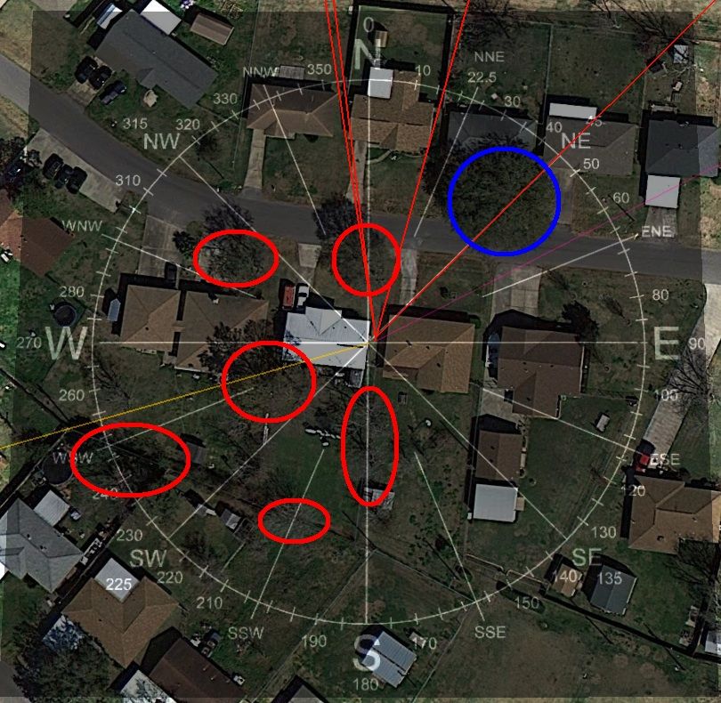

I turned my antenna towards the tower according to the TVfool chart. In the past one of my neighbors had a big oak tree that was in the way but they had it cut down earlier this year so that helps.
But what I really need is a bigger antenna. I have a few mismatched, low budget antennas that are combined into one wire. The VHF antenna my dad gave me was originally sold from Radio Shack as an FM radio antenna. The box was clearly marked FM radio antenna and TV was not printed on it anywhere. But my dad told me it would work anyway. And it does, more or less. It wouldn't pick up UHF so I had to put a separate antenna for that then a special signal combiner. I also put a powered amplifier on it too. The amplifier made a HUGE difference..
But the bottom line is, I really need a large, proper antenna and not this cluster of stuff I've rigged up from mismatched stuff.

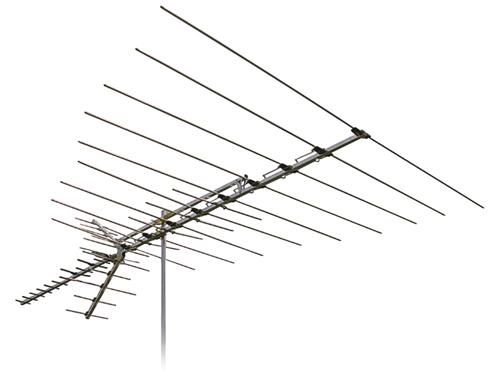

As for a new antenna, this is one that I'm looking at. http://www.solidsignal.com/pview.as...nna-(HD8200XL)&c=TV Antennas&sku=700112818356
If I can find an even better one, I'll definitely consider it. I am open to suggestions for sure. I don't mind spending the money to get the best.

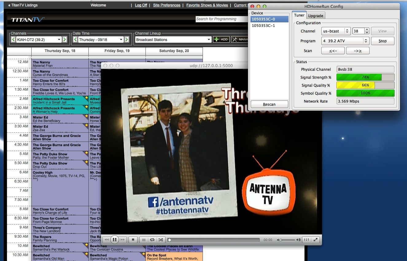

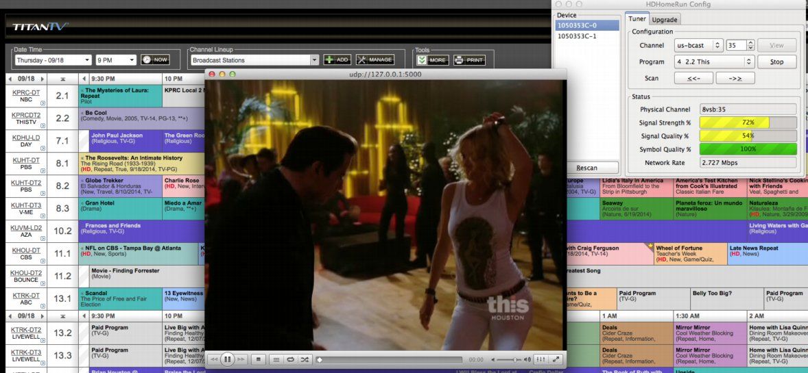

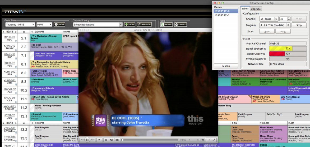

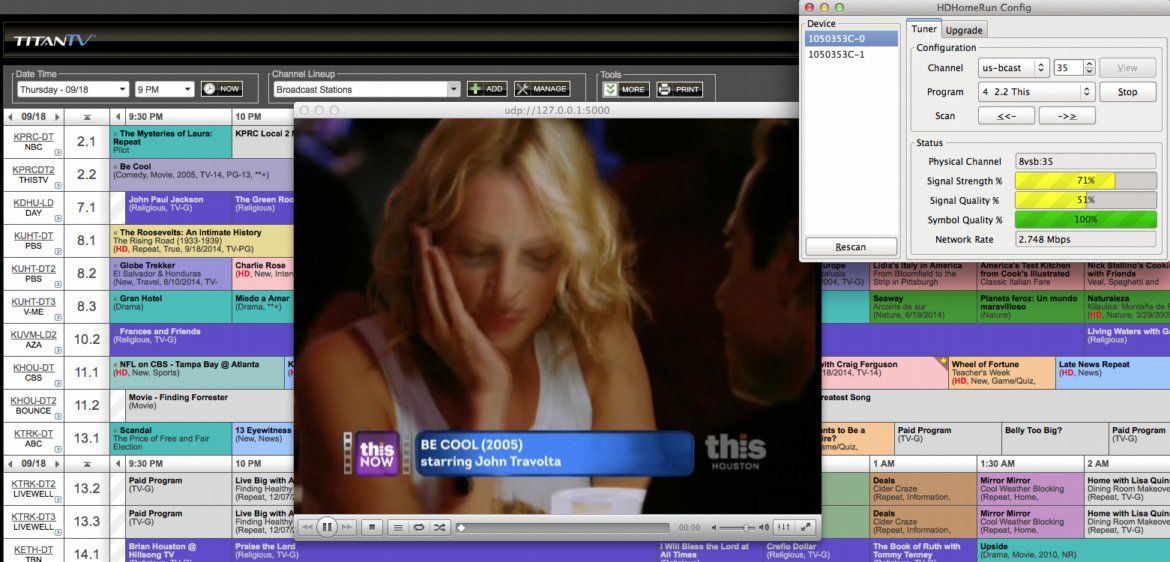

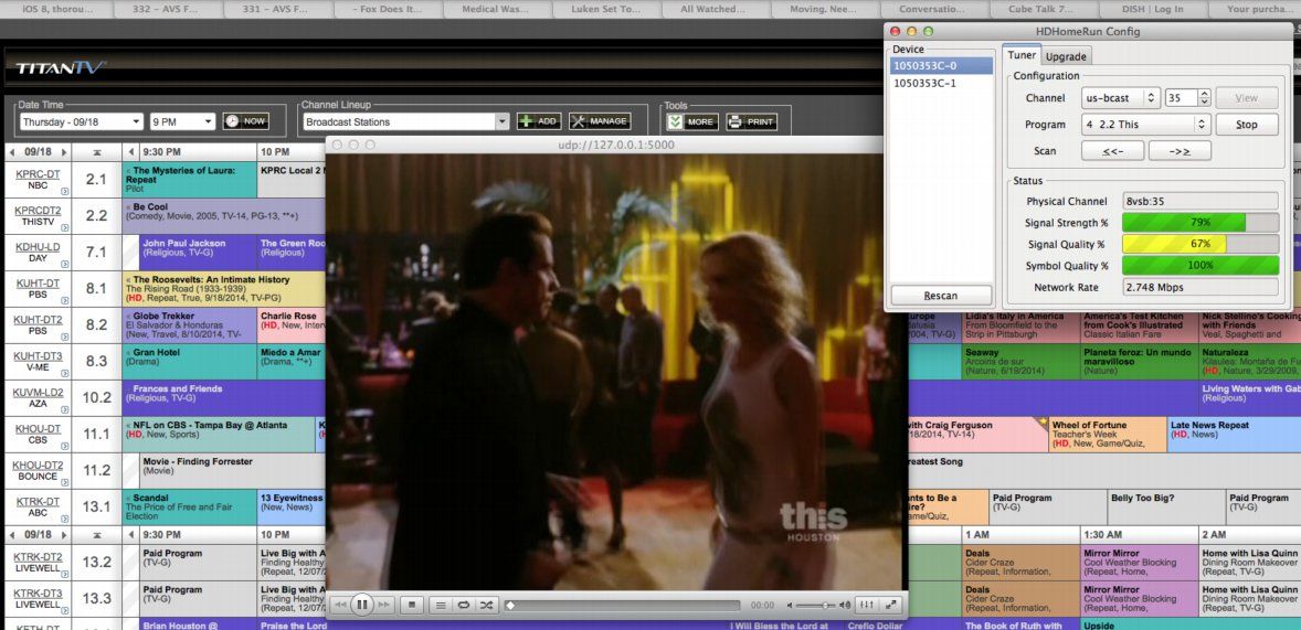

Last night I was picking up a lot of stuff from Houston, here at my house with my sketchy antenna system.
I could pick up Antenna TV but it's unreliable. Also I was able to get ThisTV from Houston, also unreliably.
Most of the stations in Houston were coming in but none reliably enough to be watchable. Lots of pixelations, lots of long freezes..
I am certain that with a better antenna I could get Houston pretty reliably, considering that I can sort of get it with my shabby FM radio antenna.
At the new place I'm pretty sure the antenna there will be much higher than mine and no trees or refineries in the way so line of sight will be much better.
I'm hoping that I'll have really good luck with OTA there. I plan to spend the money to get first rate, top quality stuff.

I think once I get a proper antenna I'll be able to get it solid and reliably from Houston. According to TV Fool, I'm 96 miles from KPRC's antenna.
As you can see here, the signal jumps all over the place. It's very flakey, I just can't use it as is.
I don't know how to interpret this pretty little graphic. I saw in the chart above that KPRC is listed as "tropo" which I don't know what that means exactly
but I'm thinking it has something to do with the troposphere. That's my best guess and the limit of my knowledge.
I just hope that a mongo-giant antenna will overcome this problem. It seems like I'm almost there but not quite..
So close, but so far......
I put in the address of my new house and got some different info. Almost all of the Houston channels went from "tropo" to "2Edge" which is also a term I don't know about.
Moving puts me about three miles east of here, a little closer to Houston.
I found a compass thing in google images, downloaded it then imported it into google earth as an overlay.
I placed it over my house with the center of it dead on where my antenna is. Then I set the transparency so I can see through it.
The red circles are all BIG oak trees. The red lines are most of the local OTA transmit towers. Two of them are blocked by an oak tree in my front yard but the signal is strong enough along with my amplifier to mostly get through the tree, it's usually not a problem. The blue circle is a huge oak tree that my neighbor recently cut down this summer that was causing me grief with KVHP but is no longer a problem for me.
The yellow line is to KPRC and KIAH (This and Antenna) which are both on the same tower it seems. And of course there is a huge oak tree smack dead in the way, right in my backyard.
The flippin trunk of the tree is dead in the way... :mad:

http://www.hdtvprimer.com/ANTENNAS/siting.html
Well I found this about trees. With all these trees so close to my antenna it's amazing I get any TV at all.

Anyway.. I only have to suffer the trees a few more months. Where I'm moving to, there are no trees in the way.
There's an existing antenna but I'll probably take it down and move it to the other corner of the house so it's further away from the power lines (it's scary, scary close to a power line!) and in the process, make it taller.
Most likely, I'll end up putting in a 40 foot tower and be done with the nonsense.
http://www.palcoelectronics.com/pe300.aspx
It says call for pricing but they have taller towers listed around $1,000 so I'm figuring this would be less than that.
Well worth it to me. The trick would be finding a place where it could tip down.
And rigging some sort of pulley system because this chick ain't climbing 40 feet up in the air, no way, no how!
Biggest antenna, best rotor, no more nonsense.. :D
I'm pretty big on the rig something up to work thing. Having climbed many towers and used commercially build tilts I would suggest that rigging is not the word I would use. I don't know how comfortable I would be with a homebrew tower that close to my house. If it were in the middle of a field twice the distance as it was high from my house and power lines sure thing. Wing it. I'd be afraid of the liability living in a neighborhood. Don't get me wrong, a properly installed tilt over is a beautiful thing. I liked anything I didn't have to climb. I remember we had one monopole that was a crank up and tilt. We used it for an ABB100 setup in a delta for the HF radio net that was part of the statewide EMCOMM for the PA Guard. I can't remember the manufacturer right now. Could be more expensive than what you are looking at. Not sure. I didn't work too much with anything that small and it has been a while since I did that work. From what I have seen on HRO it looks like smaller tilts go for around 3k+.
