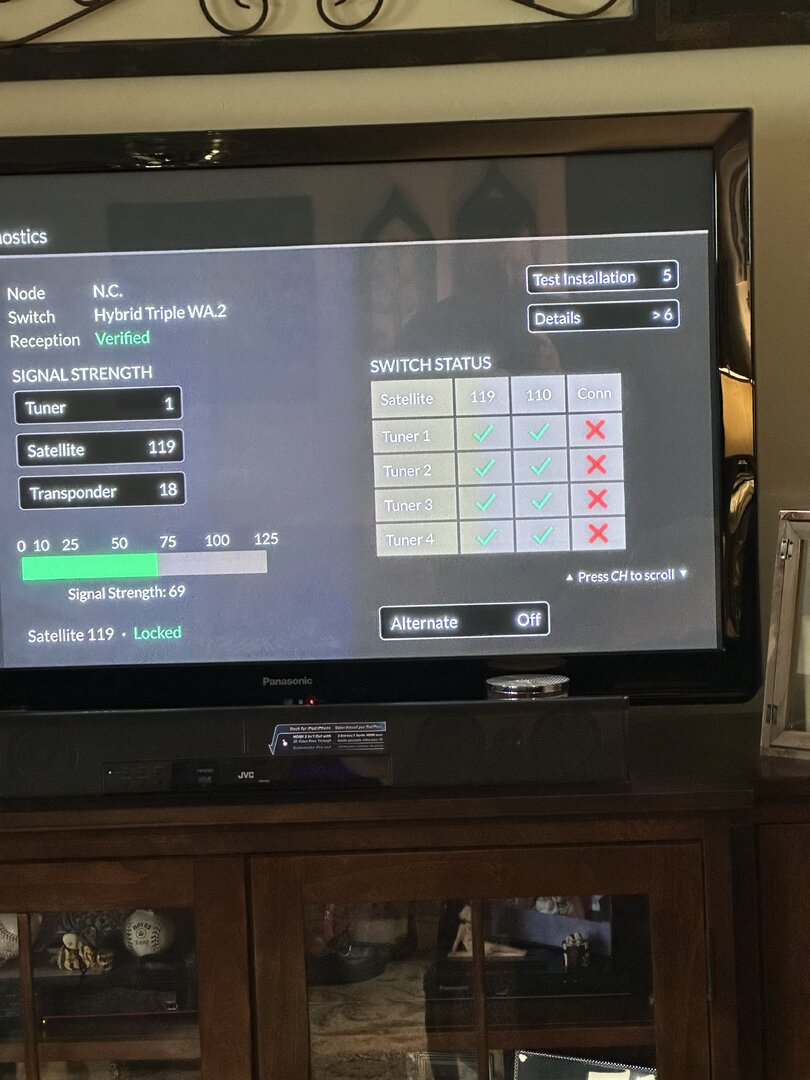

Do you have PTAT enabled? I have hit that 60% issue before during a check status test. After a lot of troubleshooting, discovered it was because PTAT was recording. Even if you disable PTAT now it still will not work because PTAT is already doing its thing. Try performing a check status in the morning and see how goes it, unless you already have PTAT not enabled.
Can you try a check switch again after you are in PTAT time and see if it works or gets hung up at 60%?I'm not yet in Prime Time. I just did a check switch and I see 119 and 110 with green check marks and Connected (where 129 was) with red Xs. I saw the same before the check.
I'll have to wait for about 1 1\2 hours. Watching something right now.Can you try a check switch again after you are in PTAT time and see if it works or gets hung up at 60%?
OK, thanks.I'll have to wait for about 1 1\2 hours. Watching something right now.
On a job now and it's showing red x where 129 wasAre you still seeing this?
Yes everything working perfectlyThanks - just got confirmation its a UI issue only...are all the channels working?
Thank you for confirmingYes everything working perfectly
Yep, no more disappointing SD signals when the best I can get is a 110/119 shot through a small gap in the trees at a campsite.It was definitely very difficult and pain for installers getting signal from 129 lol. Good news is aiming for 110 and 119 sats are a lot easier to manage.
That looks normal to me. The interface would look the same if you were missing 129 pre-shutdown, like if your skew was off or something.On a job now and it's showing red x where 129 was
I can confirm that I also have the red X "Conn" column. But as other said, everything else works correctly.Thanks - just got confirmation its a UI issue only...are all the channels working?
That's what I am seeing on my hopper 3 that I still have hooked up to the satellite. I ran a check switch and reboot and it still shows it.On a job now and it's showing red x where 129 was
