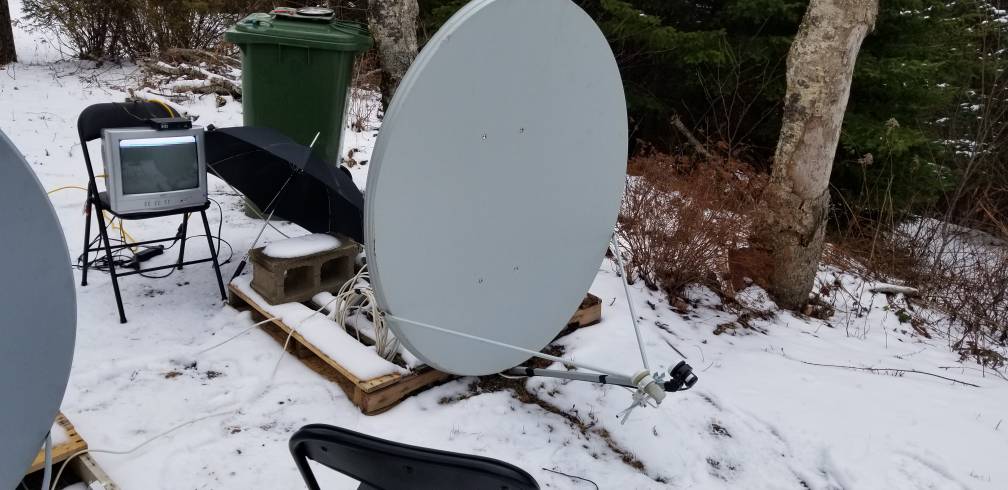

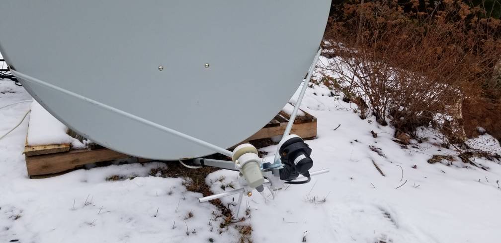

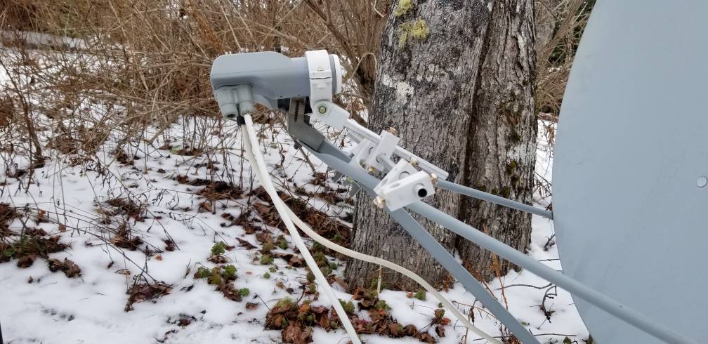

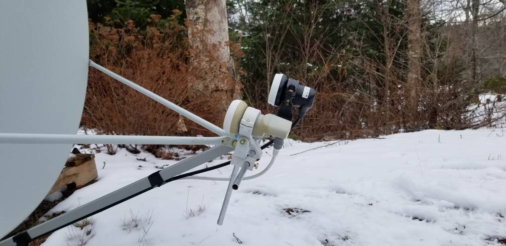

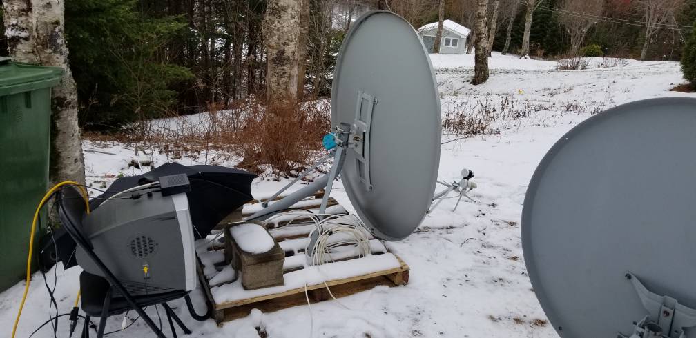

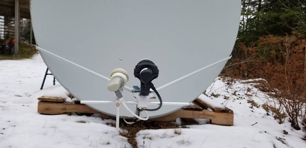

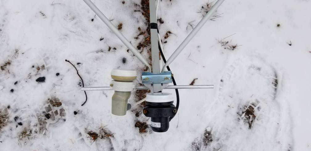

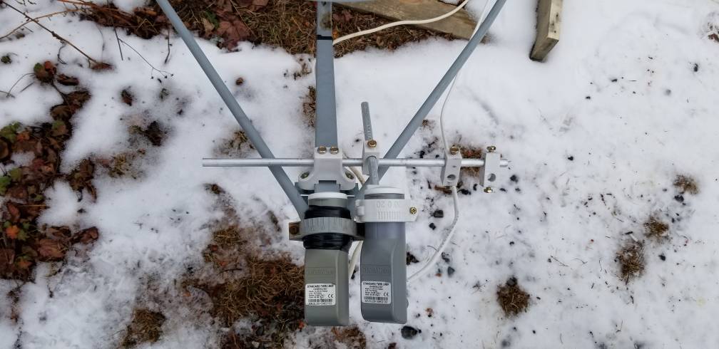

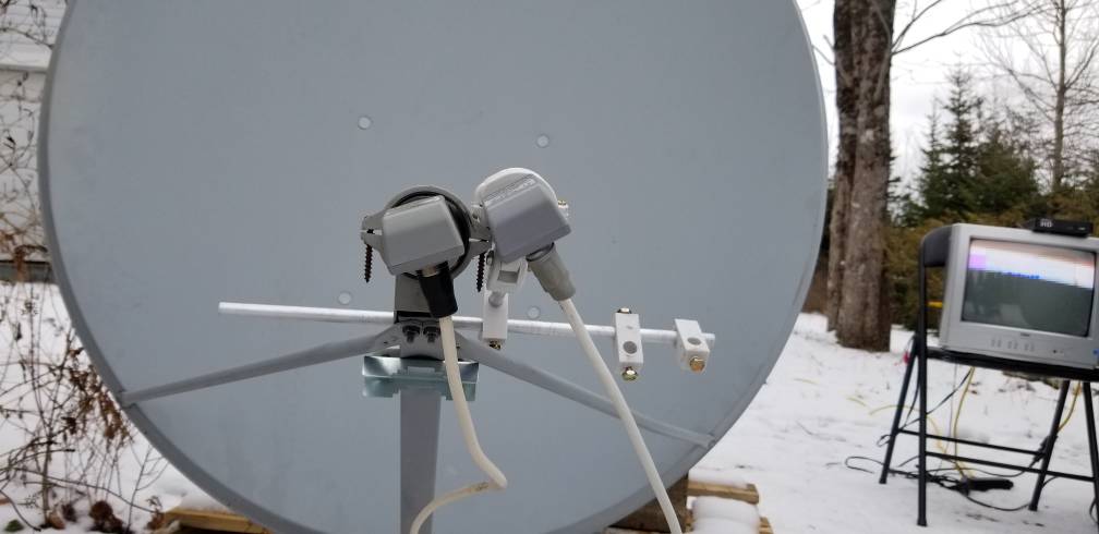

Since it was a balmy 35 F degrees today and sunny (even though it's the second shortest day of the year), I installed a couple multi-LNB holders. So far, I have LNBs installed for 87W and 91W on my 1-metre dish and 97W and 103W on my 1.2-metre dish. I like this holder design since it allows precise placement of the LNB at the sweet spot wherever that happens to be. Results are good. I think I am receiving the same SQ on the offset LNBs as I do when the dishes are centred on that particular satellite. I will continue to add more LNBs as weather permits.

Anybody know the dish?
