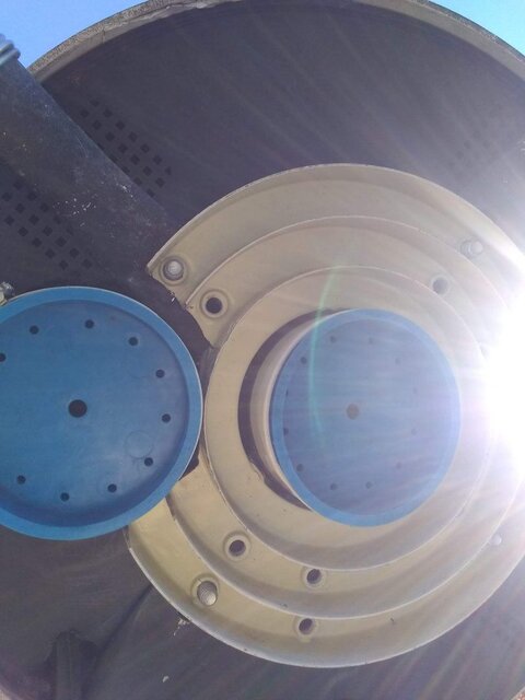

Not exactly on topic, but here's a pic of Mama's 55W/58W 10ft BUD lnbf's. Photo looking up from the bottom. The 58W lnbf is on the East side. Had to rotate the 58W C2-Pll 180 degrees so that the heat sinks didn't hit each other to get them that close.
Signal strength dropped slightly after cutting the scaler and adding the second lnbf... but not enough to lose any desired signals.

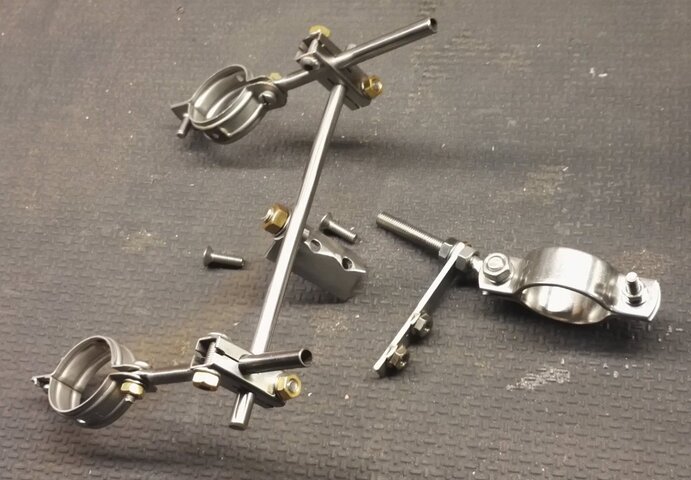

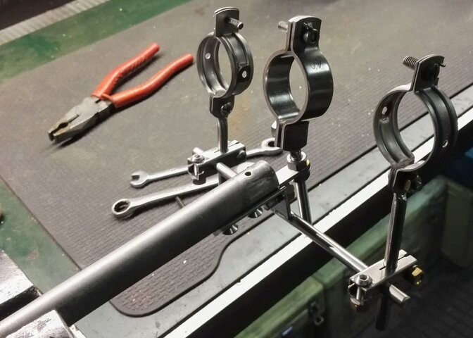

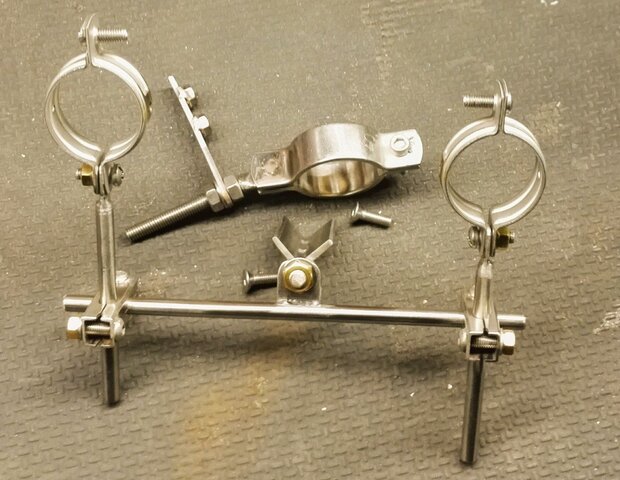

I was trying to make something universal and durable another day. Came up with such a construction. All INOX made and can be installed on any offset antenna (round or square feedarm). However, I do not like multifeeds, they steal signal.... unless they are installed on multi-focus antenna. IMG_20190221_213655 (Large).jpg IMG_20190221_213801 (Large).jpg IMG_20190221_213818 (Large).jpg IMG_20190221_213928 (Large).jpg
