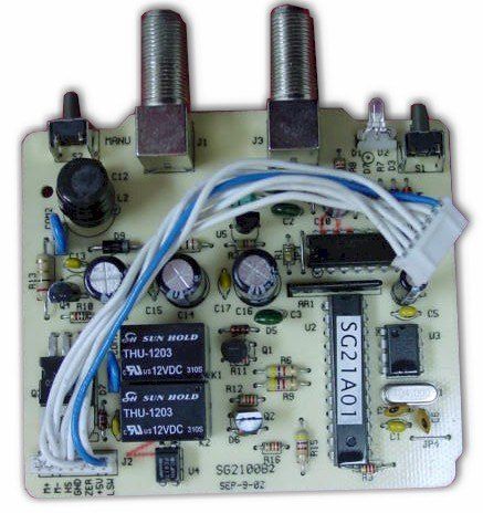

Well I had some free time last night, it was nice out, so I thought I would try to point my G10 Primestar to 30w. YES! It works with a 60%+ SIGNAL! So, I run some new lines to the Invacom on my motorized system, and hook my second receiver to the 2nd set of outputs, bury the line, etc. OOPS, cut a line to the motor - no biggie, I redo the line go inside, hook up receiver - nothing. Nothing from the motorized, nothing from the primestar dish. Ok, maybe I hooked up the switch wrong. I check the tv in the bedroom - it works fine, so the Invacom on the motorized is not the probl. Mess around with it for awhile, gave up due to darkness.
THis am, I go out with the Fortec receiver, and hook directly to the motor - no power to the motor.....so, I find that the connectors will not tighten down...I fear that they are broke. I take down the motor and dish and tak the motor apart - yep, BOTH LNB abd RECEIVER connectors have broke from the circuit board. Flimsy design, but I obvisously over-tightened them. So, I re-aim my Primestar to G10, throw another lnb next to it - boom White Springs. Re run some cable and back up and running - now to decide if I leave it and gi up on a motor or get a new motor. 99% of the time we watch G10.

That's terrible about them breaking off like that. I have read here where some others had a similar problem.
This should be a caution to all of us not to over tighten things.
I tell that to my computer clients who like to tighten down the VGA connector to the back of the computer. I usually tell them, it isn't a head bolt, it just needs to be snug.
Fred
I'd always read to tighten LNBs and switches only with the fingers - don't use any tools.
By looking at this picture, I can see why.
I wonder if the board was meant to be installed with some internal jam nuts and lock-tite or something else to make it more twist-resistant?
Sometimes, connectors are milled off on one side of their threaded portion, and stuck through a "D" shaped hole, so they can't turn.

Yep... I'm a victim of sloppily designed stuff to. My first sg2100 stopped working and had to be replaced many months ago. I don't think mine was due to overtightening of the coax. Instead I think it was due to manually hand tweaking dish too much when it was attached to motor, which somehow cause the bolt connected to motor's arm to loosen too much which caused some issues. I didn't know what the heck I was doing, and think trying to tweak to find the perfect sweet spot caused me to loosen the motor arm enough that it pulled too far when you moved motor a certain direction - which led it to hit right on when moving one way (can't remember if it was east or west) and be off a degree or two going the other way.. one day, I tried to move motor from g10r and just got a no signal message and thought my world was crushed... later, I tried some tests on it and the broken motor wouldn't even move at all and no light came on.
