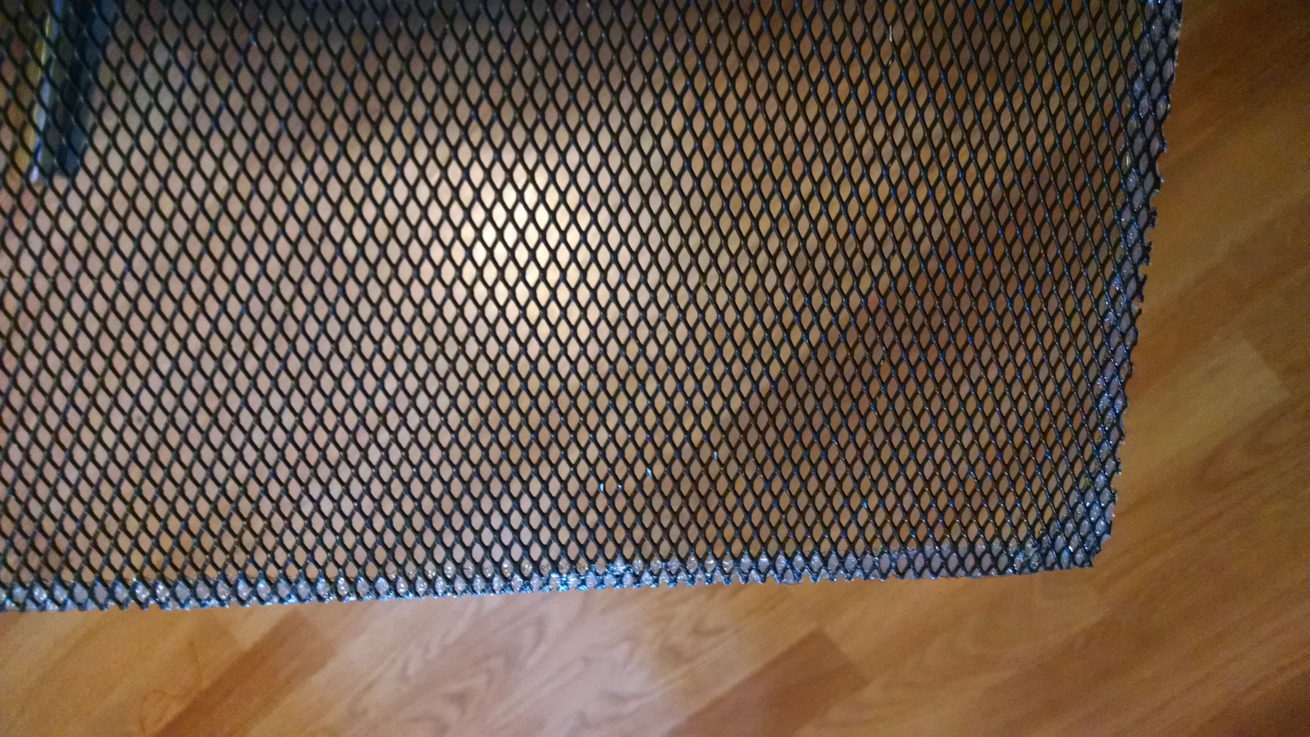

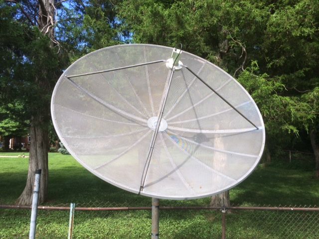

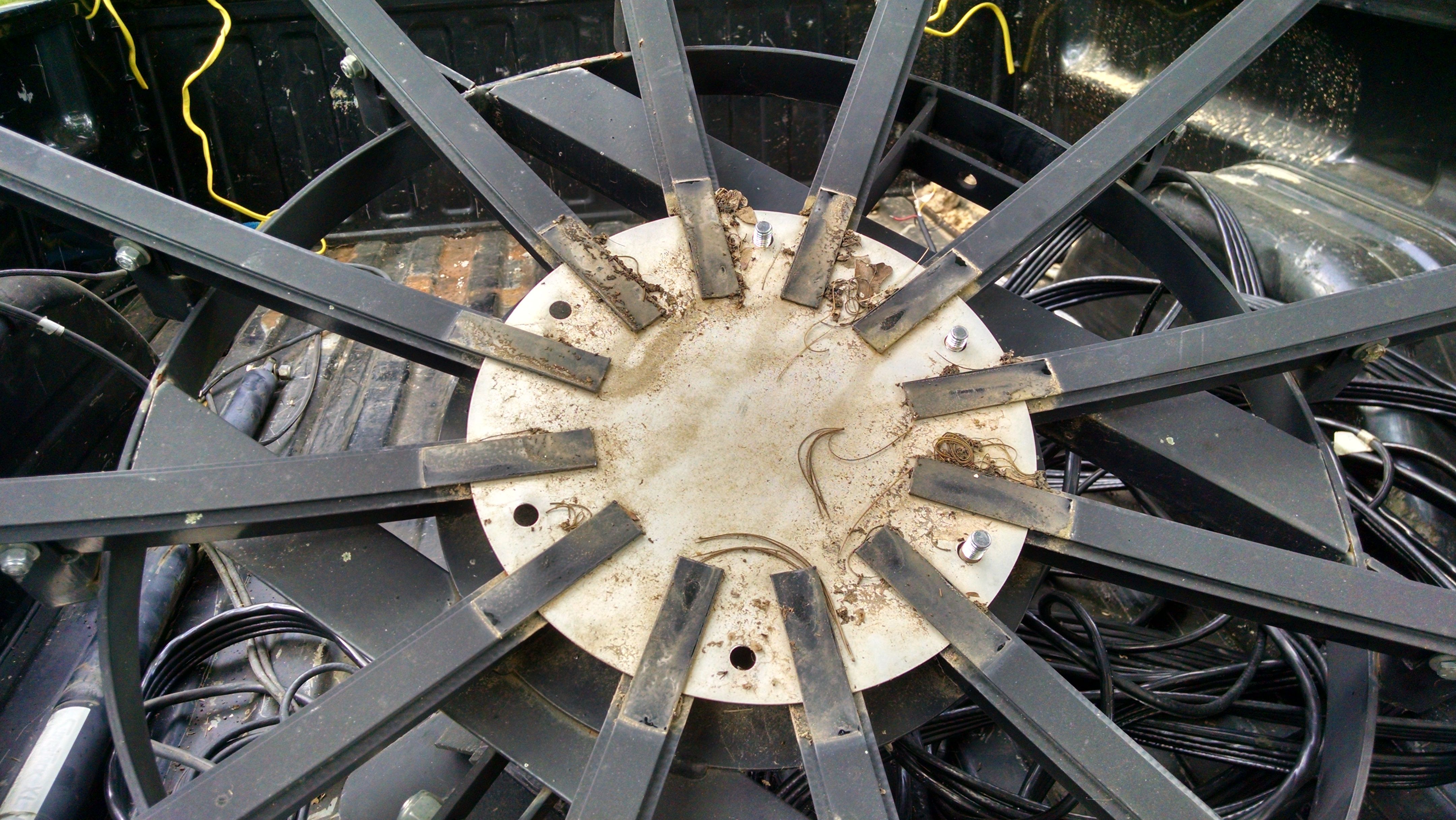

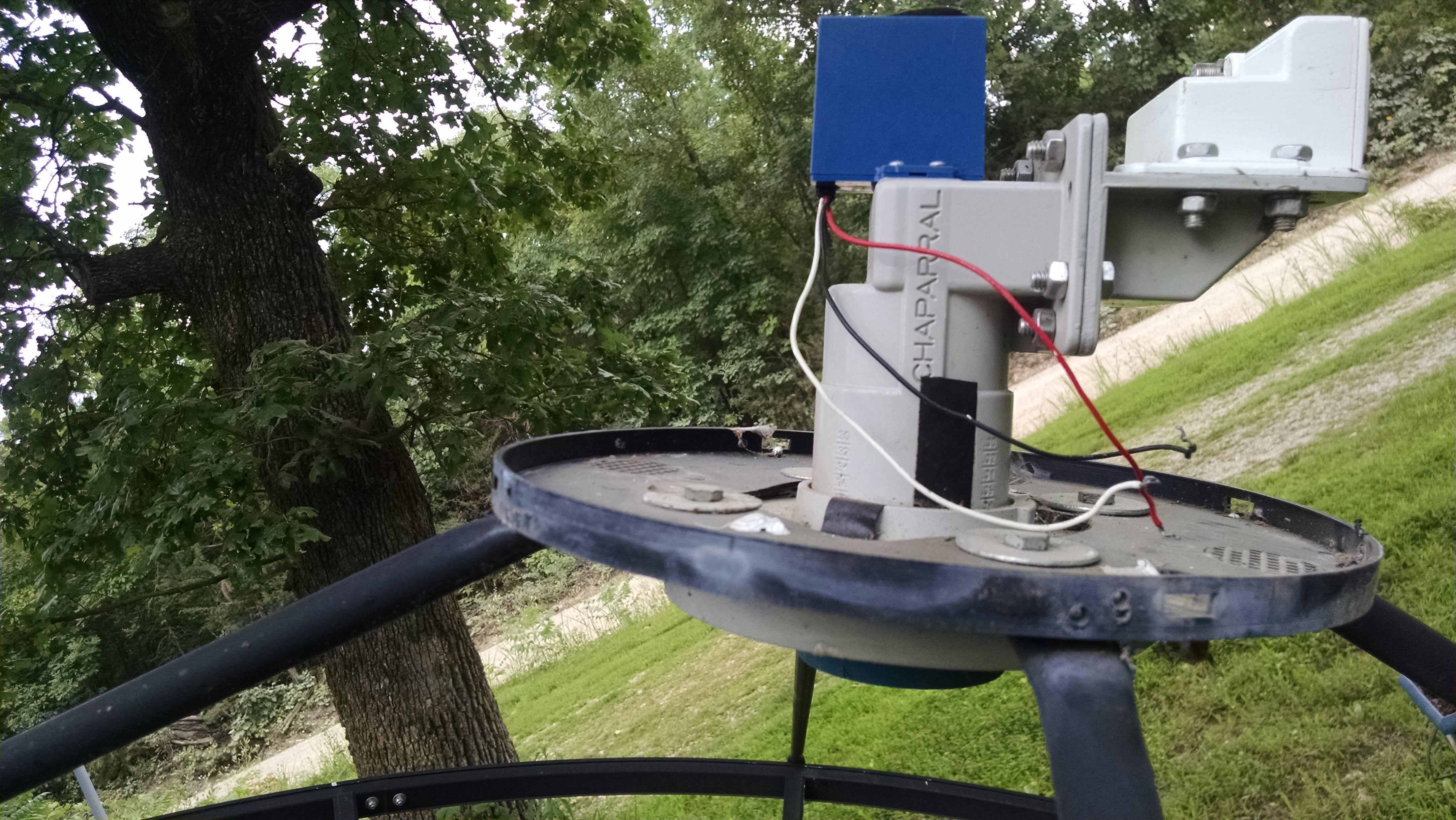

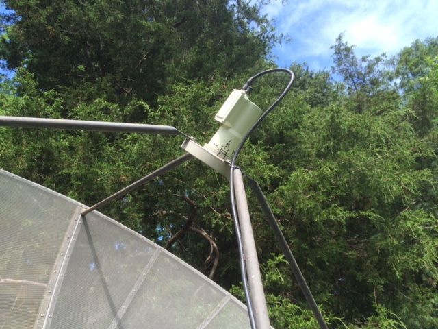

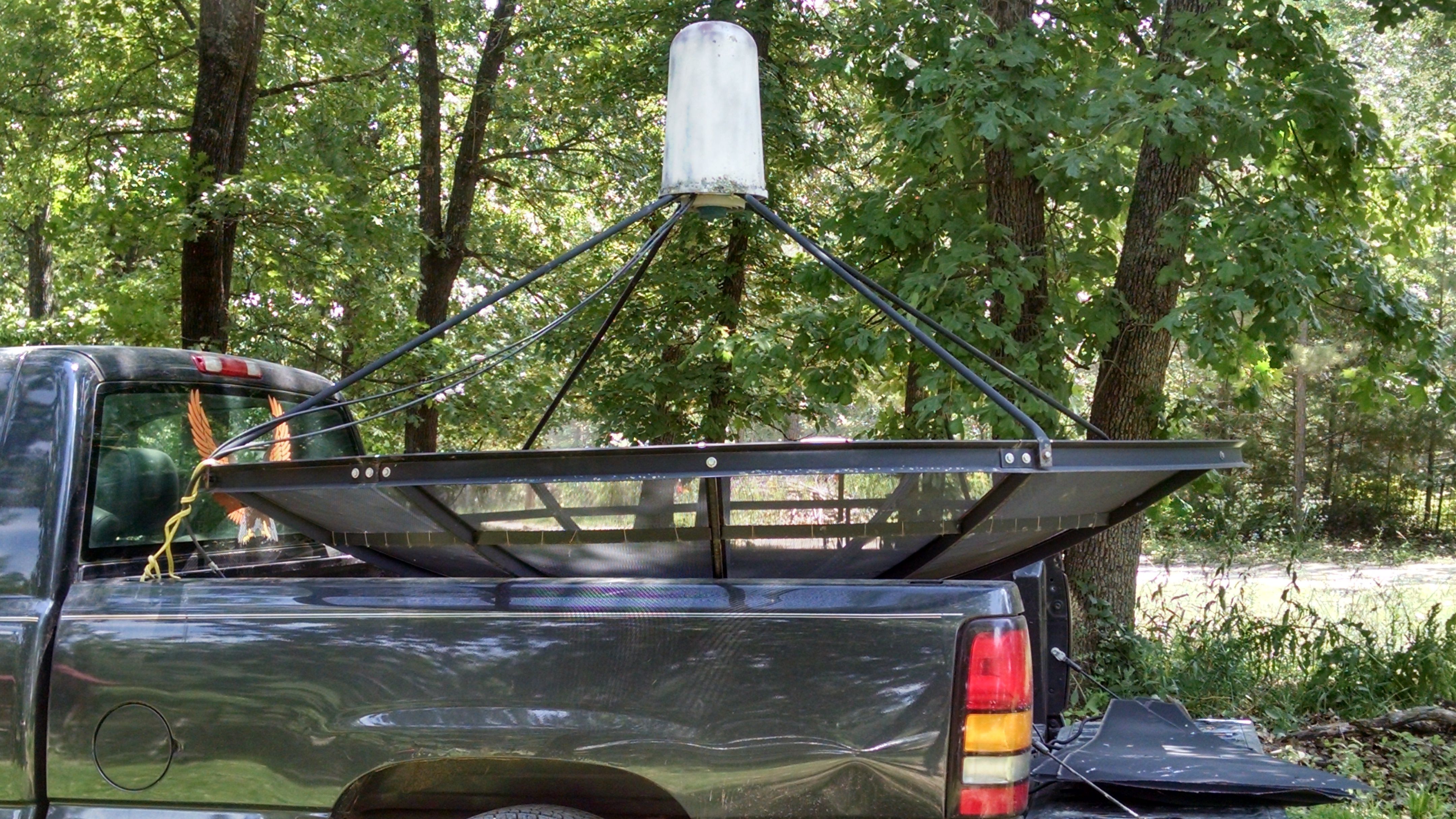

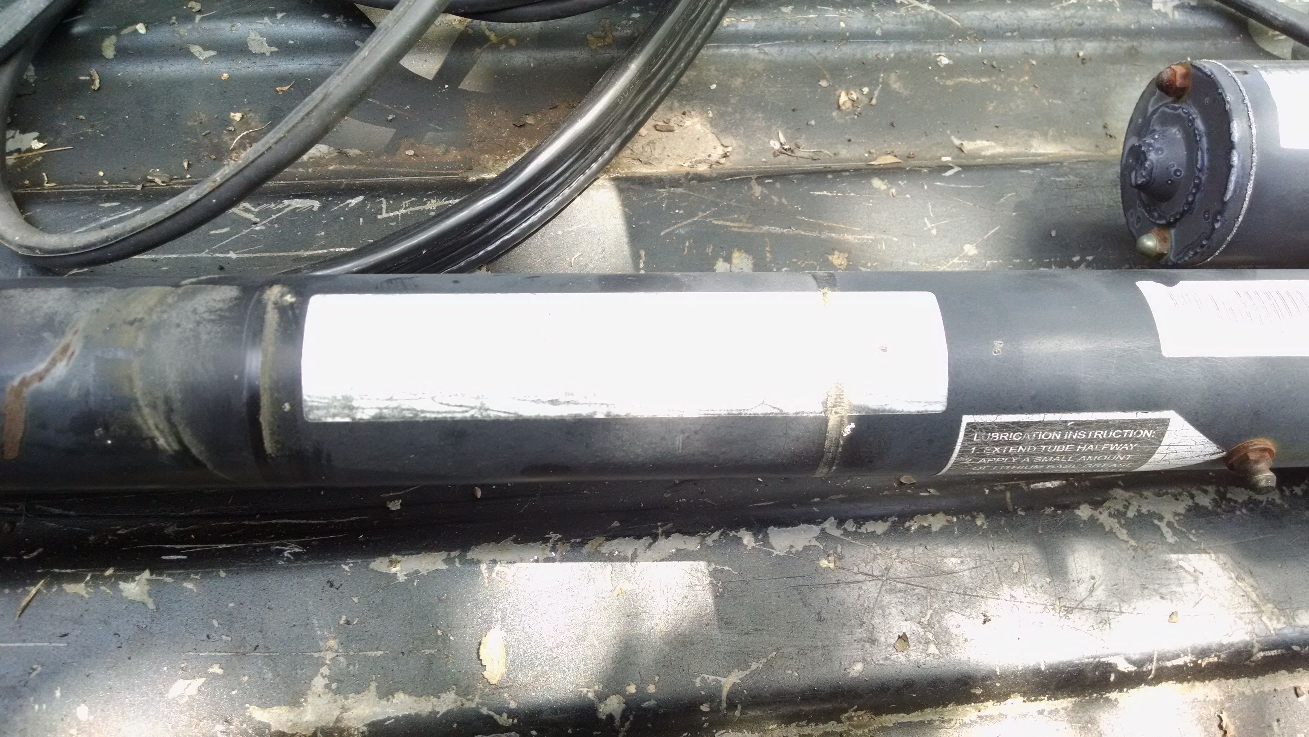

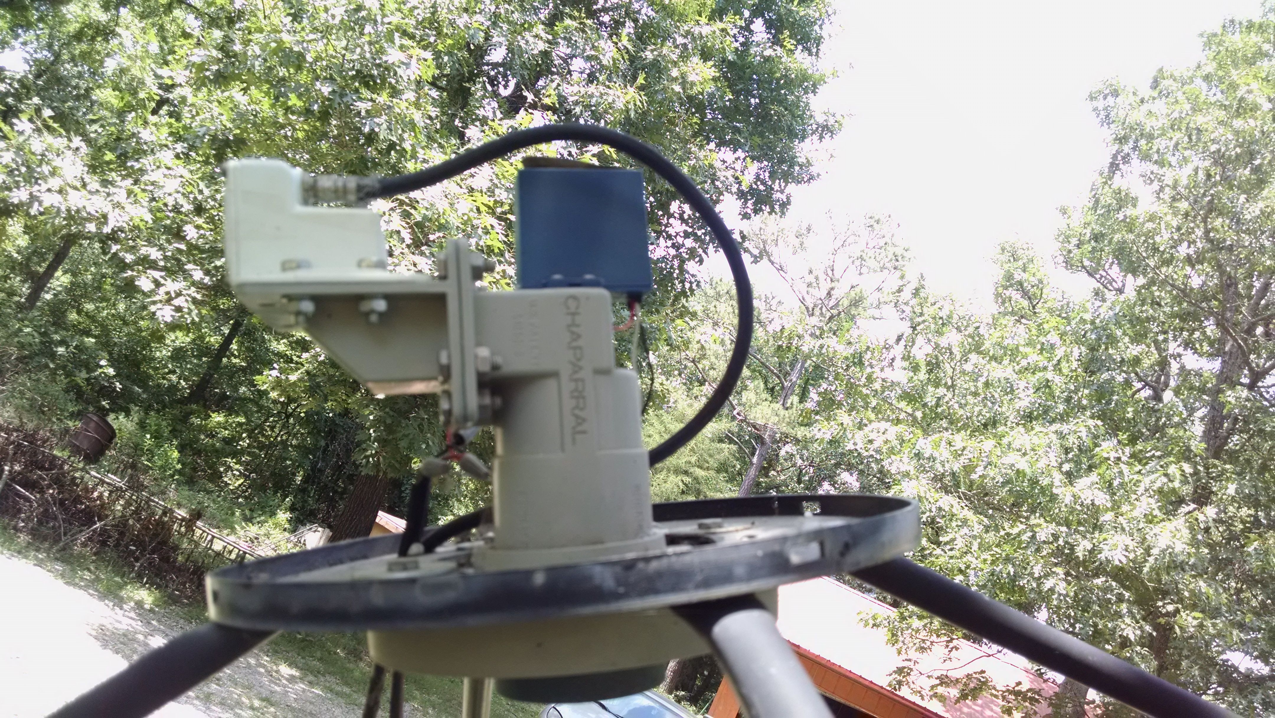

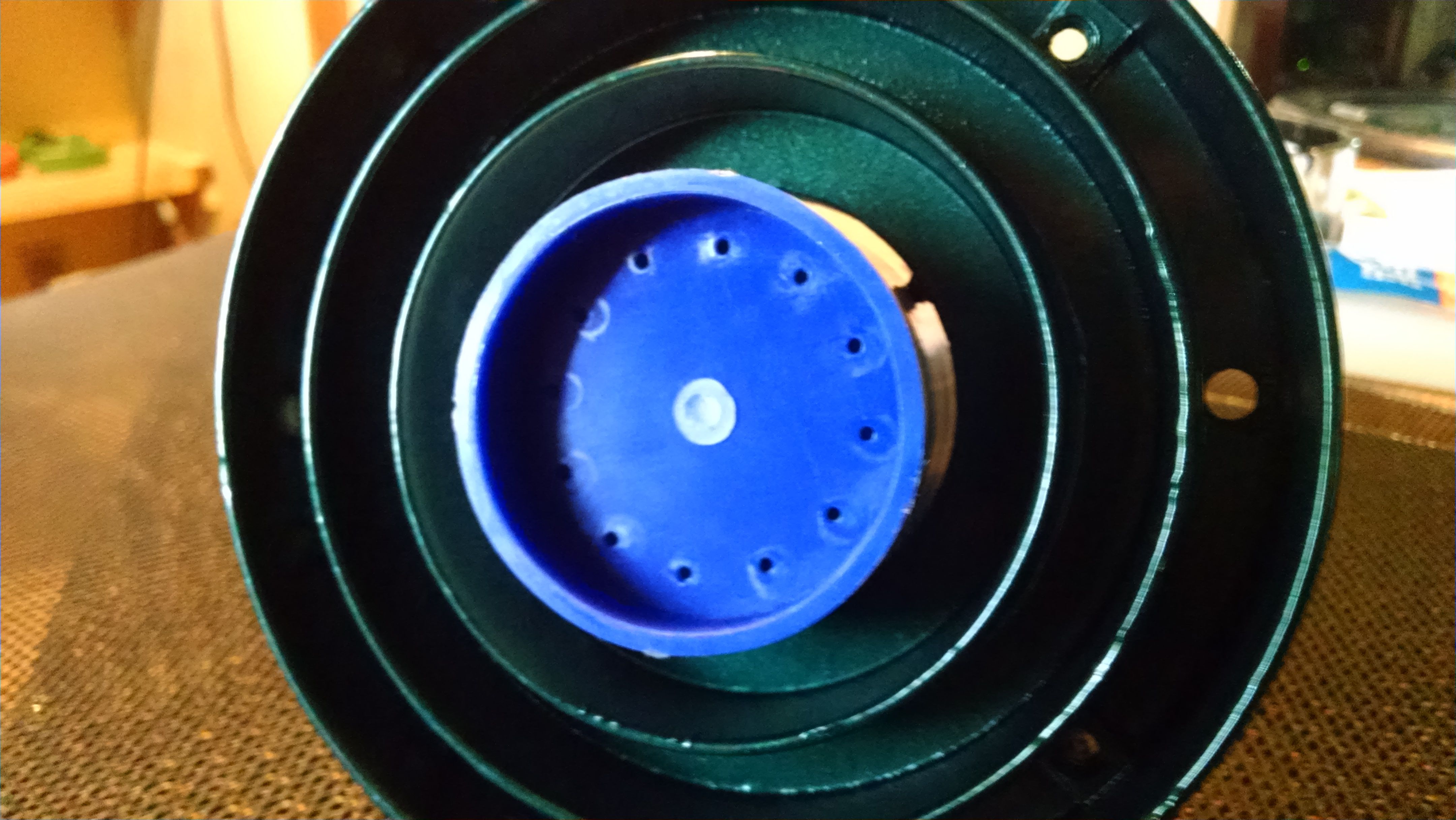

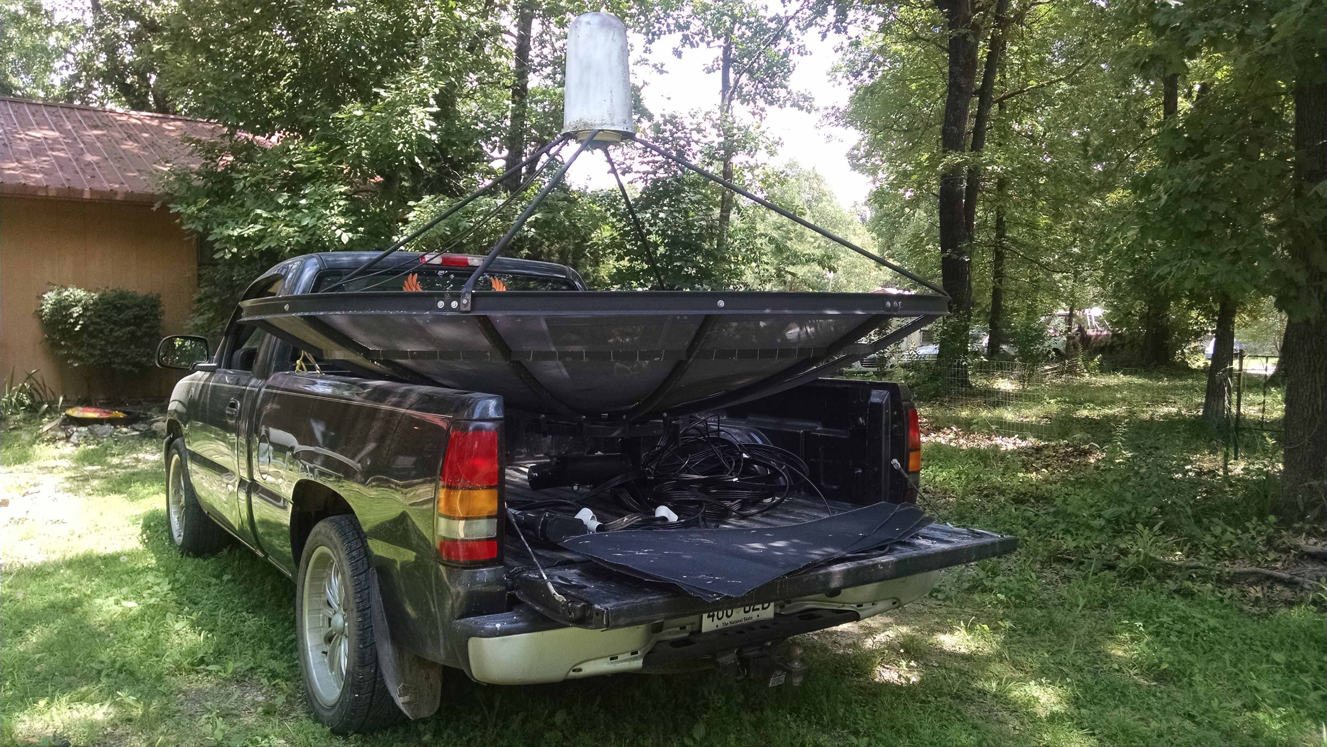

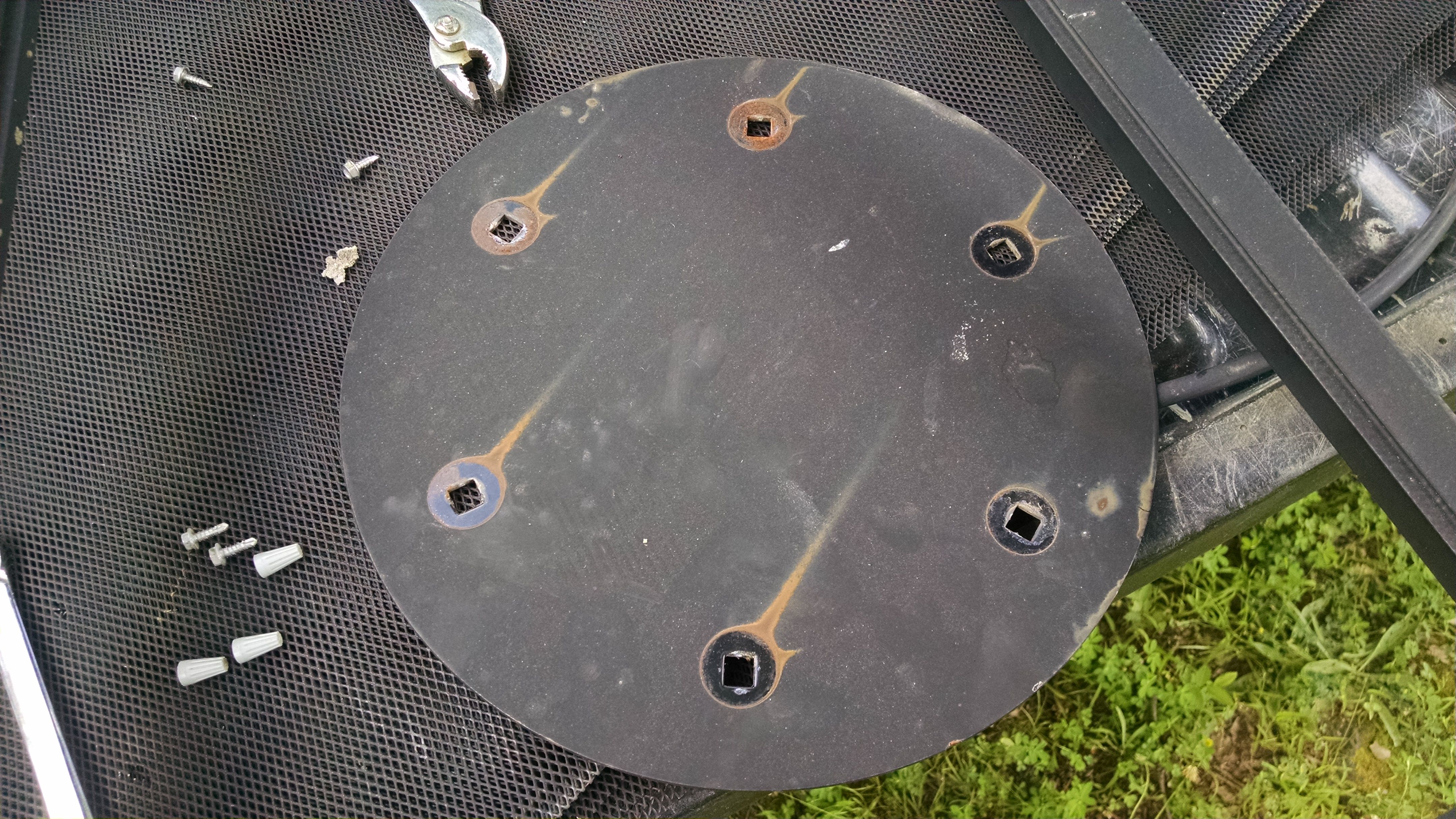

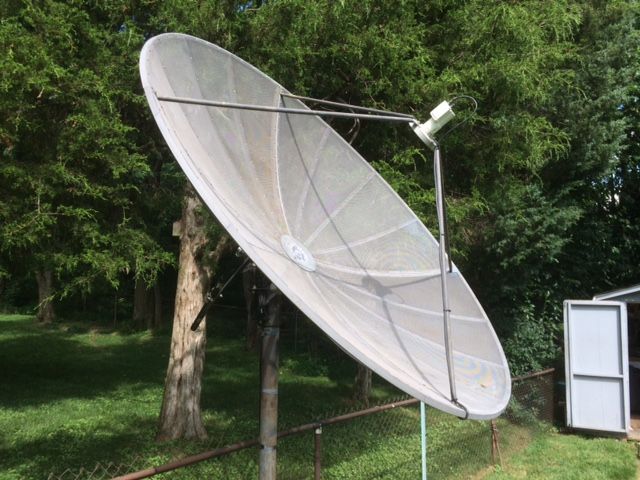

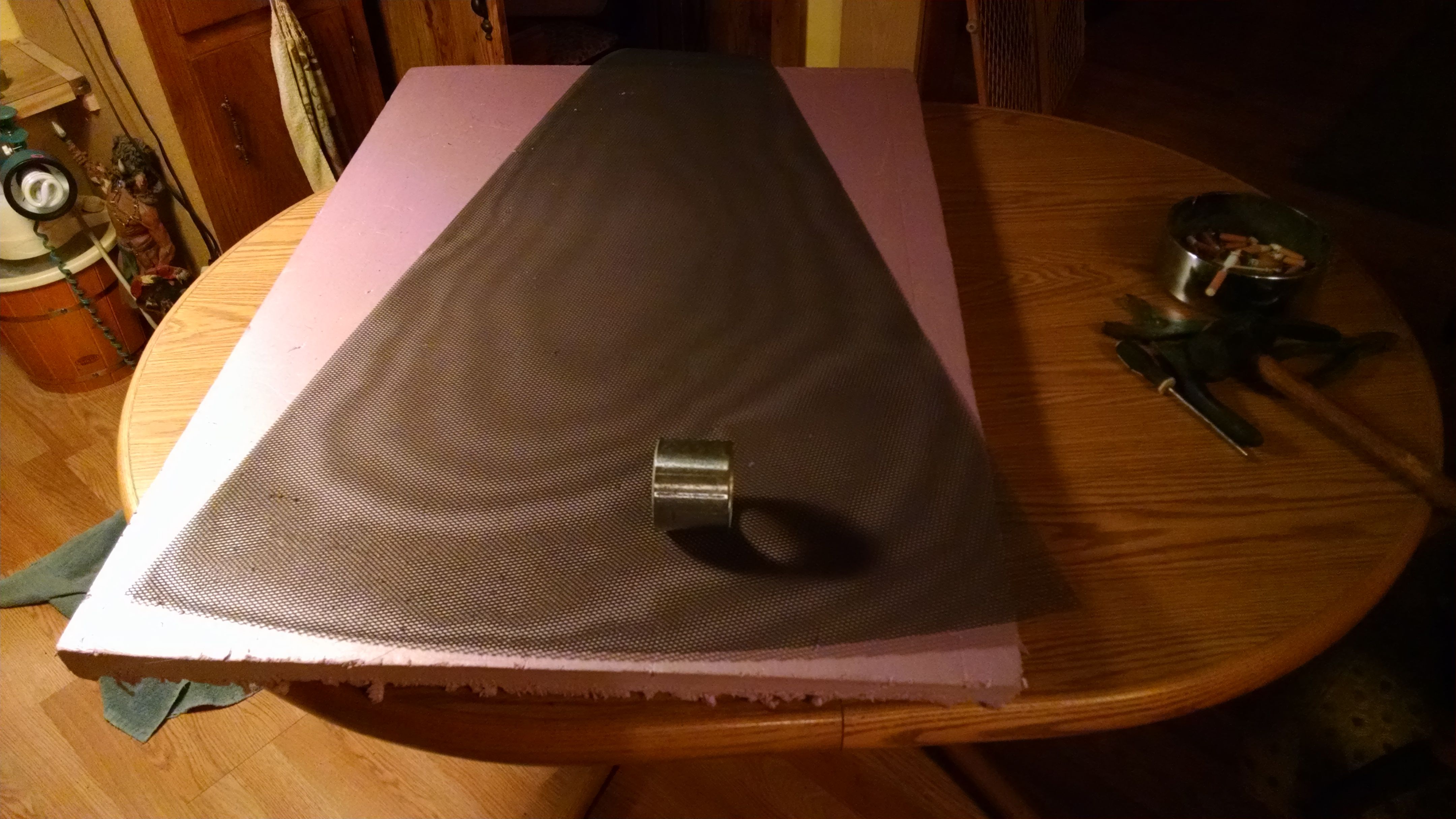

I wanted to send everyone my picks of the project from Before to After, and tried not to send every pic of every procedure, but I wanted to share a few tips I've learned along the way. From information that I learned from this forum, I have plugged the very center hole of the LNB cover to avoid bees and wasps from nesting, but I also wanted to share an idea I had for my mesh panels. I noticed that the previous owner tried to slip the panels into the grooves without removing the holding clips, and suffered kinks, bends, and tearing of the mesh. The easiest and least damaging way to get the panels to fit properly is to simply slide the panels out as careful as you can, and reinstall them from the outside in. Trying to stuff them back into their respective grooves stresses the brittle mesh material, and can tear on you, and you will either need to sew them together with wire, or replace them, and I've noticed that they are proud of these things. After removing the clips, I gently slid the panels out, took each panel one at a time, and took a steel pipe about 2" long, and layed each panel out on a firm surface, and smoothed out all of the bumps and bends out of them on both sides, then I applied a thin edge around each panel with hot glue to reinforce the outside edges to not only keep them from tearing as easily, but they are not so jagged to cut yourself from them. And best of all, if you keep the hot glue around the edges thin, it will keep the panels tighter in their grooves, and I'm not needing any clips anymore, cause the panels are snug, and do not even flap in the grooves. They are a little tighter to put back in, so moving the panels on the top and bottom with your hands is the way I did it. The dish had 2 panels with tears, so my wife stitched them together with thin copper wire, and I just painted the panels to cover up the stitches. You won't hardly notice them, and the integredy of the panels is in tact. The concrete might not look like it is enough, but the round concrete top you see is only to allow for weed eating around the pole. The meat is underground with a 1 foot round, and 3 foot tall circular base under the one on the surface. Road gravel was packed around the base, then some chat, then the rest of the dirt that was initially dug. I don't have a wide open space to choose from, so I am seeing from about 65W to 139W anyway, so I'll do with what I have. I will be doing some art work on the pole, and the theme will be camo, so look for some new pics when it stops raining here in the Ozark mountains. We are not in a low water zone, but the rain as of late is keeping everyone here hopping.
there were days where I couldn't stay outside for long periods of time, cause it was so humid, that between the humidity, and the mosquitos, it was everything you could do to keep moving forward. I need a shirt that says "KEEP REFRIGERATED". I guess it was all those years growing up in Iowa. I can take cold better than heat. My wife is from
Arizona, so you can imagine the Thermostat wars we have. She stayed in the house where it was comfortably cool for her, but when I came in the house, I needed to turn it down for a bit to get down to temp. She has been a Trooper through it all, and has been really patient. Other than humidity and rain to deal with, it has been an interesting little journey in this new hobby, and trying to explain something that is a bit new to me to my wife, and breaking the news that we CAN NOT get everything that is available, it is still not an overly expensive endeavor, and it is still better than paying out $100 a month to the Dish people, and between the 26 OTA Channels we are getting on my homemade DB2 Antenna, it has certainly been a relief cutting the chord. We have our internet with the local phone co. that is a better system than dish, and is $20 cheaper. So between the "BUD", local OTA, and Internet, we'll be set. But it is really fun to just "MacGuyver out" and have fun getting it going. But it is such a rush when it all starts working, and getting dialed in. And to my amazement, after I got everything cleaned, repaired or replaced parts, getting them all looking good, and then dialing in the numbers to set the elevation to where we live, getting the declination set, the focal distance, focal length, and getting the azimuth lined up right, and getting the receiver to see a good quality, and to start loading channels to watch, it is an absolute feeling of accomplishment. Cause as a good friend reminded me. It's a dance with the devil to get everything working, but what a kick it is to see it all come together. But I think I might have gotten lucky, as I had the system up and running in 2 days. I had a little help from our friend from Titanium Satellite to guide me with the installation of the C1 PLL LNB. (The one with Wifi filter) It works great, and I have yet to get my ViewSat Ultra-Lite all fixed up with the correct Sat info. I am not sure where to find the LATEST Sat info, so I'll just edit the info as I go. It's a long laborious process. I've seen some info from Satbeam, and other places, but who's the best? Anyway, it's nice to meet you all, and look forward to learning from you and sharing with you as we go. Best Regards Tom (KC5ZVT) P.S. I don't like real long posts either, so my future posts will not be this long. It was needed as my first post to explain things at first the best way I could, so thanks for your patience! Take care folks!!!

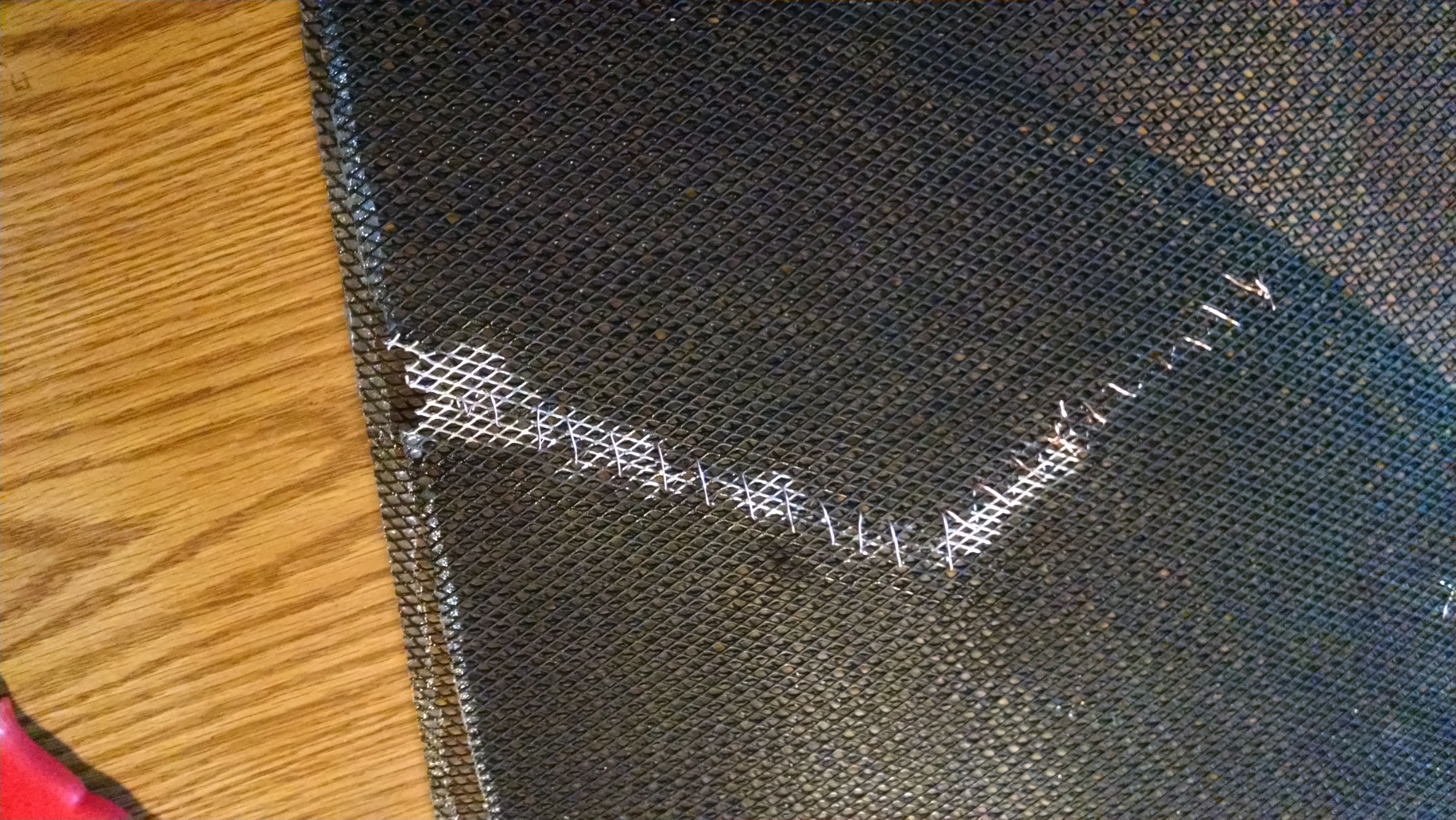

I like your idea of using a steel pipe to work out the bends in the panels. My Unimesh panels have some bends from close encounters with trees and could benefit from a roller session with some heavy pipe.

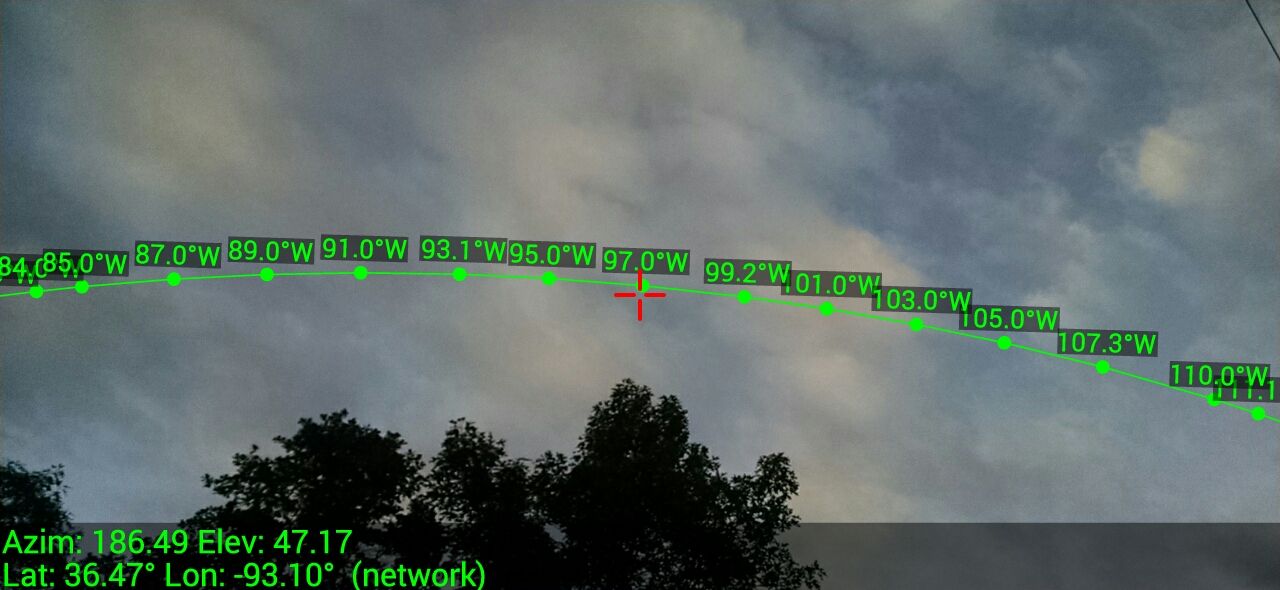

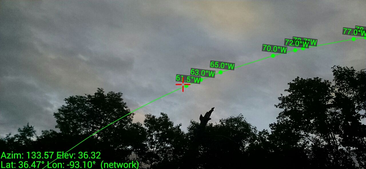

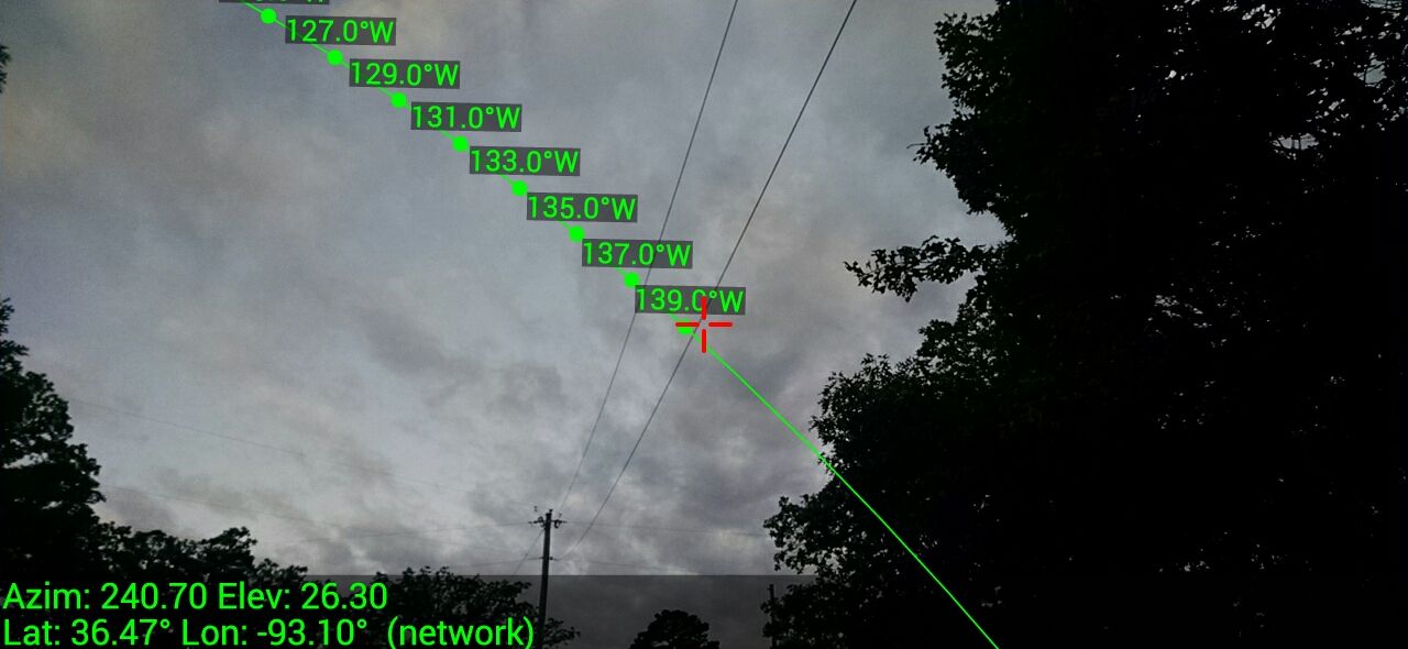

It's great that you've got your BUD tracking the arc from 65 to 139. There is a lot of good TV to be found in that satellite range. As to your question about getting the latest sat info -- I would suggest requesting access to the 'What's Up There' section. But you have to be a regular poster from what I understand. You probably already know about lyngsat.com and sathint.com. However, I have seen a lot of stuff on lyngsat that is way out of date. There is also a motorsports website which has a lot of temporary feed listings.

Sounds like you did your homework. Glad to see the rewards from that. You did a good job and love the fact that you posted the pics for everyone to see.

Great job on the restoration and thanks for the pictures. I would also like to see some pictures of your OTA antenna.

Nice looking dish, who made it, do you know. Good job on the restoration.
It's a CKD 8.5. Original owner bought it from Skyvision. I believe it's a Modified Polar Mount. It was in Dire need of love, and it was all out of adjustment. Maybe someone tried to adjust it, and got frustrated, and just said heck with it, and subscribed to the new gen dish, and there she was, left to the elements for years. Now it's all set to go with a nice coat of paint, and ready for her next journey through the sky. I went ahead and used the old LNB bracket since it is a little heavier duty. I painted the LNB bracket with some automotive color (Dk.Green) in the photo. It has metal flake in it, and then wondered if the flake would give me fits with signal after reading a few posts afterwards, but it seems to be just fine. The thing that really makes me wonder, is the 4 support arms were not even close to being right at the LNB. The arms were out of square as if they tried to adjust to polarity by turning the whole dome and everything. Maybe the motorized polarity motor went out in the LNB, and that was the beginning of the end for her. You can tell by the photos that she was left alone for a longggggggggggg time. The moldy stuff on the dome was practically barnicals. LOL.
Give us your rusty, your moldy, your worn out parts. It was a total mess, but it was in tact, not damaged, and it passed the fish line test, so I rolled up my sleeves, and got out the pressure sprayer, and low and behold, there was a nice, pretty dish in there somewhere. She's not done yet, because I'm an airbrush artist, and she's going to get a camo look everywhere but the dish surface. The dish itself will have a Galaxy painted on it, with a matted coat to seal it. The mesh will only show the subtle design due to the mesh structure, but the design with still show through. I can't do anymore artwork until it quits raining here in the Ozarks. IF it ever quits raining... Anyway, I'll keep you all posted as it progresses. Thanks for your shoutout, and it's a pleasure to meet you all. Well, my wife just told me that it's starting to rain again, so I guess I'll start working on updating transponder freqs. in the rcvr. I think I want a new SATPRO thats out...Take care!!! T
Nice job Tom, always good to see another Big Useful Dish restored and put back into service. I am about a half hour west of Springfield, MO so practically a neighbor to you, will be glad to see this rain go away for a while...keep up the good work.

Thank You too for the shoutout! The location that my dish came from was just south of Harrison Ar., and when I used the coordinates of the dishes original location before I brought it home, I assumed that since our coordinates weren't too far from each other, I would have thought that the dish would not need much adjustment, but when I brought it home and got it all cleaned up, painted, and everything ready for it's final adjustments to finish it's installation....... Wow! What was going on? I didn't really make a mental or written note of it's original setup specs, I just noticed that it was enough to make ME wonder if what I was doing was correct, since I'm new to this stuff. I just stood back and went to the original pamphlet that the owner had given me to just make sure that the dish was constructed properly, and am still abit fuzzy between a polar mount, modified polar mount, and H-H mount. When I think polar mount in my head, I remember polar mounting with telescopes and whatnot, so it was all new to me. Then, when I started understanding how the dishes are to track the arc of sats in the sky, it was confusing me that is was still a Horizon to Horizon track, but according to the dishes documentation, it was real vague as to how to construct the Polar mount vs. the HH mount. I didn't know what angles to read and from what location on the mount to set it correctly. I still have questions as to what mount this is. I'm pretty sure it is a Modified Polar Mount which for some reason is even more confusing to me. I believe after it was all said and done, I think it's set to the Modified setting. All I know is that so far it's tracking the arc the best I can see. My biggest challenge is the fact that I'm using a ViewSat Ultra-lite, and I am learning that this is pretty obsolete, and at best will be good for what it's worth until Christmas time hopefully.LOL. I think I'm steering towards the MiniHD. Until then, I will just make due, and get what I can while it's available, and wait to see how technology has changed by then. Ya know how that goes! Take care my friend, and look forward to talkin' again soon. See ya! "Neighbor"
Quick, and dirty, way of reducing your focal length. Not by much, only a very little.

Angles, and where to measure them. Take a look at a page I put on the web. http://www.wisegise.net/BUD/1713/index.html
I don't know about a 'modified polar mount' but there is a 'modified declination' angle that produces better tracking at the ends of the arc. No re-work required of the polar mount.
