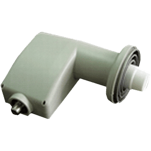

http://gotcband.com/collections/ku-lnbf/products/sl1p-geosatpro-single-standard-ku-prime-focus
The hard part is finding the conversion bracket. I use the LNBF above with a 6 footer that came with the bracket. Wait, good old Amazon:
Amazon product ASIN B00TSEI2SQ
Thanks for that link. Too bad nobody is making a PLL version. Is the Invacom C120 much better? - I can't help but notice it is only available in europe and costs 6x the price.
I originally was trying to get an Invacom, but like you said you have to order from Europe and expensive.
Then I tried the Ku side of a Chaparral Corotor II, but the LNBF I posted above gave the same Q, so I used it instead.

Want Ku Prime Focus in PLL?
Norsat makes PLL LNB (Somewhere between $200-$300, cant recall the correct part no.),
then pair it with a Ku only feedhorn ($100),
http://www.chaparral.net/feed-horns/ku-wideband/

The Inverto Black Pro is the best voltage switched polarity LNB in my opinion. Pair that up with an Invacom ADF-120 adjustable prime focus feedhorn for the best o the best... :)
