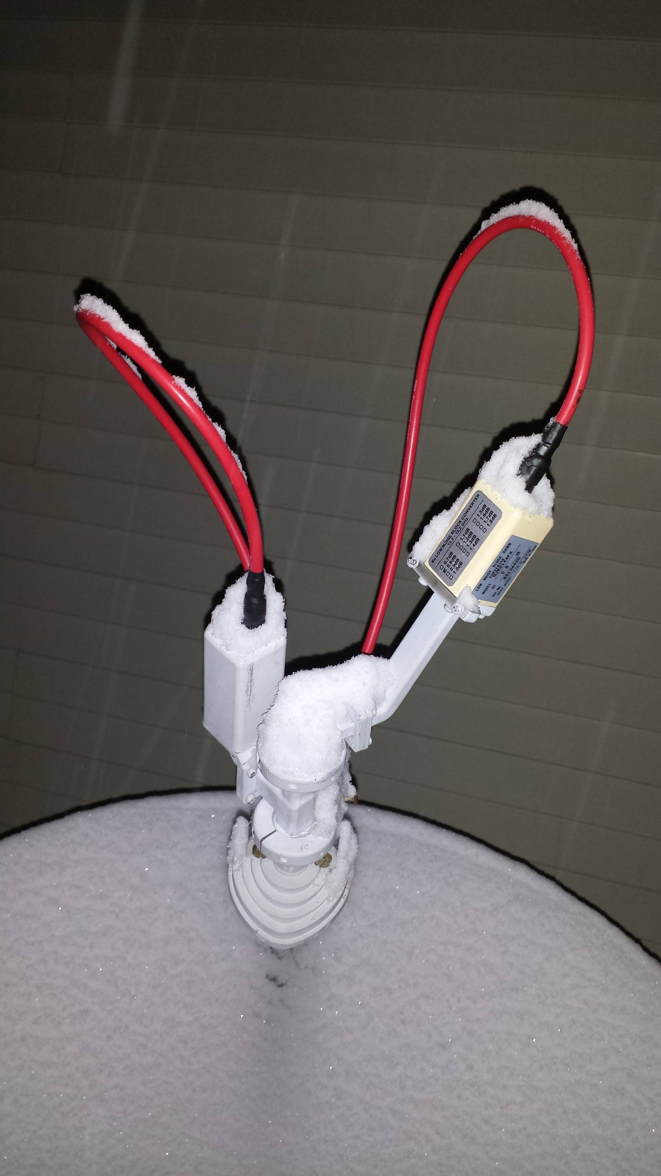

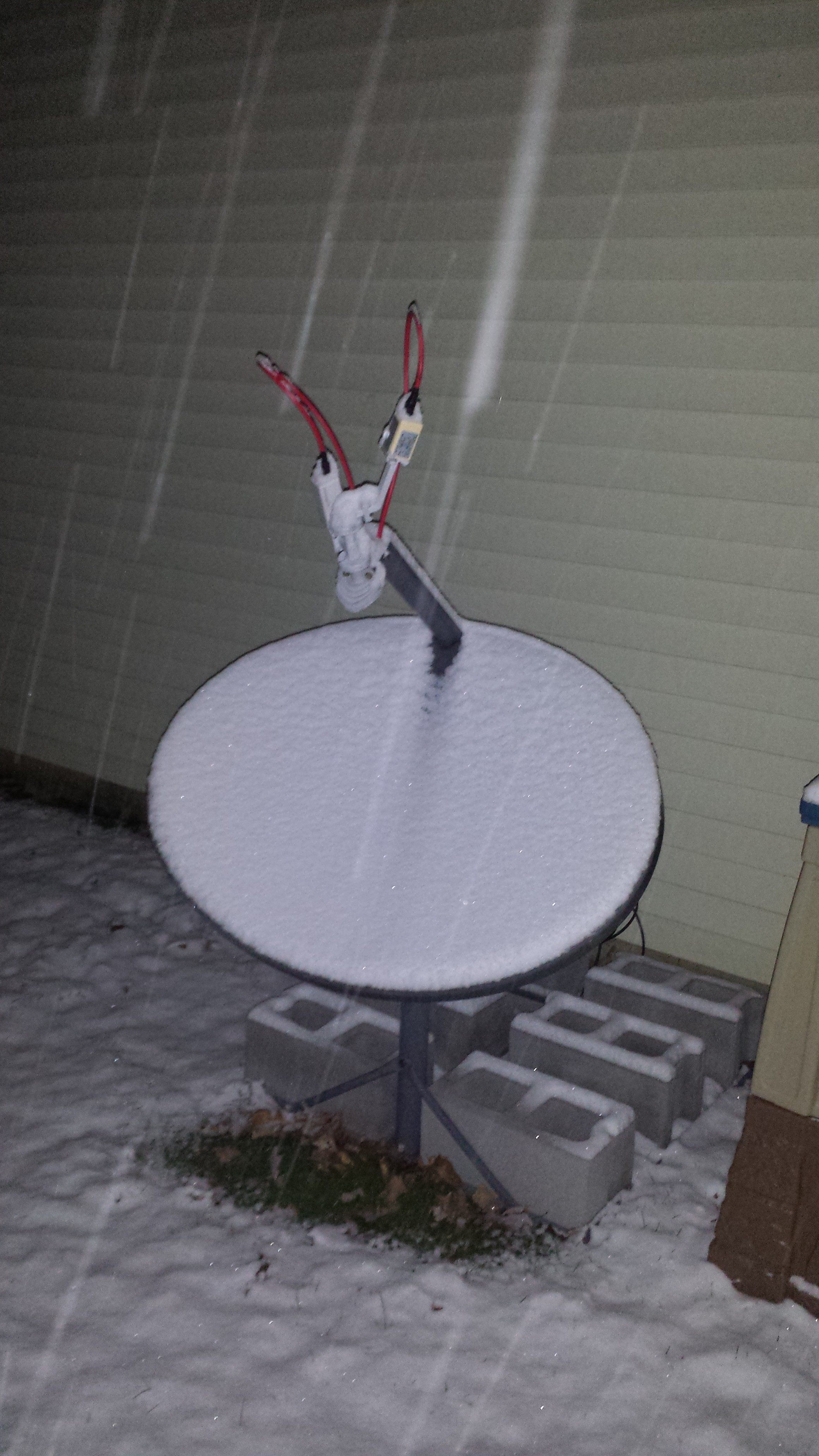

My quick 30W Frankendish
1badtwo
Apr 16, 2007
53
Ohio
I setup a dish last weekend for 30W before the snow hit. It's a CM 84e (old primestar) with a Starband OMT with two NJR LNBs. One was from the starband and the other was from my old 1M CM. Came home tonight and decided to take a pic in the snow! That's it just wanted to show some pics. Setup went smooth after the first hour when I realized I hadn't skewed the feed. :loco:
That's dangerous looking, with the red wires running around on it, haha! How does it work with all the ice on the dish?
Woh...You flipped the Primestar and did all this in the snow...There is an occasional feed on Hispasat if ya like soccer....I have thought about doing this for the Telstar 12 dish to see if any gain or stability is worthwhile...
It dropped my signal a tiny bit, I checked it out when I went inside. Although it was coming down pretty hard so it might not have been the snow on the reflector.
I pulled a soccer feed the other night, but I haven't really found anything much else worthwhile to me. Do you already point at 30 with your Telstar 12 dish? My arm was in the dirt so I flipped it. Looks better this way.
