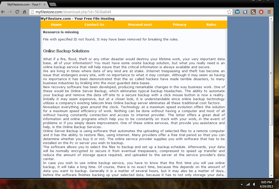

Just happened to me. :( From a MyYahoo link. But I had been on here a few times already today.
Just checked and everything is clean here. And I tested it from 3 different machines with different browsers on each machine and also clean.
I am wondering if maybe it was something cached somewhere?
All cookies are cleared when I exit FF. So I started today with a very clean slate. Login fresh everyday. Was here earlier with no issues. Strange.
Yep, just happened again to me. Same as yesterday. Clean (no cookies) startup this morning (FF), logged in just fine. About an hour later coming back (second time, again from a MyYahoo link) it happened.

Just happened to me again, this time from (1st visit of the day from this PC). Took a screenshot showing the time/date.
