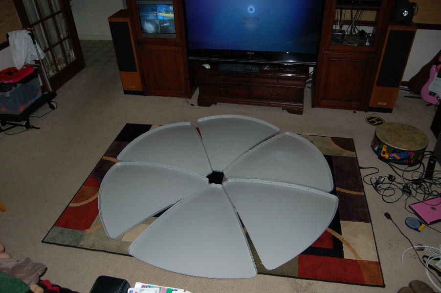

Got my dish this saturday here is a few pics:
Dish03.jpg The big box! also a small box, Impressed with the quality of the Sadoun Unit
Dish02.jpg My son was excited to put it together until he saw the bag of bolts! :)
Dish01.jpg Keep it in the living room to admire before assembly.
