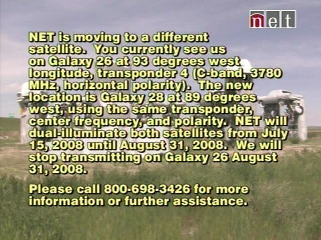

Here is the screen on NET about the move to Galaxy 28.
They are currently on both Galaxy 26 and Galaxy 28.
Most of the channels are mapped incorrectly on Galaxy 26 though. Only the HD channel T6 603 works at this time.
The channels have not been mapped on Galaxy 28 yet.
