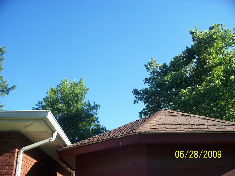

Pics

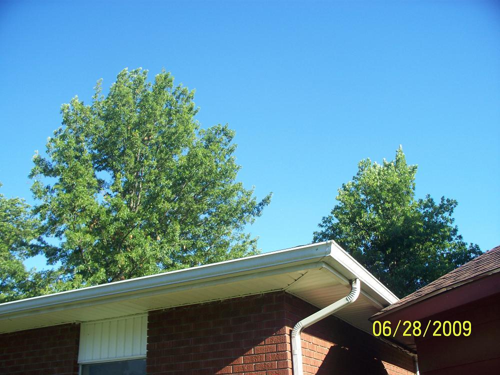

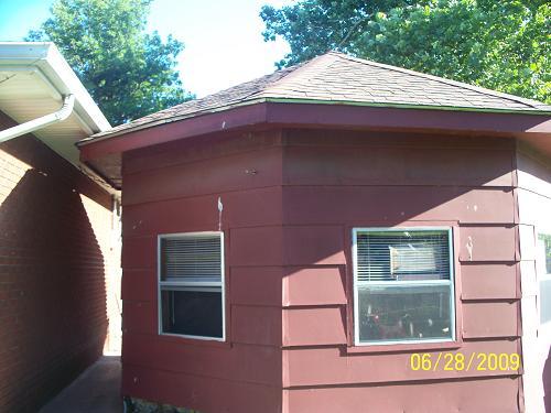

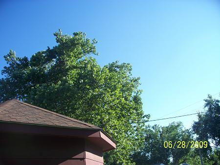

Some Pics to show Location, maybe I could mount on the gazebos. It would give a better angle, but it would be a pain if I had lnb problems.
pic1 pole location,pic 2 south,
pic3 east, and pic4 west.

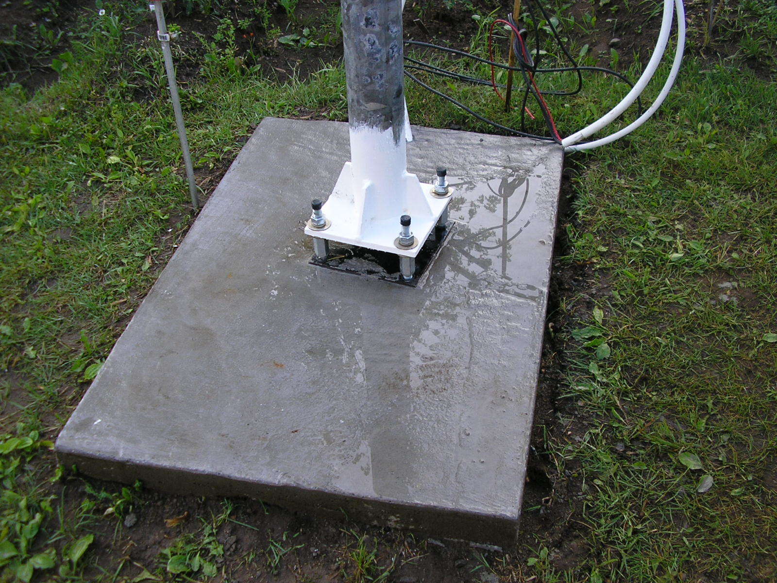

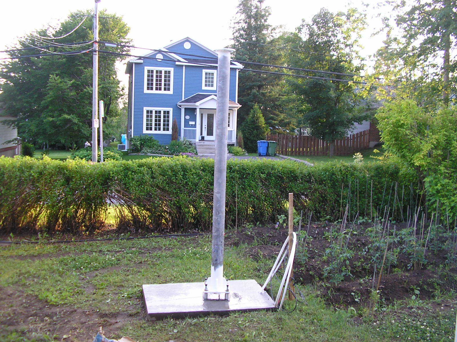

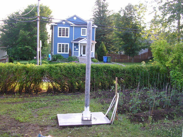

Hiya Long hair,,,,,
Here's a few pics for you,,,,to give you a few ideas,,,,,,
Hole is 20" X 20",,,,,6 Ft deep,so to be below the frost line,,,,,,and the soil cap is 4" thick and 3 ft wide by 4 ft long
All together 20 bags of concrete,,,,,,
Cheers,,,
