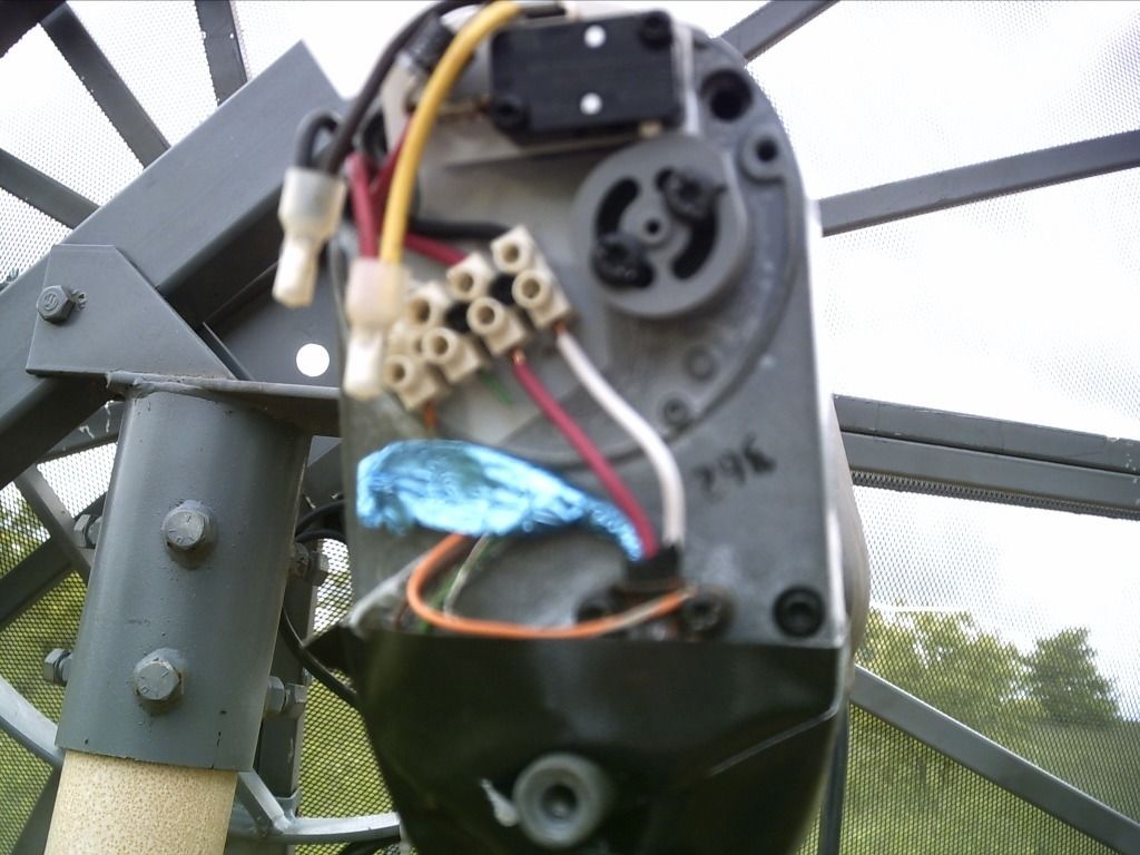

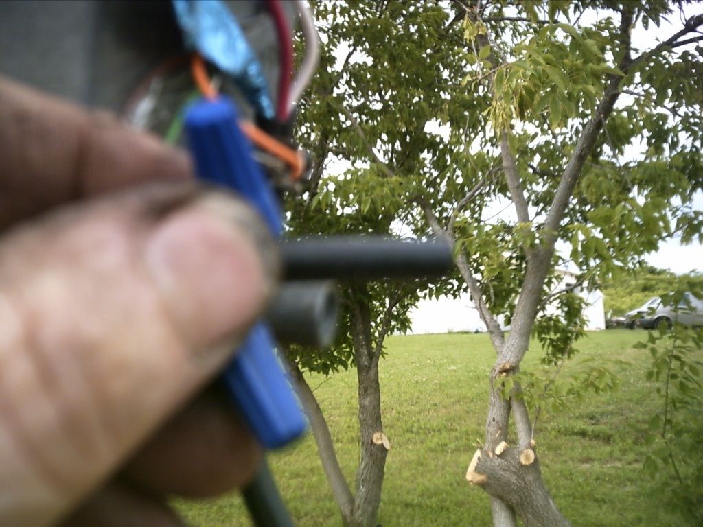

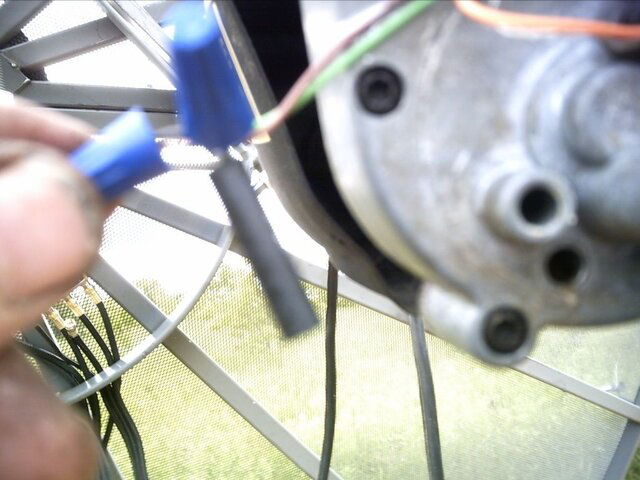

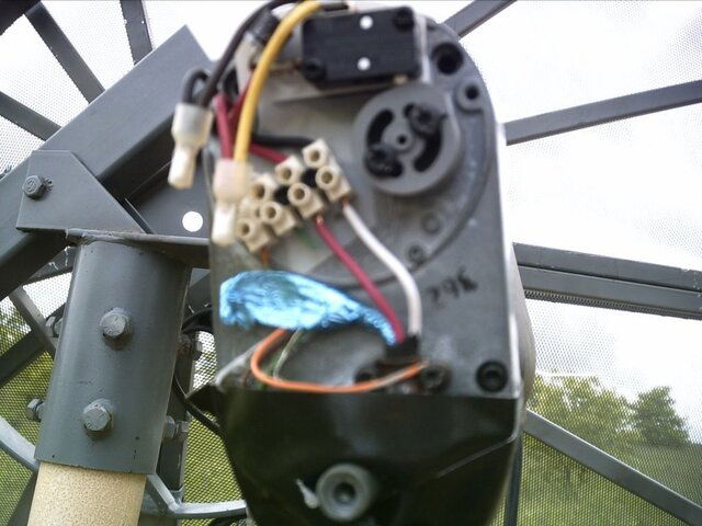

Im not sure if that is what I have. I took some pictures of it. It is a rod that is smaller than a pencil and about a inch to inch and a 1/8 long. It slides down in a hole just the right size for the sensor. It has 2 wires coming out of it and they are fairly short wired to my wires with wire nuts. It was siliconed down in its hole. It was a bit loose so I put a piece of tape over it to hold it in place but I still got the same results. E-2 on the display of the gbox. Please excuse my dirty fingernails as I had to change a water pump and radiator in my van today!

Can you take a picture straight at it from about 3 ft then maybe it will be in better focus. I'm not sure what you have by looking at your picture.
Im holding the sensor in between my fingers. In the 1st picture I have tape over the spot where the sensor goes.next shot is it pulled out to get a better look at it.

From your picture you have is a magnetic pickup assembly and not a reed switch and I have a hard time believing that it when bad on you, either both your boxes are bad or one your signal cables maybe has a break in it somewhere. Try shorting one end of the two small wires and measure with a meter and see if you get a short indicated on the other end with the meter.
