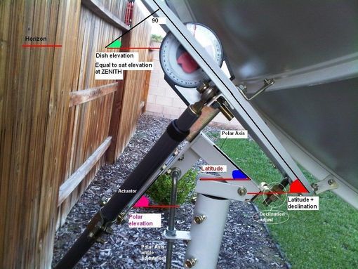

Double check that your dish elevation is 90-37.7=52.3 degrees. 0 degrees elevation would be horizontal, and 90 degrees is straight up.
Getting the angles set can be confusing as the perpendiculars are sometimes swapped. I'll just post this picture. It's pretty self explanatory. Have a better tomorrow.
The face of the reflector at the peak of the arc should be set to approx. 46.3 degrees (polar angle + declination) and aim for 91w.
The skew should be set to zero (looking inside the Feedhorn) the probes should be straight vertical and horizontal.

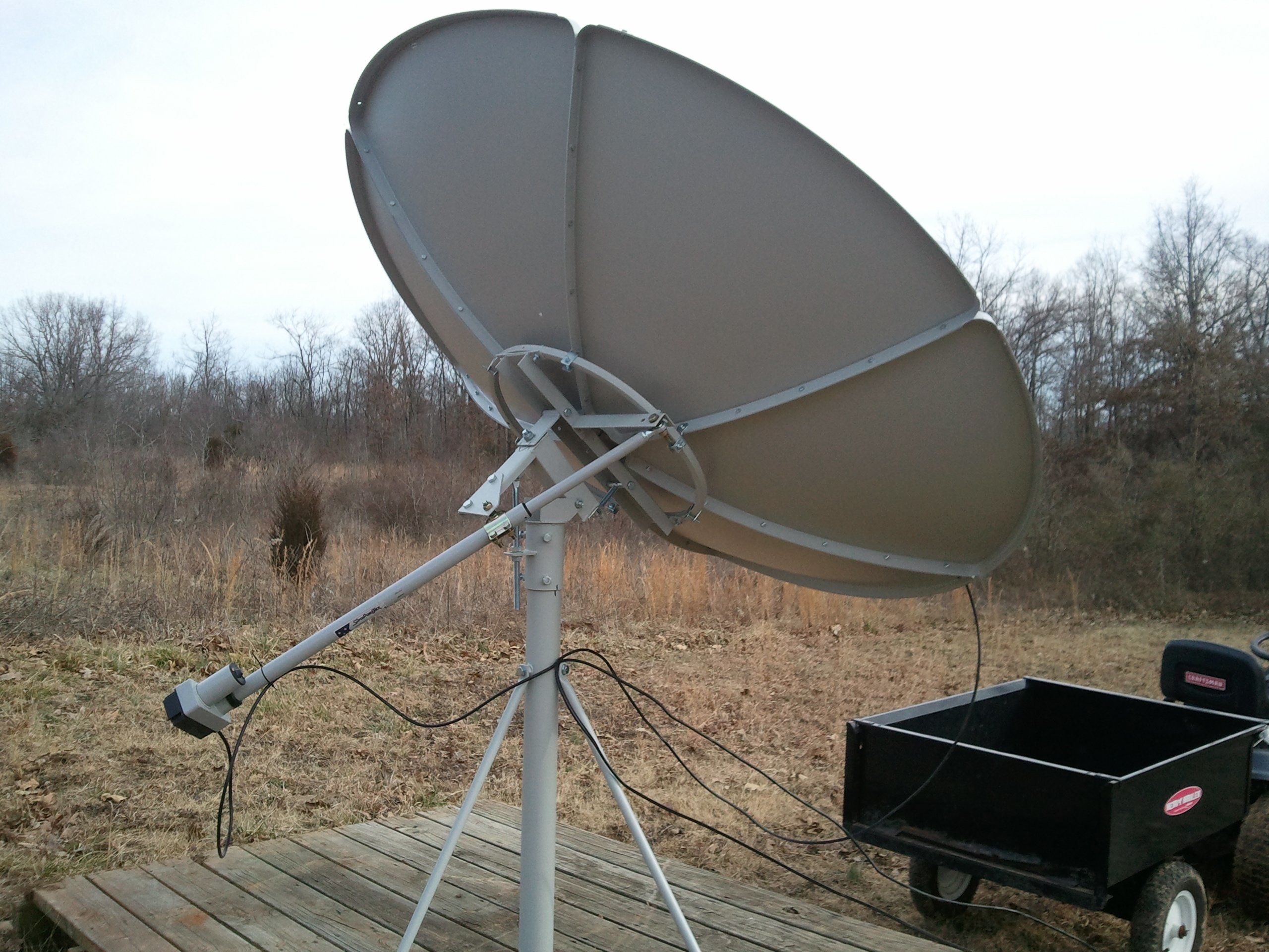

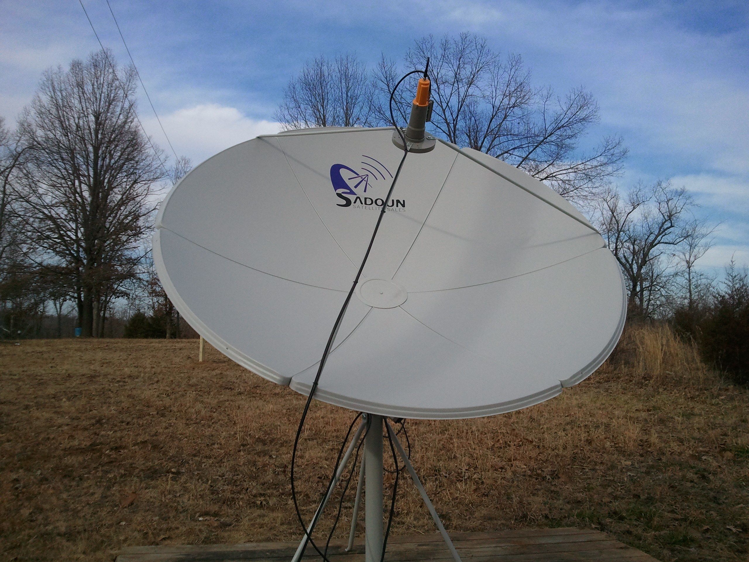

Ok so update on my system... I have it motorized and grounded. Still need to fine tune it because im not getting alot of transponders i should or could but im able to motor to several different sats. and get about 20 channels so thats ok for now. I know my mounting it on the deck is not the best option but it will work till the summer when i can dig a hole and set a pole, also im out of funds at the moment. I do have alot of blocks to put on the deck to weight it down so that will help, the deck weighs about 300 lbs. without the dish on it. Here are some pictures.
First little wind storm, and that thing is going head over heels!
I suggest you at least buy some farm fence posts, ($5 a piece or so) and drive them into the ground almost all the way at an angle, away from each corner. Then, run guy wire from the sat.pole to each fence post, and use turnbuckles in the middle to crank them tight all around. That should help.
I didn't see the blocks on it in the picture so maybe he made the picture first. With some good weight and luck he may be ok until he gets it in the ground-provided there isn't a lot of wind. Those dishes will catch the breeze!
I had same dish on two inch thick by thirty six inch diameter concrete pad. It was there for three years and never moved. Put a bunch of concrete blocks or sand bags that outta hold til you can dig
The blocks are not on it because im been lazy and watching tv, lol. I will put them on monday its not supposed to storm any time soon. Also i put up a weather station so ill be able to tell how strong the wind is.
