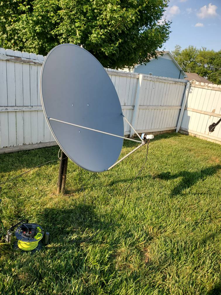

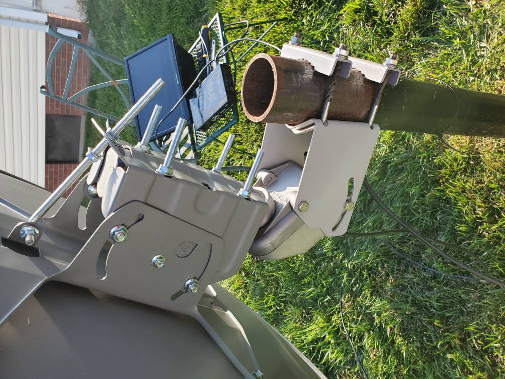

Hey guys I got my new dish a 120cm geosatpro and a HH120 motor. I need some help in getting it going. I can't even get it to move. Iam using a link box 9000i. Do I have something set wrong.

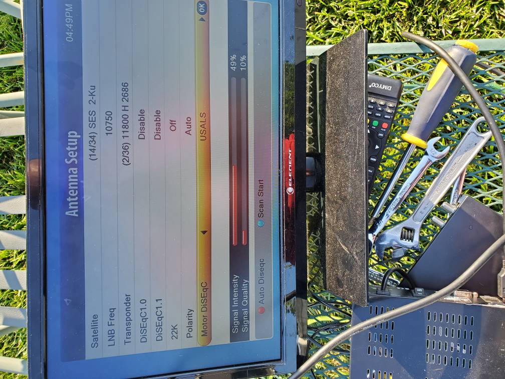

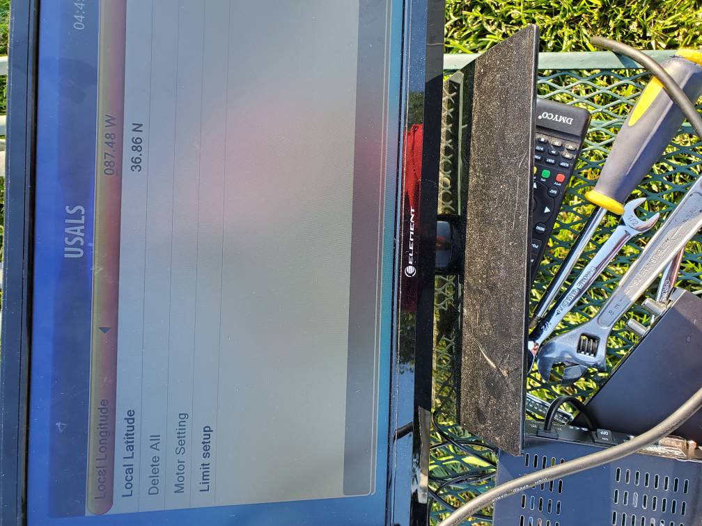

Your sideways pics are hard to read. haha :D
yes i have tried 2 different receivers and yes i have a good piece of coax and good connectors.

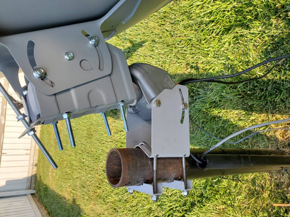

Also, any reason why the motor is mounted upside down?
I have the same STB and from the pics it looks okay.
How about a photo of the motor where the coaxes are attached?
While the Stab HH90 is installed with the shaft pointing down the HH100 and HH120 both install with the shaft pointing upward so he is good there. Here is a pic of my HH100 with my 90cm Fortec Star (and a modded DirecTV Slimline for Orby on top of the pole). :)

That is not the exact same. Yours is a HH90. :)
Yes the HH120 the dish mounts on top.
I would "2nd the motion" to try to move the "motor" without the dish mounted and LNBF disconnected. Then try with the LNBF connected. If that's good them mount the dish again and try it. Maybe the receiver doesn't have enough power to get the motor to move with a PLL LNBF?
Another thing, make sure you try a horizontal transponder in your receiver setup so you get 18v at the motor.
