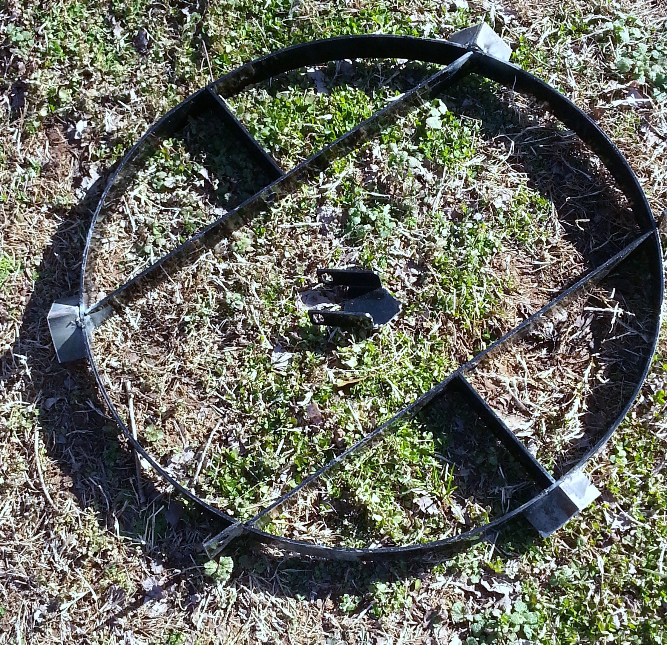

I would think twice about using tek2000 for parts. A complete matched assembly from them might be ok, but I wouldn't use their polar mount (said to be weak) on a heavy American made dish.

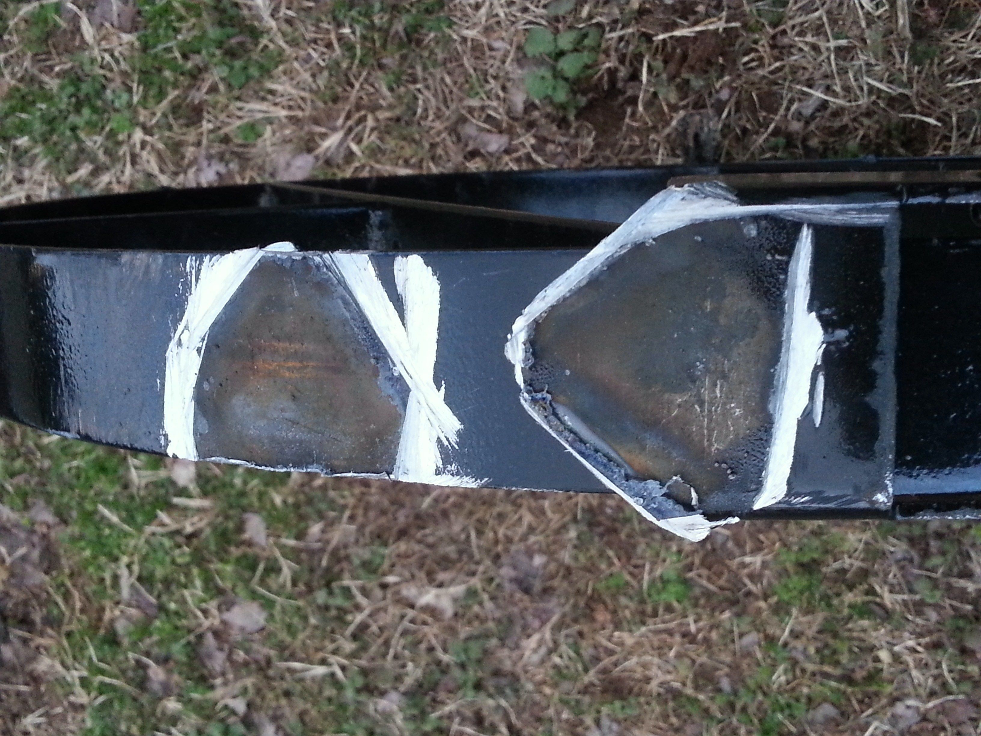

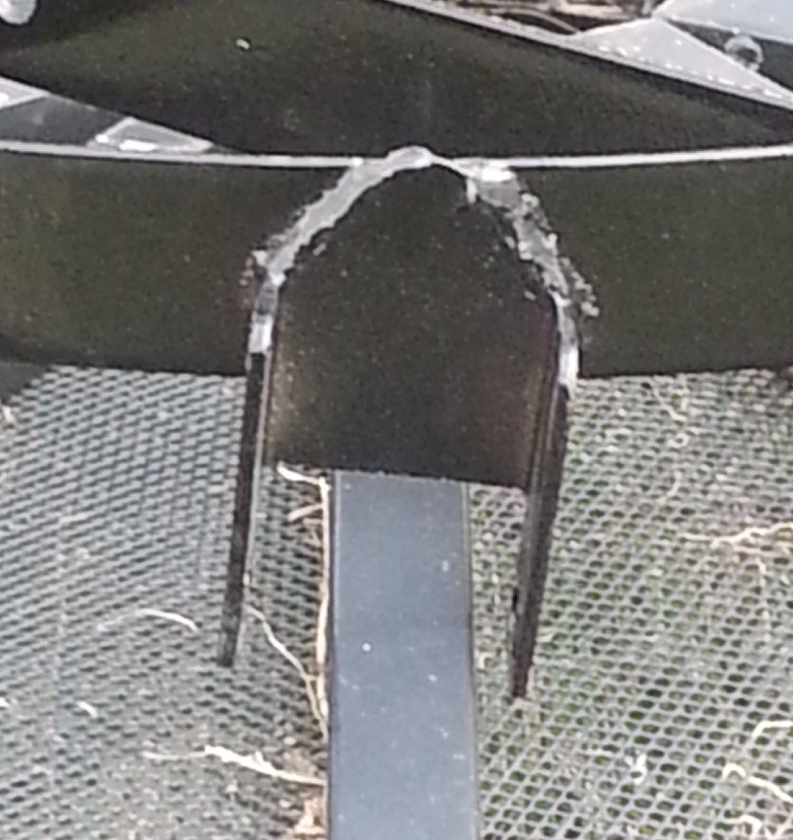

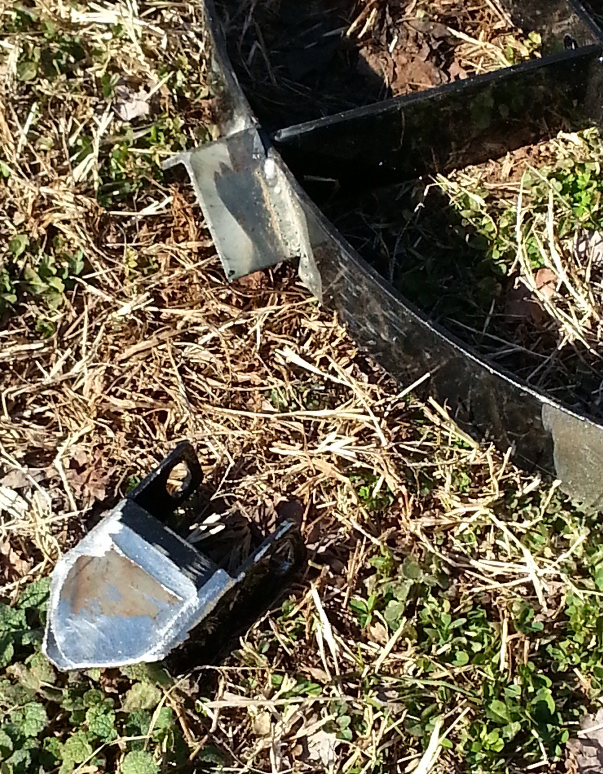

YEP !!!!! I will have to agree on all points :eeek even with the quality forewarnings, I was still quite surprised:oldno:thubdown........ the parts appear to be poor knock-offs of poor knock-offs..... but I suppose I was "warned" in an indirect way. I firmly believe that I won't buy here again - I think I over paid despite the included shipping from Canada.

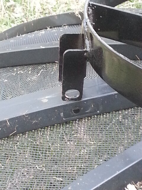

luckily, the 3 panel Sami 7.5 is extremely lightweight........I will add some strategic bracing here and there on the backing ring and elevation bracketry..... Overall, I'm not tooo terribly upset, these things (i.e. hobbys) help to keep us mentally and mechanically sharp.

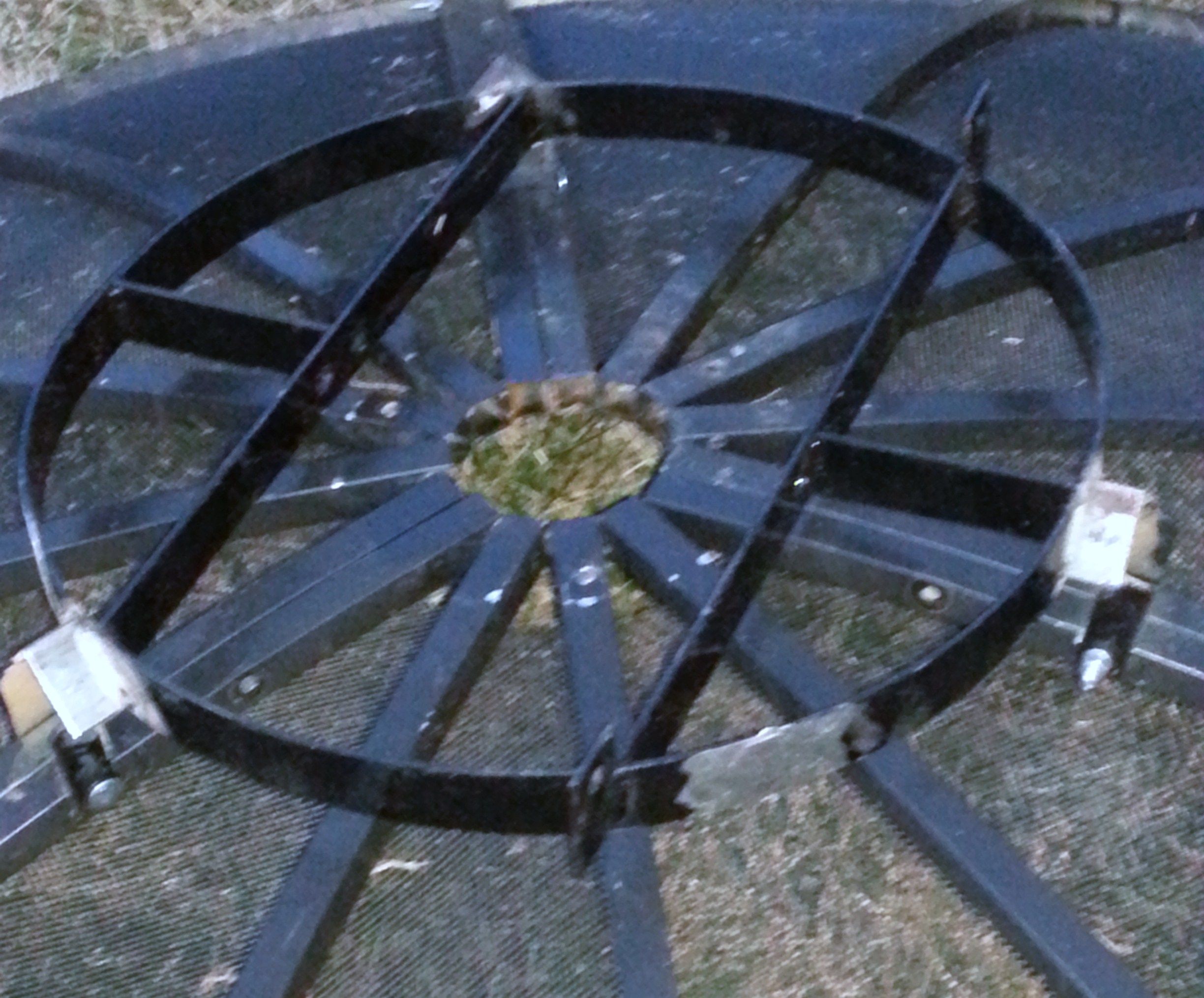

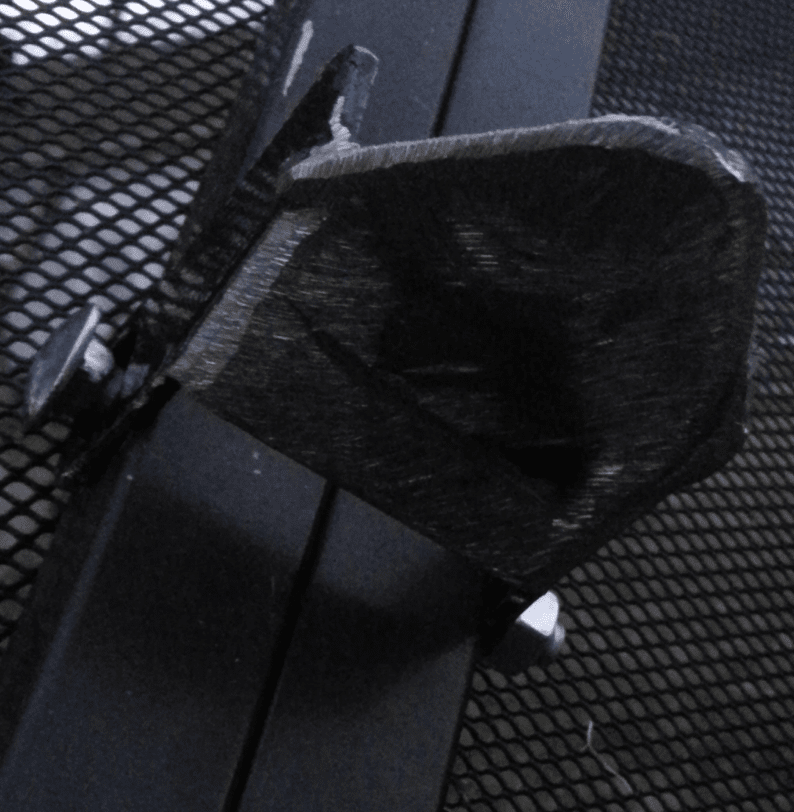

20150215_182111.jpg 2015-02-15 old 21.13.45.png sami dish aac.jpg sami dish aad.jpg Tek2000 quality.jpg Tek2000 quality a.jpg photos of modifications to the quality Tek2000 parts. from a 4 bracket " knock-off " mount to 3 mounts for the SAMI

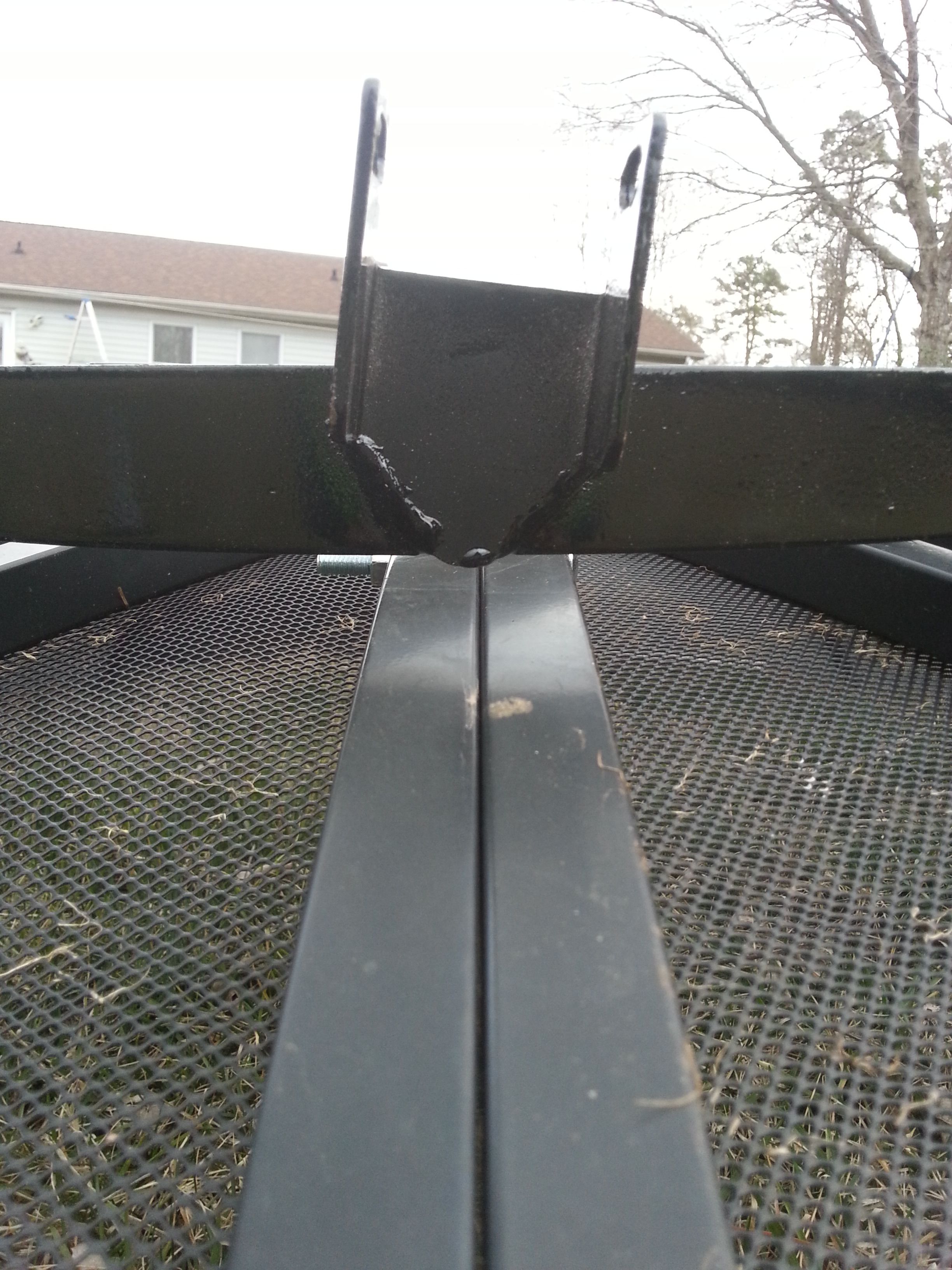

I think once I get it up on a pole, I'll add a piece of metal to make the ring's actuator tie-rod tab into a reinforced stirrup. I really hope their complete kits fit better together as a matching set because I'm sure they sent some production rejects....the ring is oblong, bracketry extremely thin & off-square, poor weld quality. the good thing is I didn't have to start completely from scratch.sami dish aae.jpg
not sure what I was expecting, but I was hoping at least for individual components assembled in a jig, what welder [anywhere] do you know would let something so far off angle to leave his/her bench ? maybe a cold, starving, and fume-dizzy 8year old I guess.....:oldno disregard the cocked mounting shackles(?) the ring didn't even lay flat :what2, thats why I assume they sent me something scheduled to be reworked or from the training pile - since I didn't order a complete dish kit. ....... another lesson learned so its all good......(:loveWeldPak 3200HD:heartbeat - top 10 lifetime best purchase in the "don't need it, but want it anyway" category)

You could find a fabricator or supplier that would sell a 1'' to 2'' section of ~.25wt steel pipe of diameter of 18'' to 24'', depending on your needs. That way you would start off with a round ring, then build off of that if the ring you have is not that great. Just a thought as you mentioned you did not want to start from scratch and this would almost be like starting from scratch.
http://www.saginawpipe.com/steel_pipe_chart-3.htm
wow, I never thought of that- darnit - that probably would have worked well and after my personal modifications - still come in under what I've spent already - thanks for the tip for the next reflector only salvage job. I probably could have gotten to where I am now for $40-$50 guessing. backing out the actuator($50-ish) and Can->US shipping($50-ish), I'm guessing my chinese polar ring, elev.bracket, and misc hardware is $100 - still REALLLLY can't complain too bad though......I'm really sharing more than I am complaining.... :blah

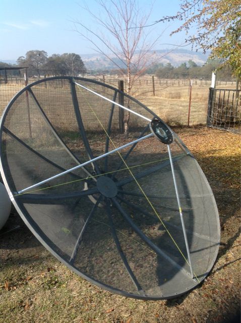

personally i would convert the 7.5 ft sami to a 4 pole using electrical conduit ( like Fat Air mentioned) probably the cheapest route . if needed i can get the length of my unimesh 7.5 length of poles should be close . i'm currently not close to my unimesh to get you a comparison on fd but should be able to get those numbers and pole lengths in 2 weeks . or maybe another member can post their unimesh pole lengths and fd for the 7.5 fter

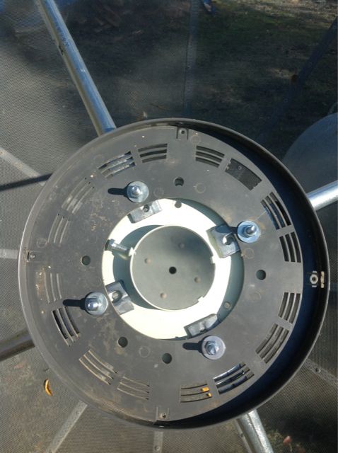

being a three petal, three pole, I'm thinking that following the existing engineering would be easiest encorporating "enhancements" to the TEK2000 material along the way.....my Unimesh's 7.5 four-pole'r supports are apprx 47" I found some very light weight 48" alum. tubes at Tractor Supply for $8/ea. I'm kicking around the idea of some simple bracketry for the scalar ring end, and then something similar for the three holes around the reflector side, possibly with 2"-3" of slide & set [screw] adjustment...... I think I'll return the larger OD and heavier metal conduit back to HomeDepot.
any thoughts ?
any thoughts ?
This is 1/2" electrical conduit with the ends flattened with slots drilled to allow for adjustment of the scalar for F/D. I replaced all four struts as a couple were bent.
The 7.5ft mesh end looked like this.
I thought I spent $8-10 for a 8ft length and just cut it in half, but I'm not sure. Been a while.
Just an alternative.
