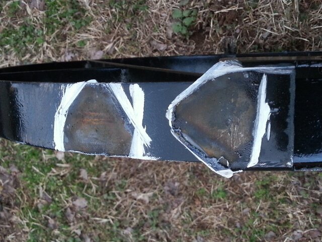

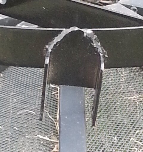

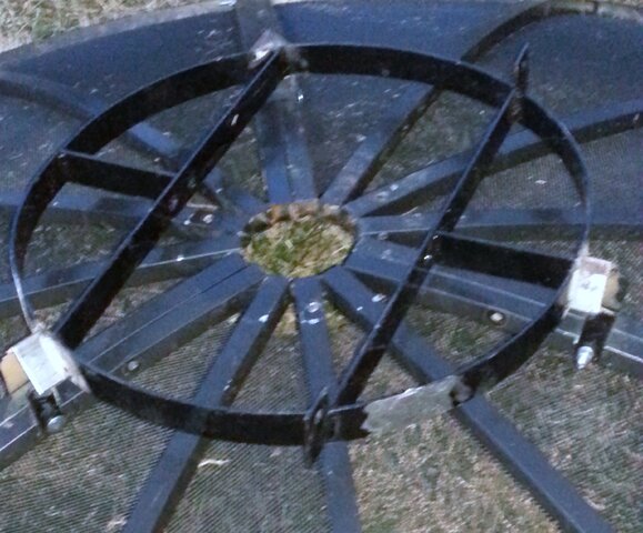

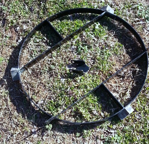

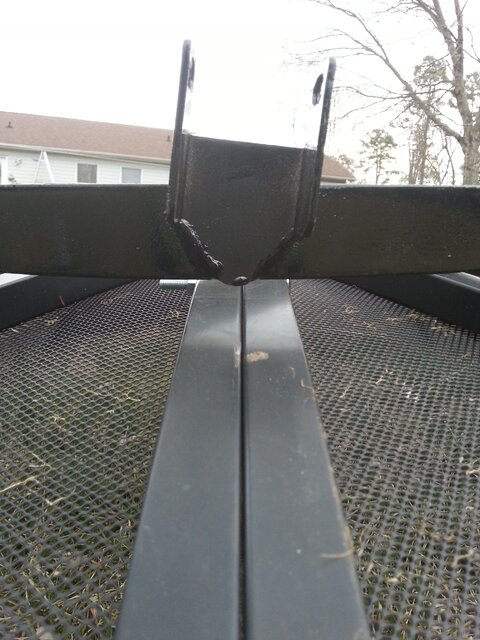

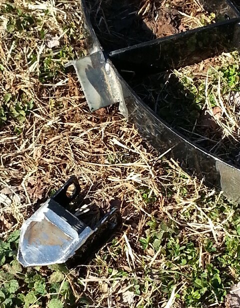

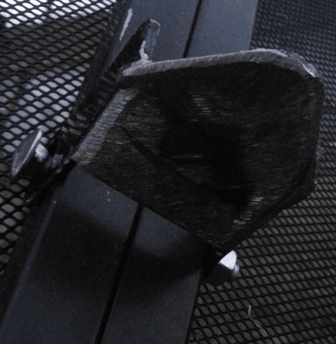

YEP !!!!! I will have to agree on all points :eeek even with the quality forewarnings, I was still quite surprised:oldno:thubdown........ the parts appear to be poor knock-offs of poor knock-offs..... but I suppose I was "warned" in an indirect way. I firmly believe that I won't buy here again - I think I over paid despite the included shipping from Canada.
luckily, the 3 panel Sami 7.5 is extremely lightweight........I will add some strategic bracing here and there on the backing ring and elevation bracketry..... Overall, I'm not tooo terribly upset, these things (i.e. hobbys) help to keep us mentally and mechanically sharp.

I think once I get it up on a pole, I'll add a piece of metal to make the ring's actuator tie-rod tab into a reinforced stirrup. I really hope their complete kits fit better together as a matching set because I'm sure they sent some production rejects....the ring is oblong, bracketry extremely thin & off-square, poor weld quality. the good thing is I didn't have to start completely from scratch.sami dish aae.jpg
not sure what I was expecting, but I was hoping at least for individual components assembled in a jig, what welder [anywhere] do you know would let something so far off angle to leave his/her bench ? maybe a cold, starving, and fume-dizzy 8year old I guess.....:oldno disregard the cocked mounting shackles(?) the ring didn't even lay flat :what2, thats why I assume they sent me something scheduled to be reworked or from the training pile - since I didn't order a complete dish kit. ....... another lesson learned so its all good......(:loveWeldPak 3200HD:heartbeat - top 10 lifetime best purchase in the "don't need it, but want it anyway" category)

This is 1/2" electrical conduit with the ends flattened with slots drilled to allow for adjustment of the scalar for F/D. I replaced all four struts as a couple were bent.
The 7.5ft mesh end looked like this.
I thought I spent $8-10 for a 8ft length and just cut it in half, but I'm not sure. Been a while.
Just an alternative.
