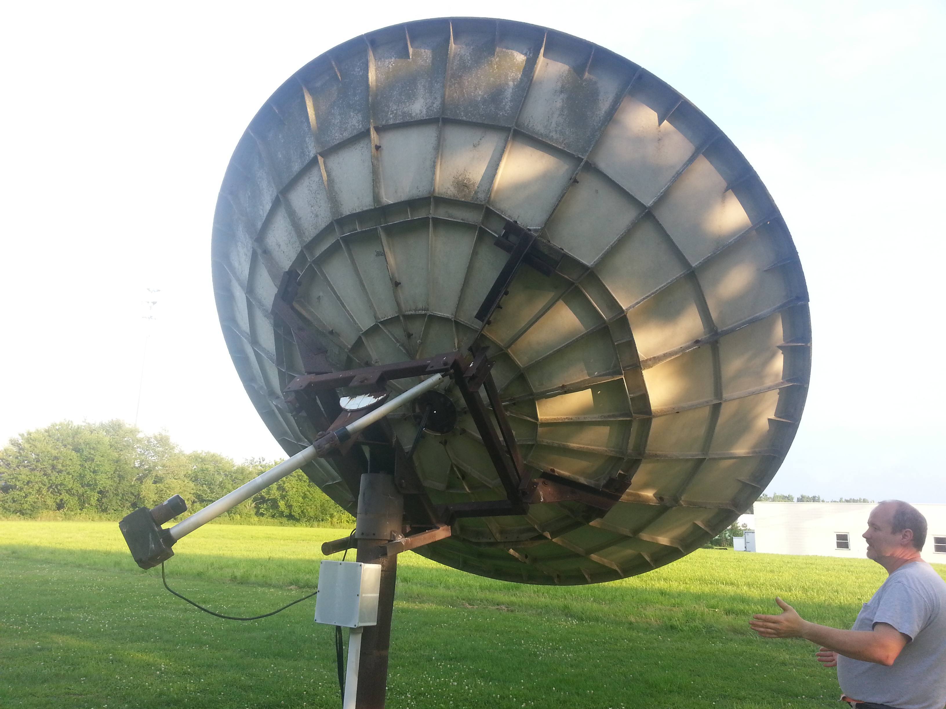

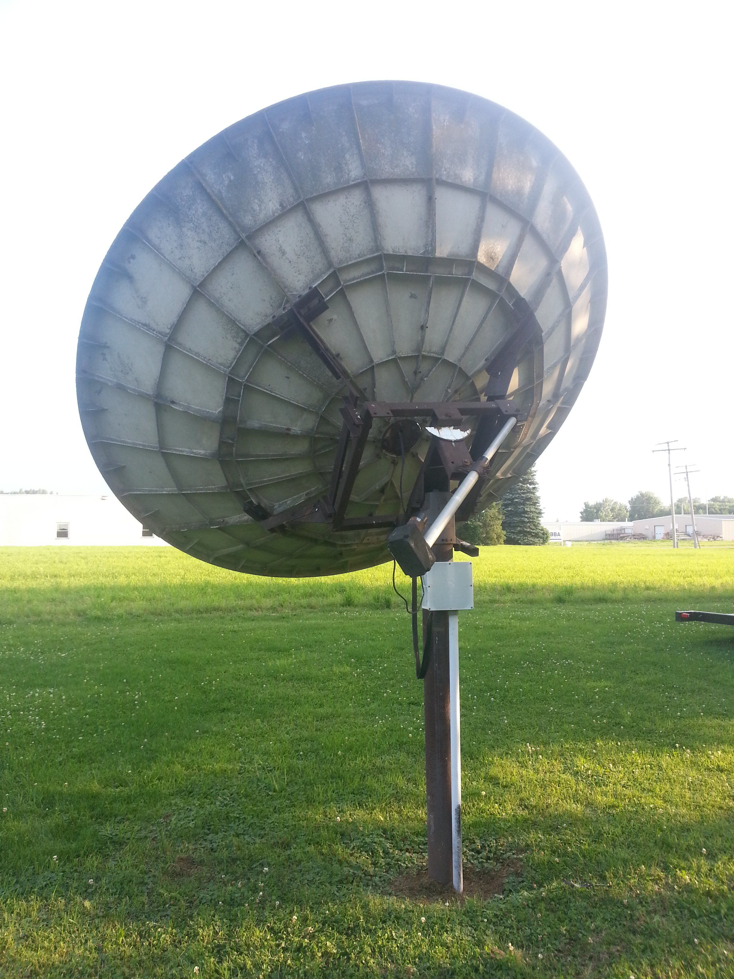

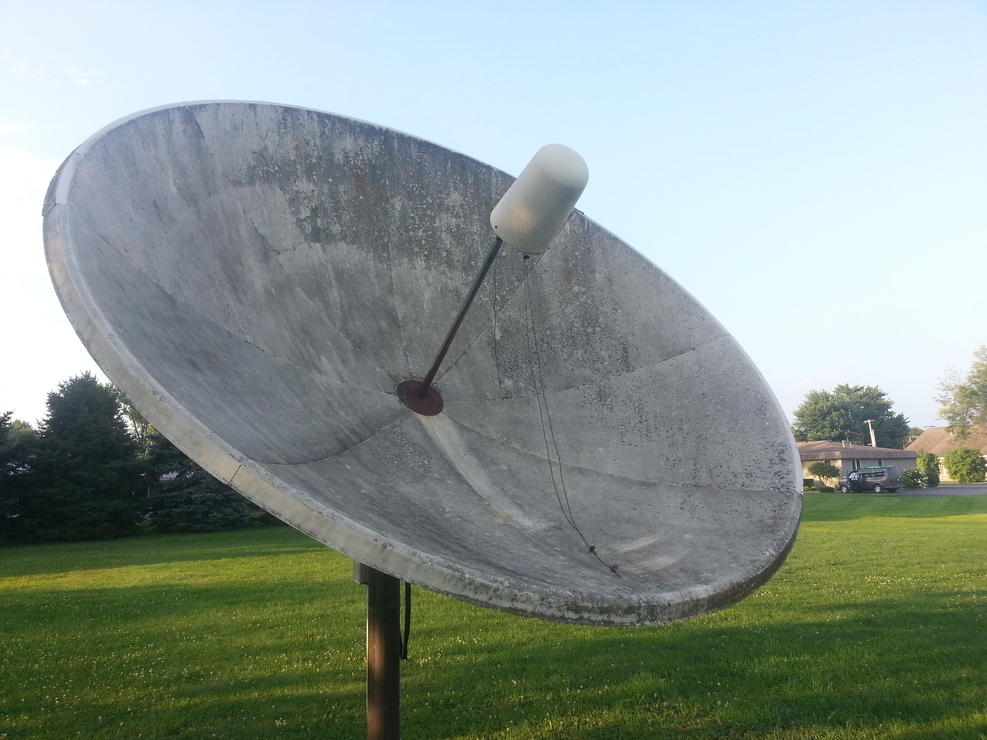

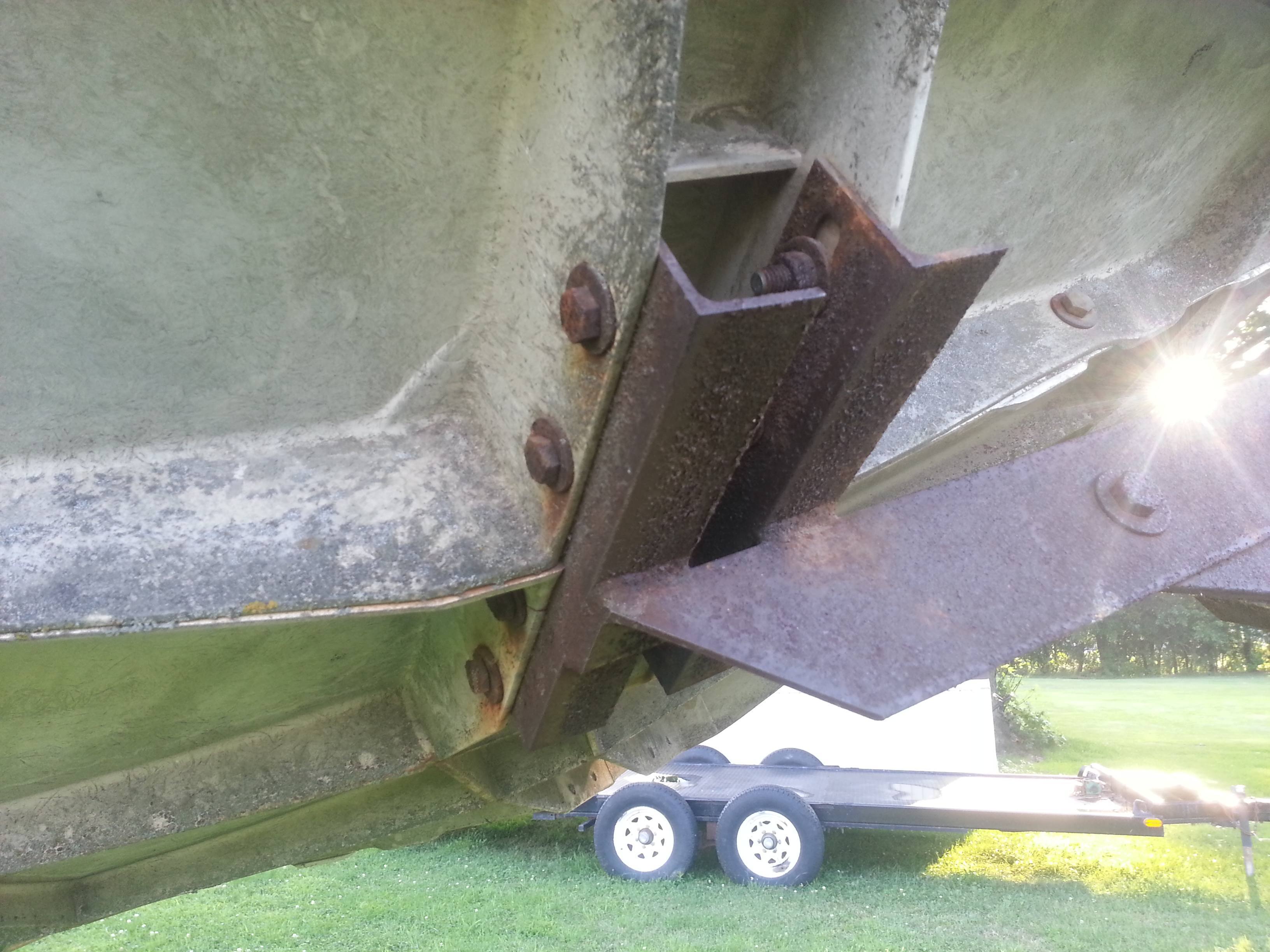

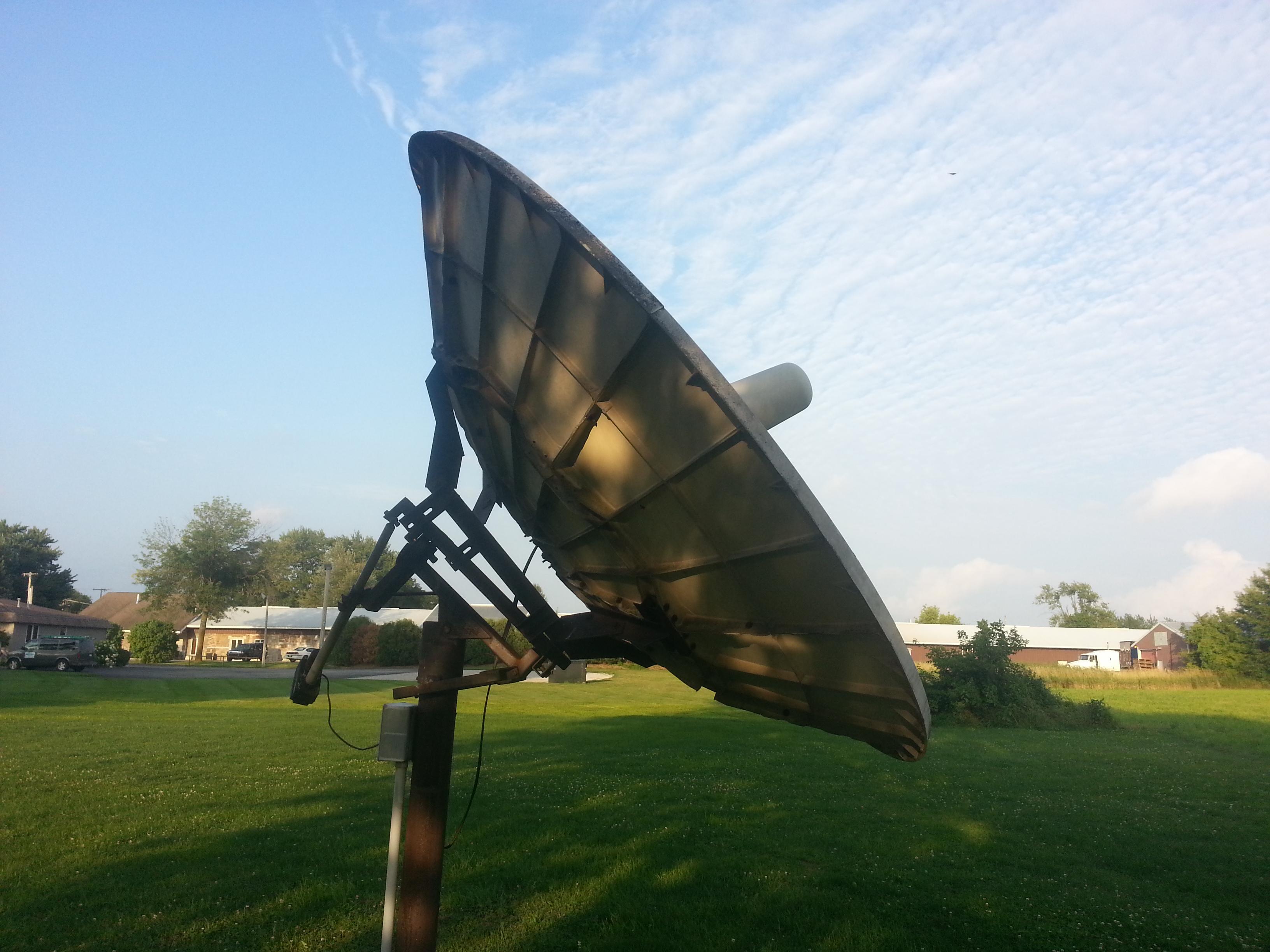

I was just given this 12' dish, not sure on the brand or year. Gonna pick it up tomorrow!!

12ft fiberglass. Wow. Bring LOTS of help. That thing probably weighs as much as a small car! :eek:
Yep good thing those break down to 8 panels...still heavy though..;)

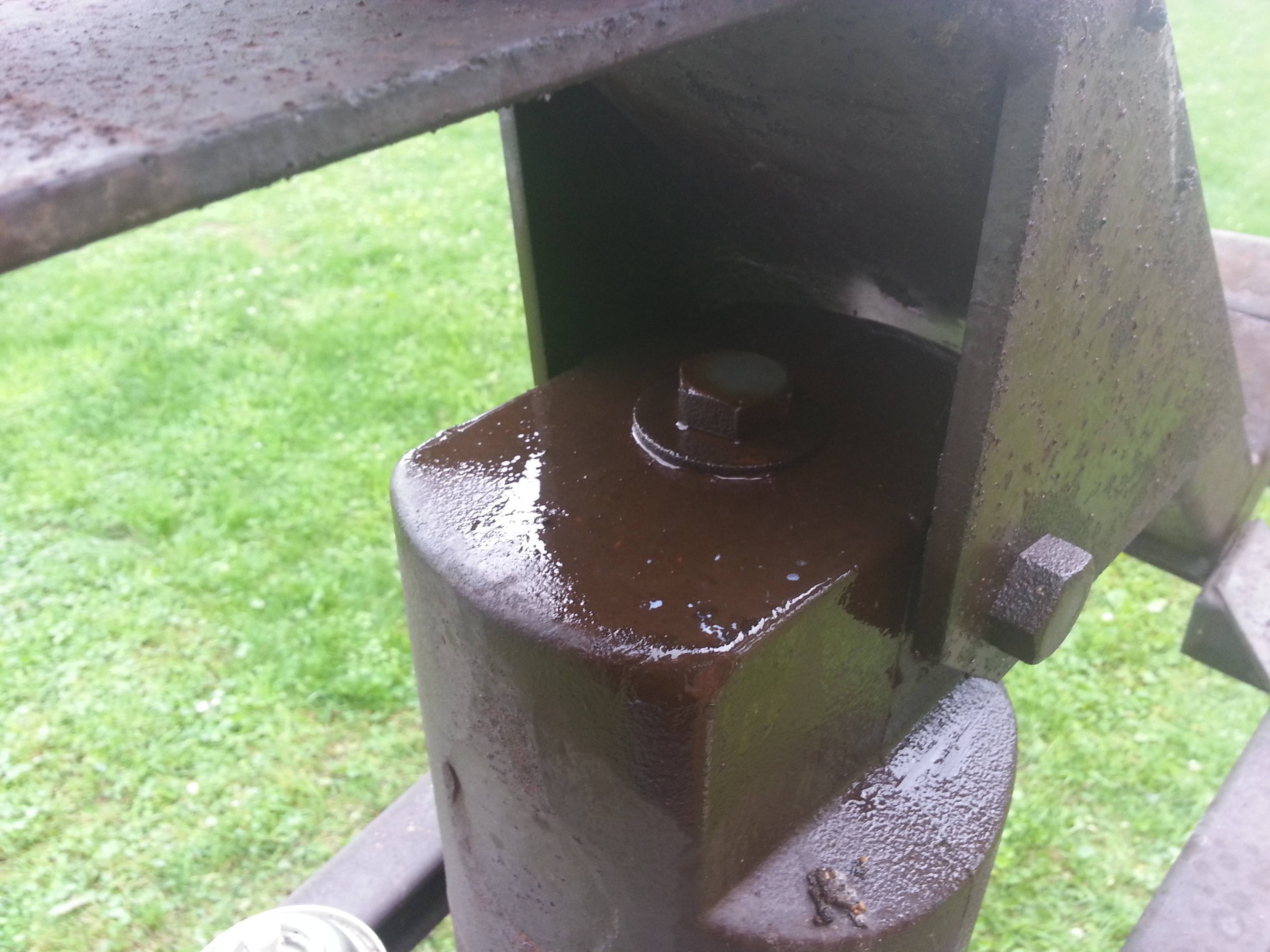

Got the reflector down and home. Came down without too much trouble. Can anyone tell me how to get the mounting hardware off the pole? There were no bolts in the sleeve to clamp on to the pole, I'm guessing its on a 5" od pole. There is only one bolt that goes vertically down into the pole. Is this the only one holding it? I'm going back to get it off Saturday and the pole has to stay sadly:frown:20130807_181033.jpg

Yep, most likely just loosening that bolt on the top should let it off the pole.
Don't break it. May need to spray it liberally with Kroil or PB Blaster.
If the bolt backs out(up) without loosening the mount, maybe a smack with a hammer to push it back down, to release the internal clamp.
May also need a smoke wrench to encourage it to release.
