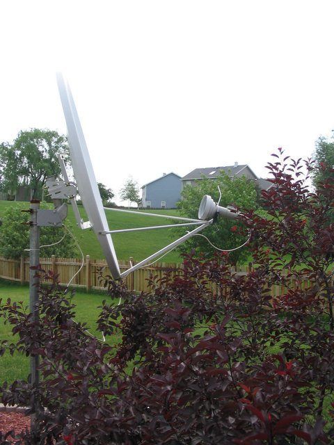

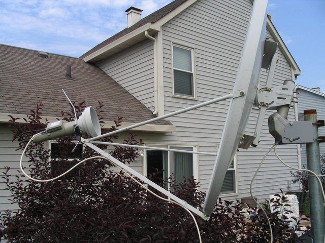

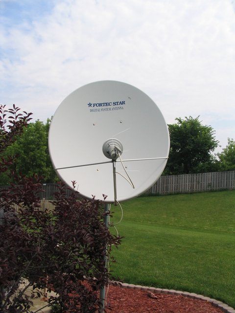

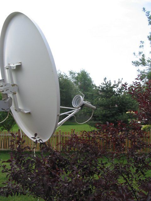

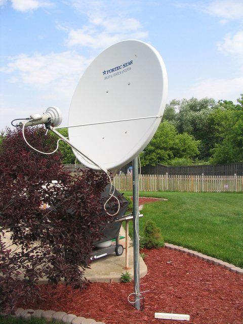

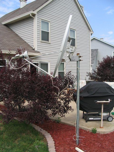

Here's some pics:

Very cool thank you! I see you have the scaller ring on, I thought for offset use you needed to take it off. (At least someone told me that)
I would be interested in what your picking up on the C Band and KU band side of things.
Also look like I need some wireties as it appears the LNB does not fit in the holder correctly. :D
The scalar ring I have is not the one that came with the CKU lnbf. This is a cone shaped ring which is supposed to be better suited for offset dishes. I think you will need a scalar ring of some sort to get it work because without it it will not illuminate enough.
It is performing good on c-band side (considering the size of the dish). On ku side I am getting 50/50 results. On IA5 for example most globecast transponders come in at 70-80% while some others come in at <50% . My dish might be due to a realigning though. I haven't touched it since last summer.
All in all, for what I wanted it for (purely as a hobby and to play with) it is performing as good (if not little better) as I expected.
