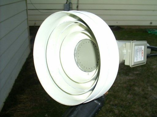

Do you mean C band Perf. may be degraded?
ftarock said:
Ku performance might be degraded if you use it with offset dish due to the mismatch focal length. Remember this lnbf is designed for prime-focuse type. When you put scalar rings for prime-focuse on off-set dish, it will not collect all the signal as it is designed.
Hopefully some manufacture starts thinking to make 3-4 ft solid prime focuse if this lnbf works well.
FtaRock[/UOTE]
Off set dish need a specially designed scalar ring (see below)
Putting this LNBF on any dish smaller than say 6' is a PROJECT and will not give reliable C or Ku signals.

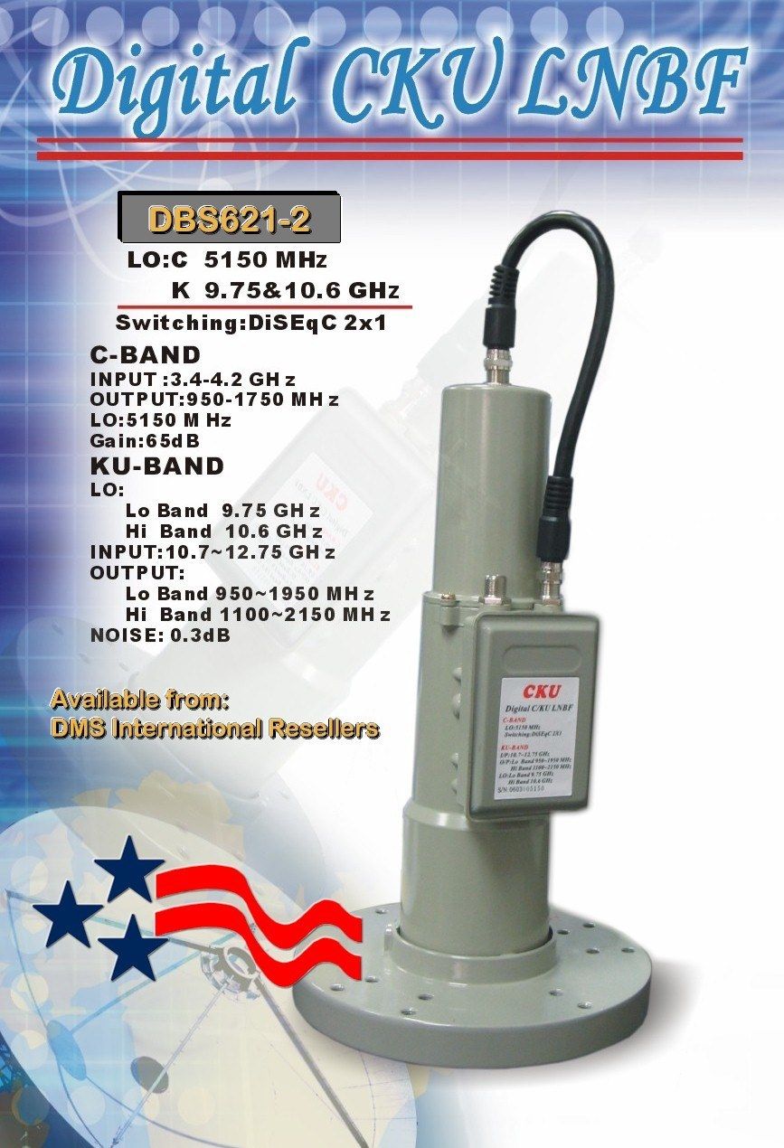

Hi,
Ya gotta love it when ya buy a lnbf and it comes with zero paperwork. I have a DBS621 with the built in 2x1 disque switch. I want to use seperate connections for c band and ku. Now the ku connection in the pic is at the end of the unit, Is the c band connection the one marked "receiver" , bypassing the switch, or is it the other connection where the jumper connects. Pardon my stupidity, it has been a very hot week here and i think me brains are well done!!:hatsoff:
I don't have one, but looking at the picture, I would say the connection with no coax would be the C-band connection, and the one on the end would be the ku connection, while the one next to the empty connector is the input for the ku to use the diseqc switch.
From your written description, I would say the one marked "Receiver" would be used for C-band or for both when used with the diseqc switch
Al.
Al.
Yes, that was my asumption also. the other thing is, it would be nice to know which position on the built in switch is c band and ku bans. Like 1 = ku, 2 = c band. do you need to identify it on the receiver antenna setup, or does it switch automaticly? None of the reviews, or articles clarify this, neither does the manufacturers web site.
Interesting thought, whether it's automatic or not? If you decide to try the diseqc switch, I guess you'll have to play with it and see if it works on port: none, #1, or #2, in the receiver's settings. And also, which L.O. setting to use: 5150, 9750, 10600, or 9750-10600 with each port setting you use. It will only work if it receive's a signal, and the port and L.O. setting's will have to match for this to happen. I think? Don't know if anyone has tried to use the diseqc or not? I think most have probably use them as separate outputs to another switch, multi-switch, diseqc, 22k, etc.
Al
Follow the picture on the box and connect the short cable as shown. The receiver port is what you connect your rg6 cable then run it to your receiver. Then in your menu, all of your c-band sats. will be diseqc #1 and the ku side has to be set at diseqc #2. No in-line diseqc switch is needed, however if you have another dish (aimed at something else) and are using an external diseqc switch then you need to connect the extra dish in port #3 of the switch and in your receiver menu you select #3 for the extra dish. If you are doing this, you can run the rg6 from the output on the lnb into port #1, but leave port #2 empty on the external diseqc switch.
