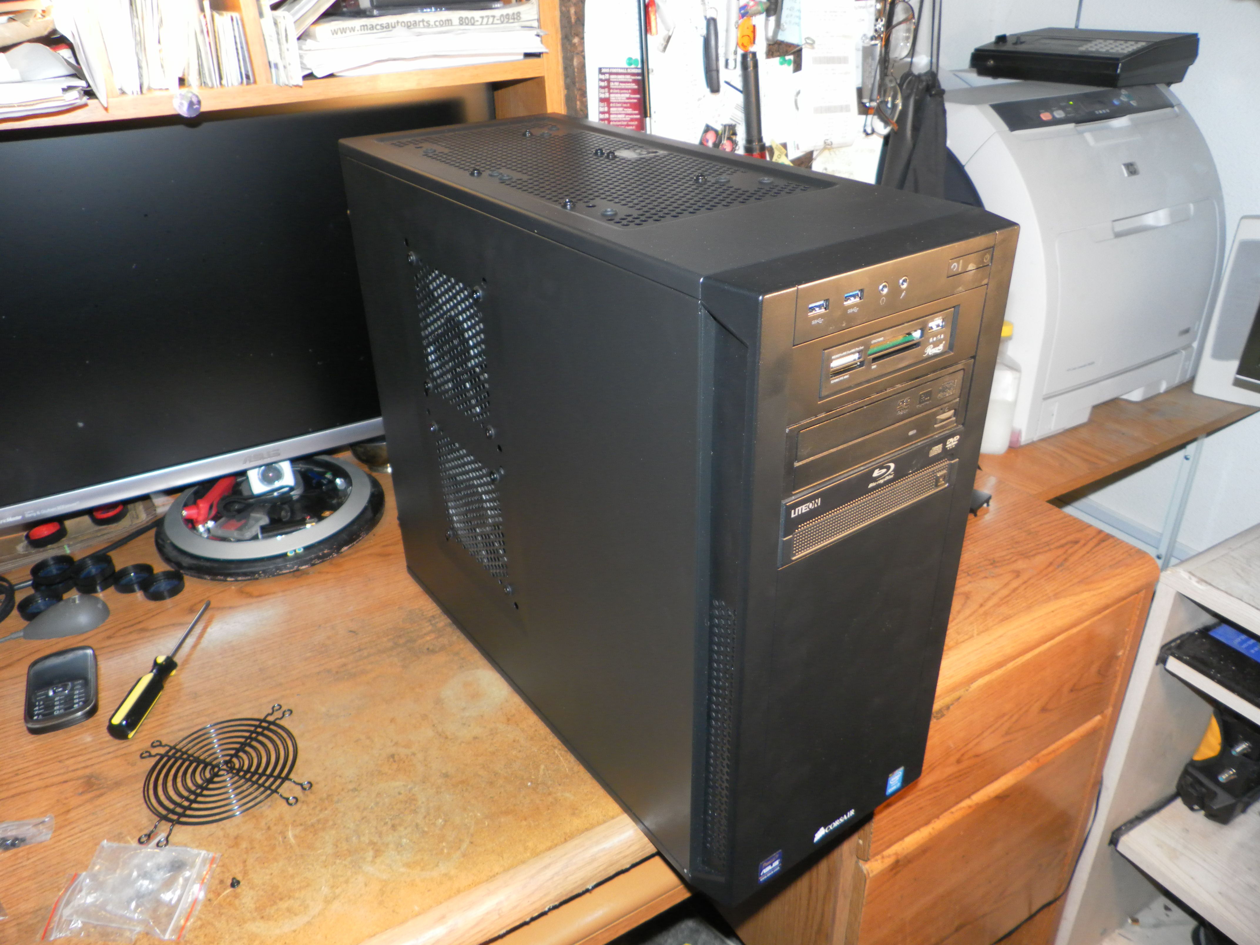

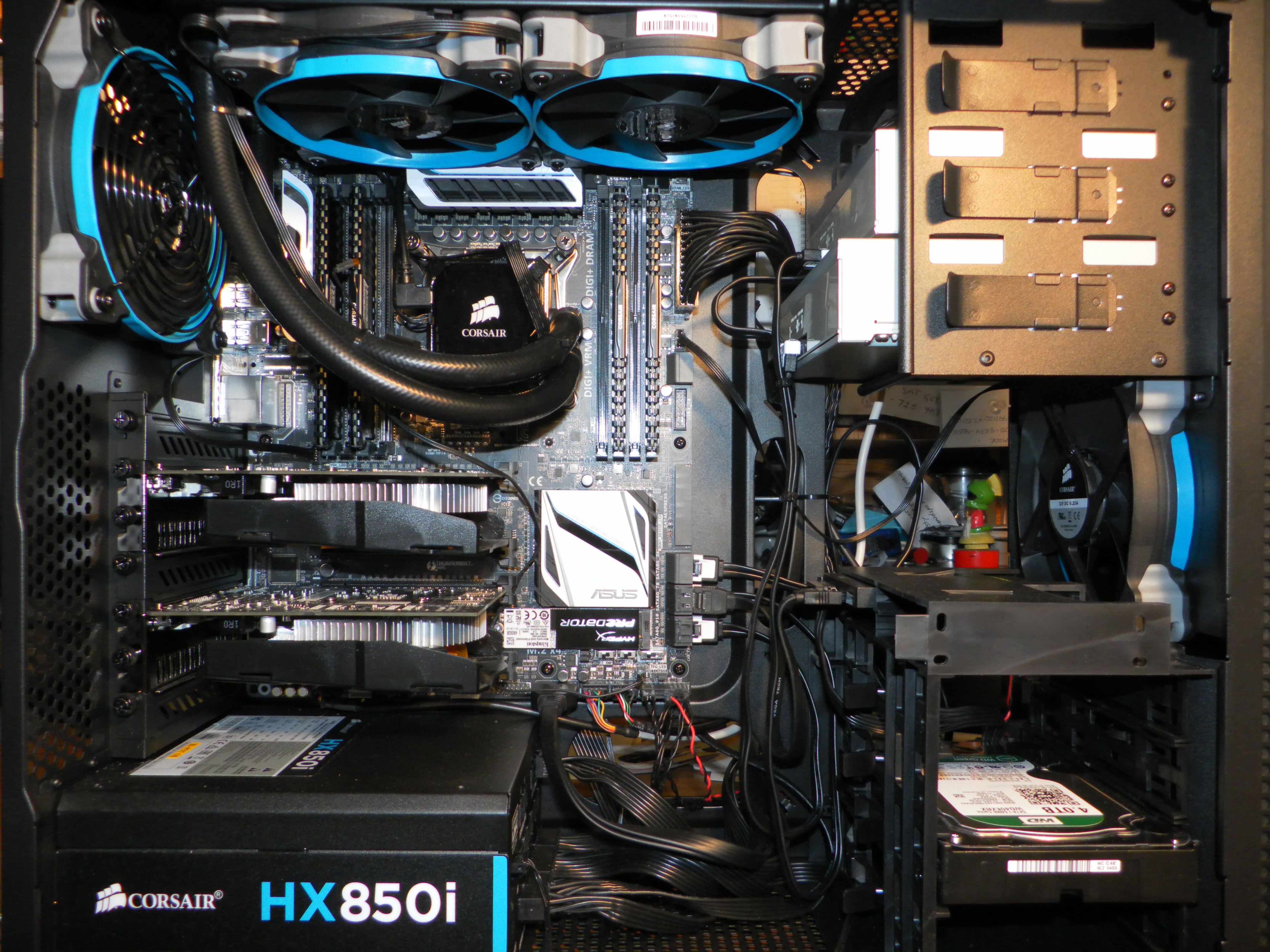

I have a pile of new and interesting parts here. :) Every thing I need to build my new machine, except the case :( I went with an ASUS X99-A USB3.1 Motherboard, Core i7 5820k cpu, HyperX Predator M.2 (2280) SSD, 32g Corsair Vengeance LPX DDR4 quad channel kit. Corsair H100i water cooler. :) One nice thing about the MB is the serial port. My current machine doesn't have one and I miss it.
That H100 is LOUD! You may want to replace the fans.
I had a feeling I might want to do that, I'll check out the software on that setup and see if it can be controlled a bit. I have a pair of Enermax "bat wing" fans that are quiet on a shelf :) You should see the video at Corsair of their guy putting 40 high performance fans on that radiator. Clocked CPU 4.6g at 100% load cooled to -19°C. I'm like "No way!" During the demo the guys claims several times he can't hear the fans, yeah all 40 of them ;)
Well I can say the H100i is inaudible right now and the CPU is room temp 80° :) fans are spinning less than 1000 rpm. The power supply fan is not needed at the moment and is 0 rpm . So I think I can clock this thing pretty good and still remain cool. I may get away with only two fans on the radiator as I have now. :) I have some more PWM fans coming tomorrow and I will replace the case fans with those as well. I'm running Win 7 and the WEI is 7.9 :) no OC yet.
The ASUSTek X99-A USB 3.1 Mother board is way cool. The Graphical mouse controlled BIOS is full of great options. You can fine tune the cooling system, the power consumption, and OC this one with one click. Runs like a race car when I need it and puts along like a moped when I don't. The Corsair H100i water cooler handles the CPU with no problems. Barely running it at all :) With PWM fans I'm running about 700 rpm on the four case fans and 900 on the CPU fans. Everything below 35°C and the CPU never goes over 31°.
Reactions: StevenD
