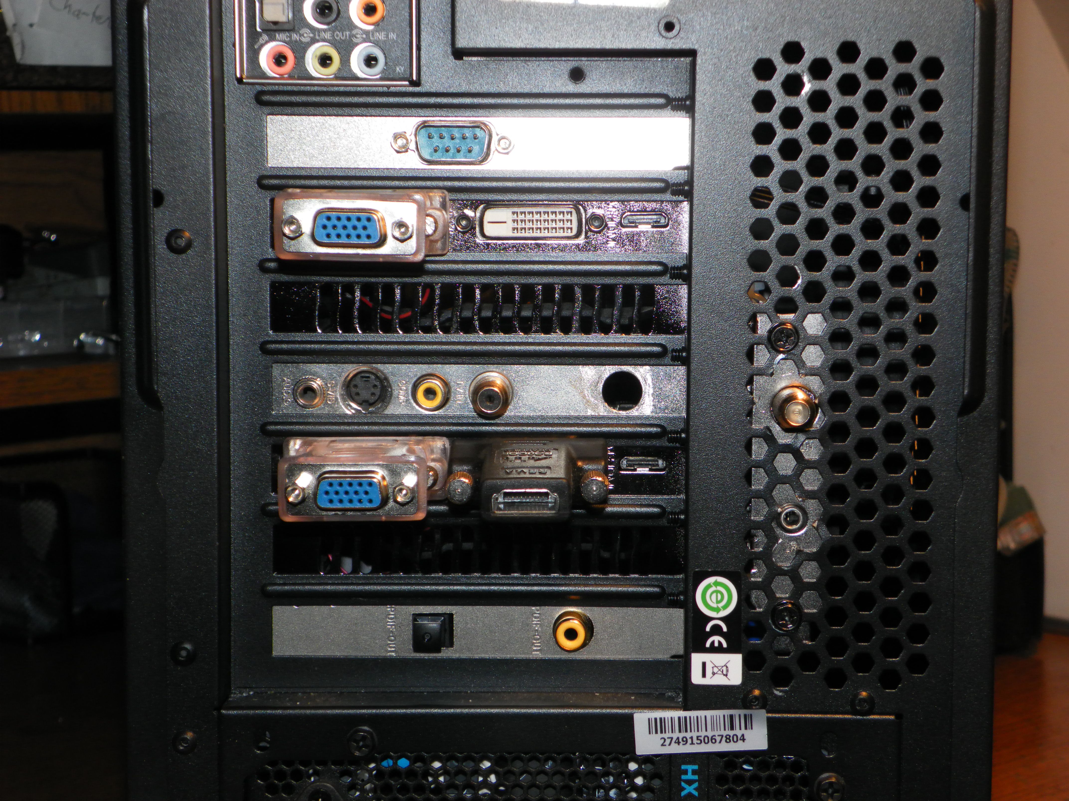

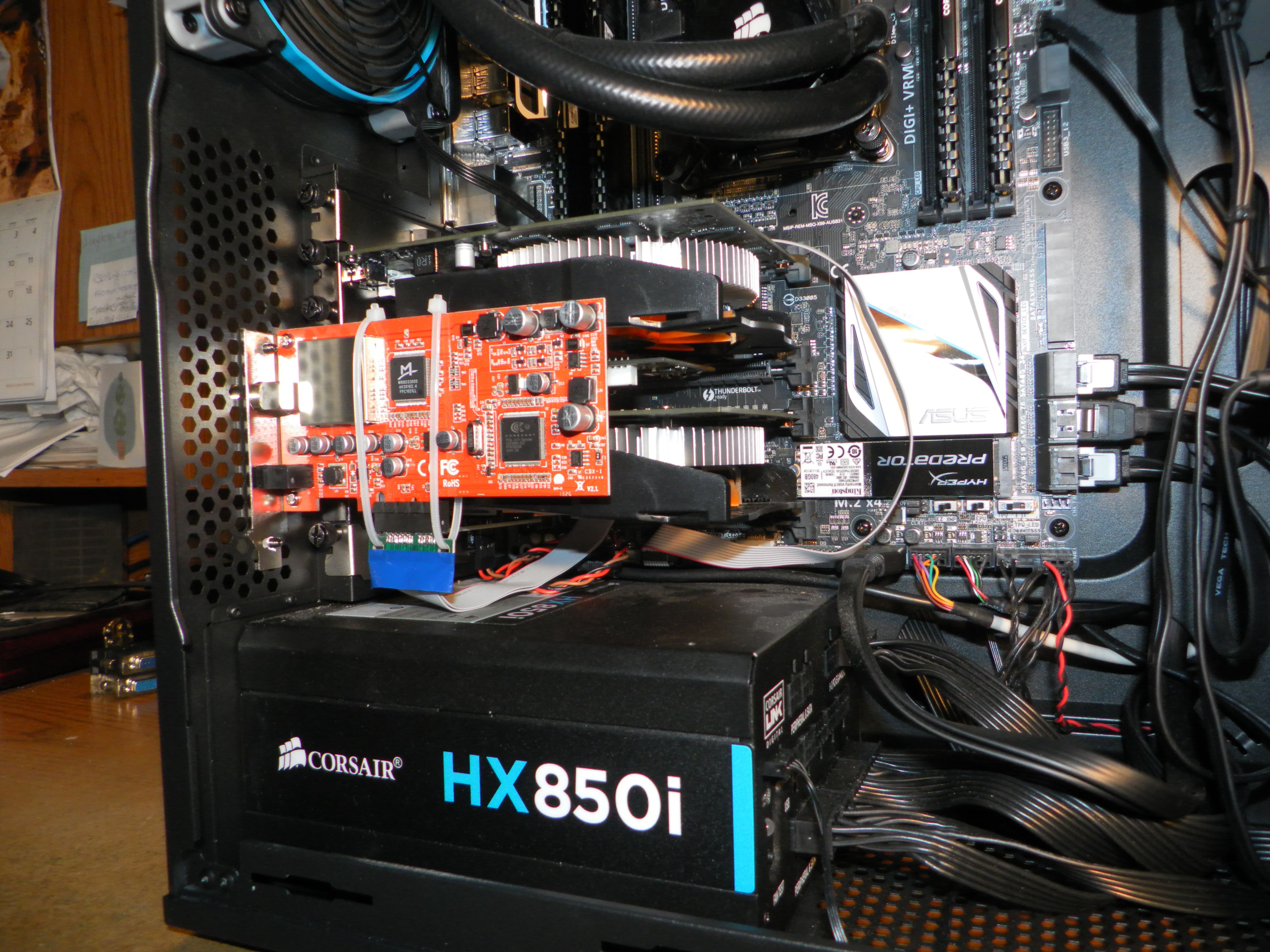

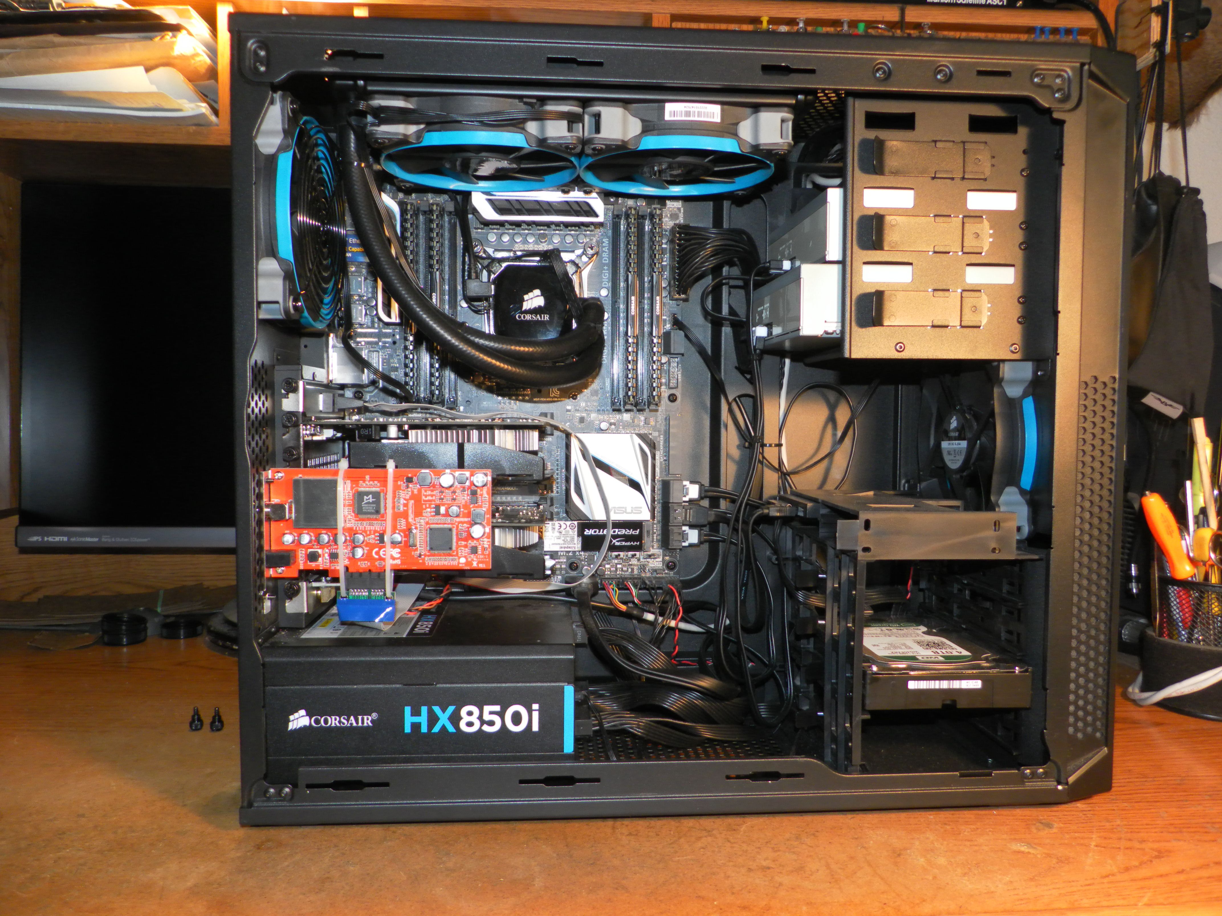

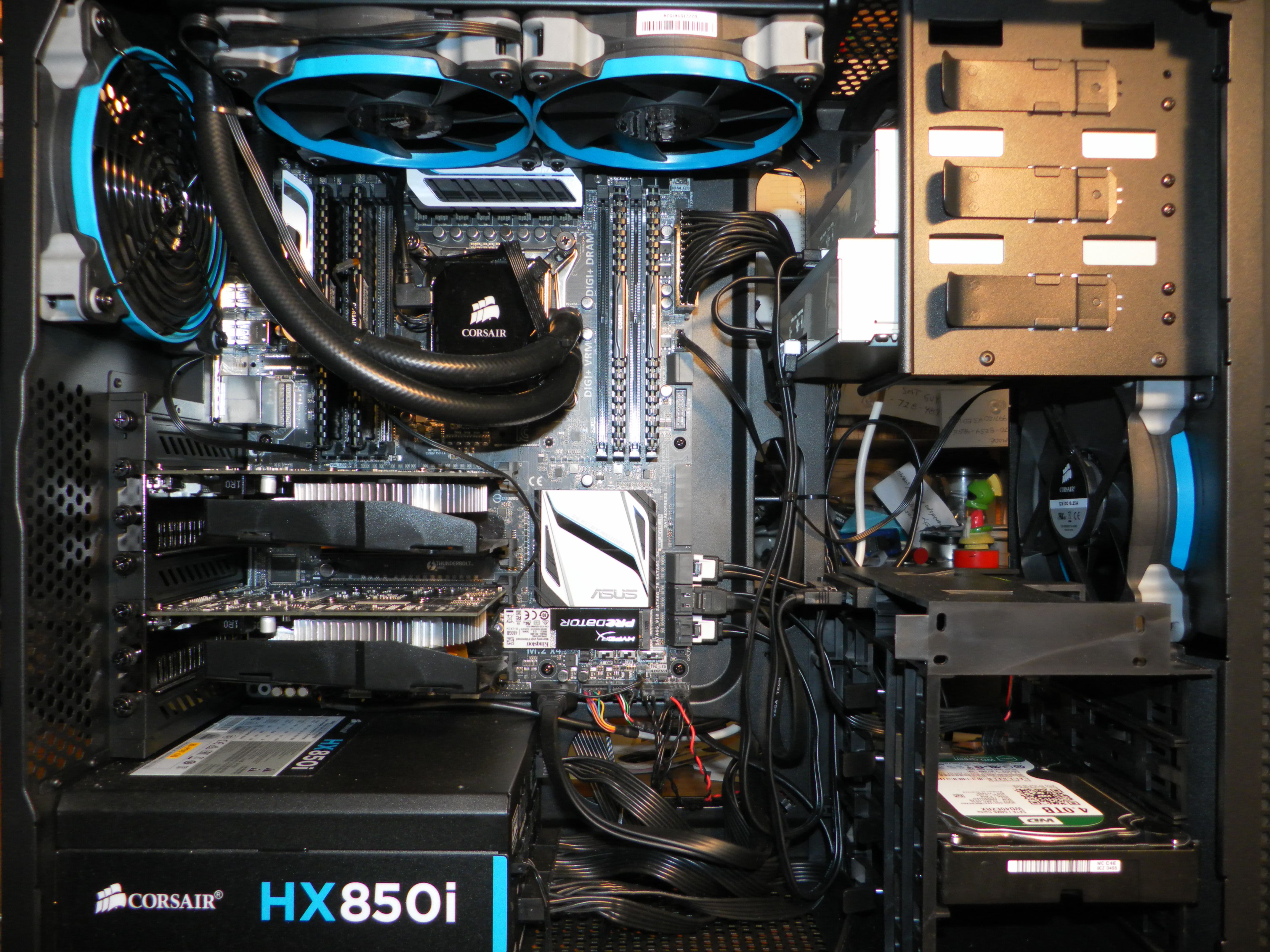

Having two video cards has restricted my access to the other PCIe slots. There are six slots on the board. The bottom slot is deactivated because I'm using the M.2 SSD port. Each double decker card uses a PCIe x16 slot and covers the only two PCIe x1 slots. That leaves one PCIe x16 slot available and anything in that slot will restrict airflow to the top video card fan. I thought I would be OK with using USB tuners for the HTPC portion, but the USB tuners were terrible. So I bought some PCIe x1 extension cables. I put the ATSC tuner in the one accessible slot and am monitoring heat issues that may come up. I remotely mounted the DVBS2 tuner using the cable. So far it's good :)
