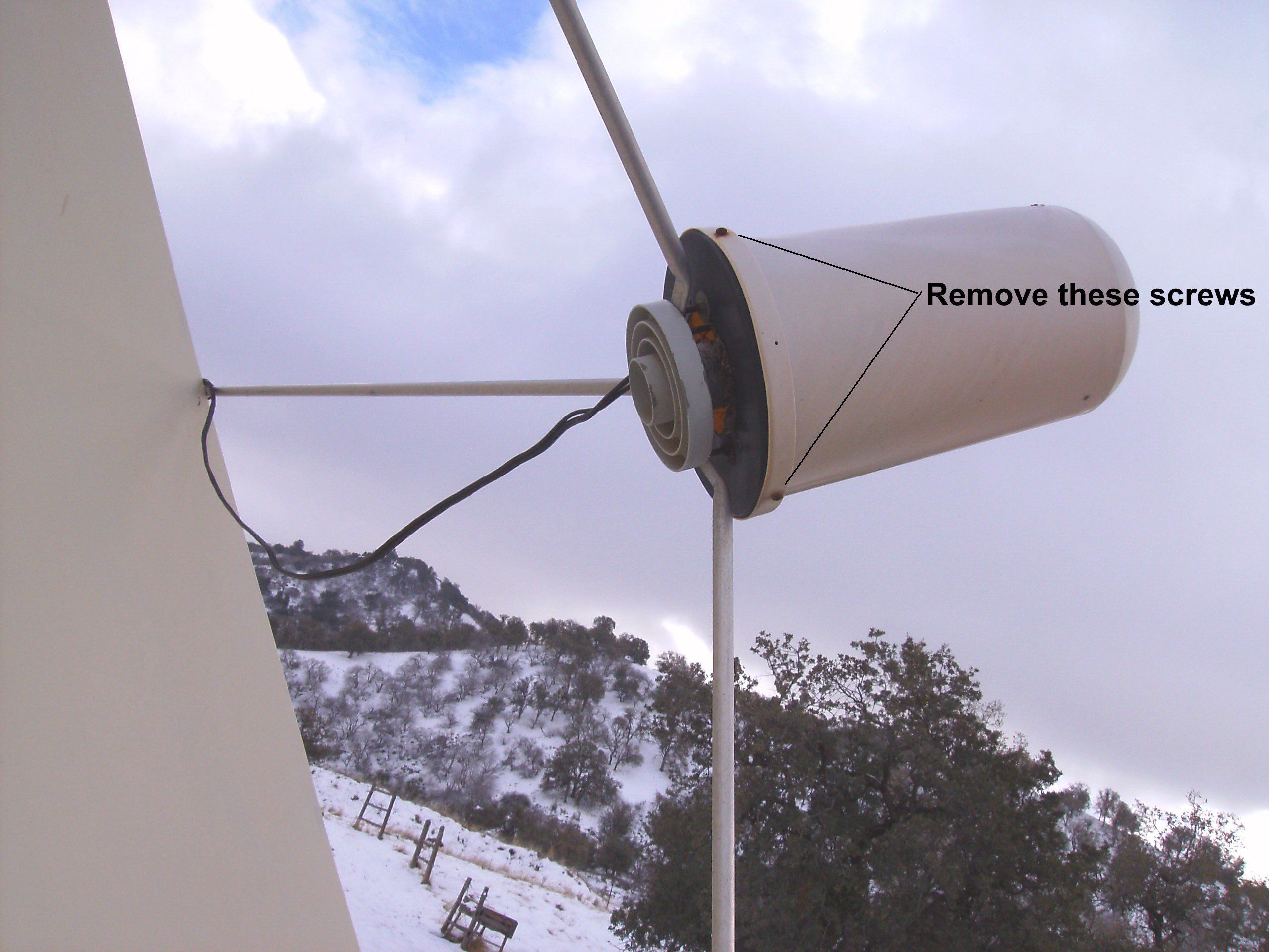

Here's my assessment. The dish looks like a spun aluminum it has a 18" Houston Tracker arm and a probably a PR1E or PR1AS Chaparrel feedhorn. What you need to do next is remove the nose cone and get pictures of the electronics inside. Also try to run a tape measure from end to end on the reflector and see how big it is. Im thinking it's a 9 footer. That was a popular size in spun's

It's not a beast it's a thing of beauty :) There are guys out there that would kill for a good spun aluminum. That thing would be killer on ku band. I think the next thing you should do is remove the cover on the feed (nose cone) to see what the electronics look like under there. That will allow us to see if you need a new LNB or servo motor. Then you would have to hook up a receiver to it to see what's what.
Just think when you do get it running what a conversation piece it will be :) Get the ladder and screwdriver out and take off the nose cone and get some snaps.
I modified your picture to show you what screws to remove there is 3 or 4 of them.

So I take it that it IS aluminum?? I will try to get out there and see if I can unscrew those screws and take some pics. I don't own the house YET, but will very soon. I think I can take the nose-cone off though, take some pics, then screw it back on without anyone being the wiser!:cool:

This is a C-Band Dish. (As already stated) If you get lucky it will have a C-band lnb and a KU band lnb. This is both type of signals. So nothing to do if you have both. That is great.
(Before doing anything. We would need pictures of the inside cover) This will tell us if you have both and what way to go. Below is some options for you.

I see one coax and the polarotor cable going into the "nose-cone" -it's probably C-band only.:)
I saw that too, I'm thinking its a Chaparral PR1E or possibly a PR1-AS. I can't tell from the picture if it's adjustable scaler or the economy model. Since the arm is a HTS I'll bet it has a Echostar LNB and originally was connected to a HTS or Echosphere receiver. Back in the day the distributors used to sell packages to the dealers that had the same brand components for the most part.
