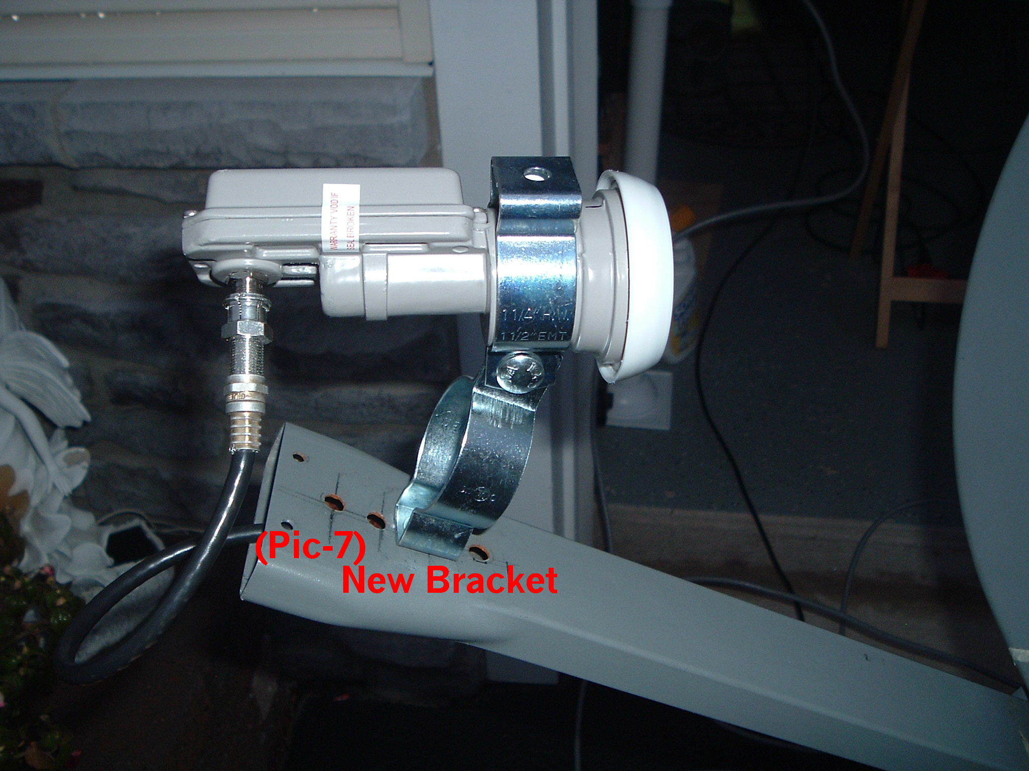

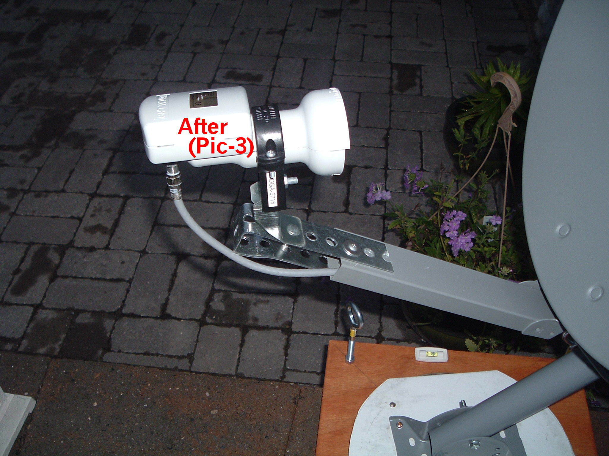

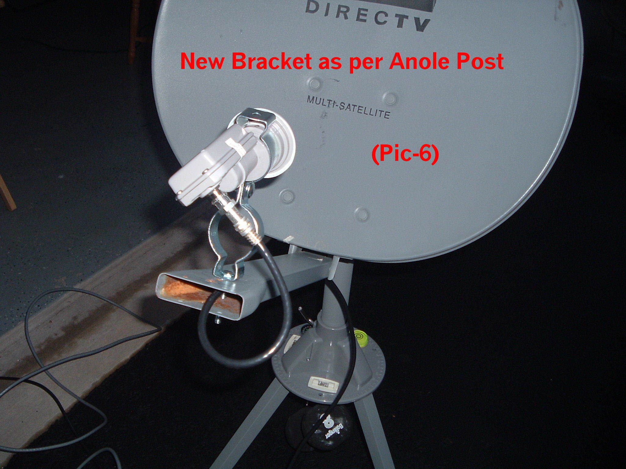

I purchased a new Chaparral all metal Universal KU LNB, which performs well. I built a new bracket as per Anole directions and information (Pictures 6, 7)

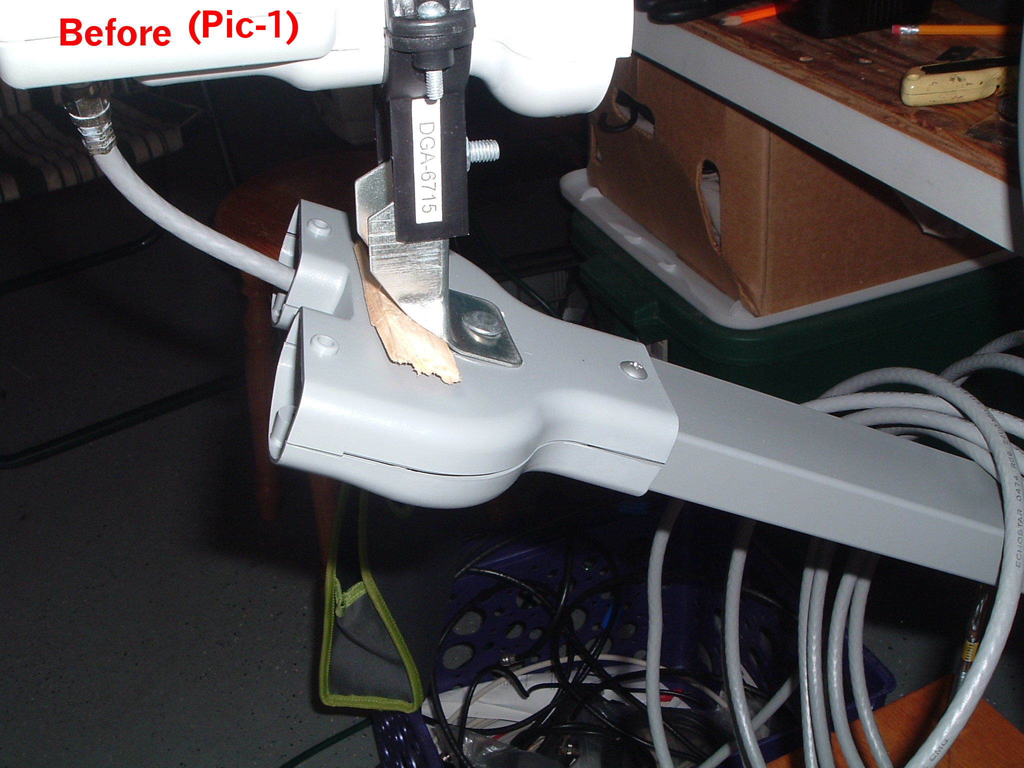

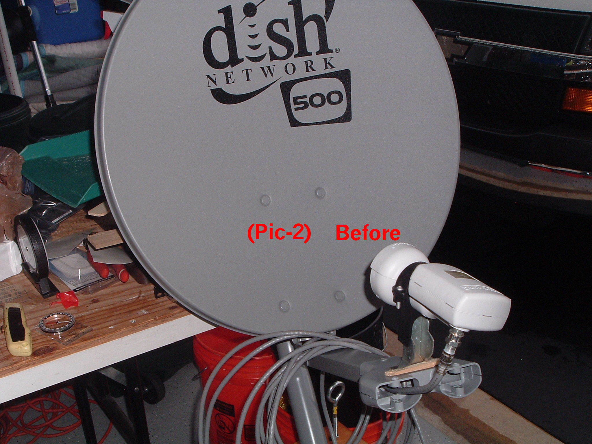

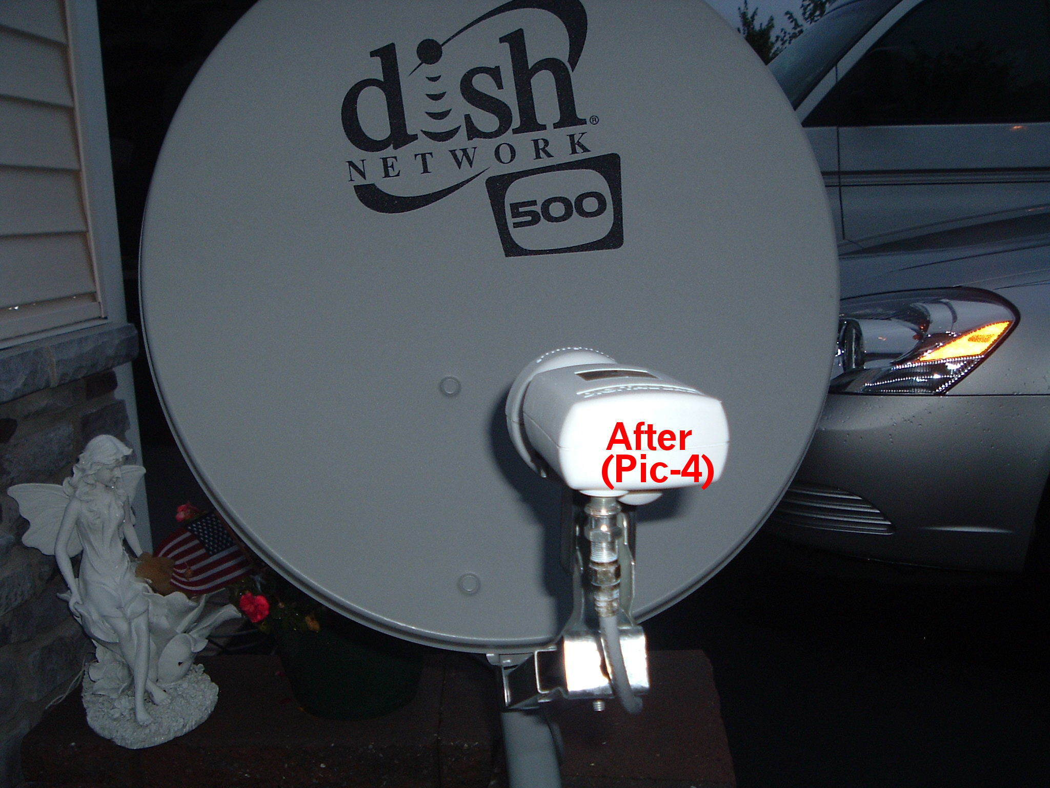

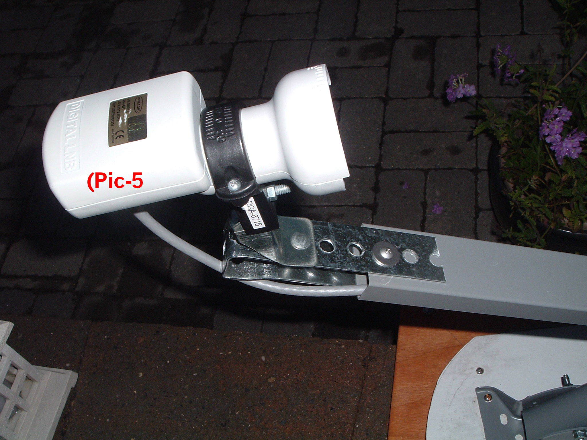

I also fixed up the front of my 500 Dish arm and bracket. The before picture will show that I had drilled through the plastic yoke to mount the LNB holder. I removed it and rebuilt and extended the metal arm. (Pictures 1 to 5)

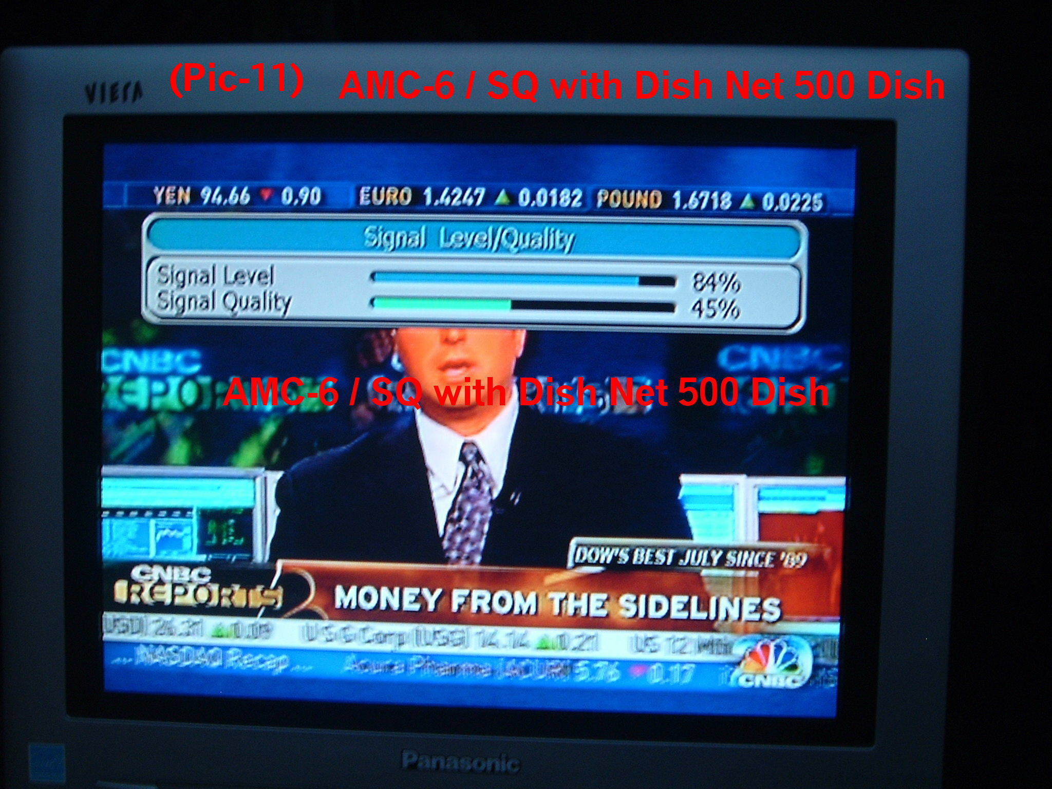

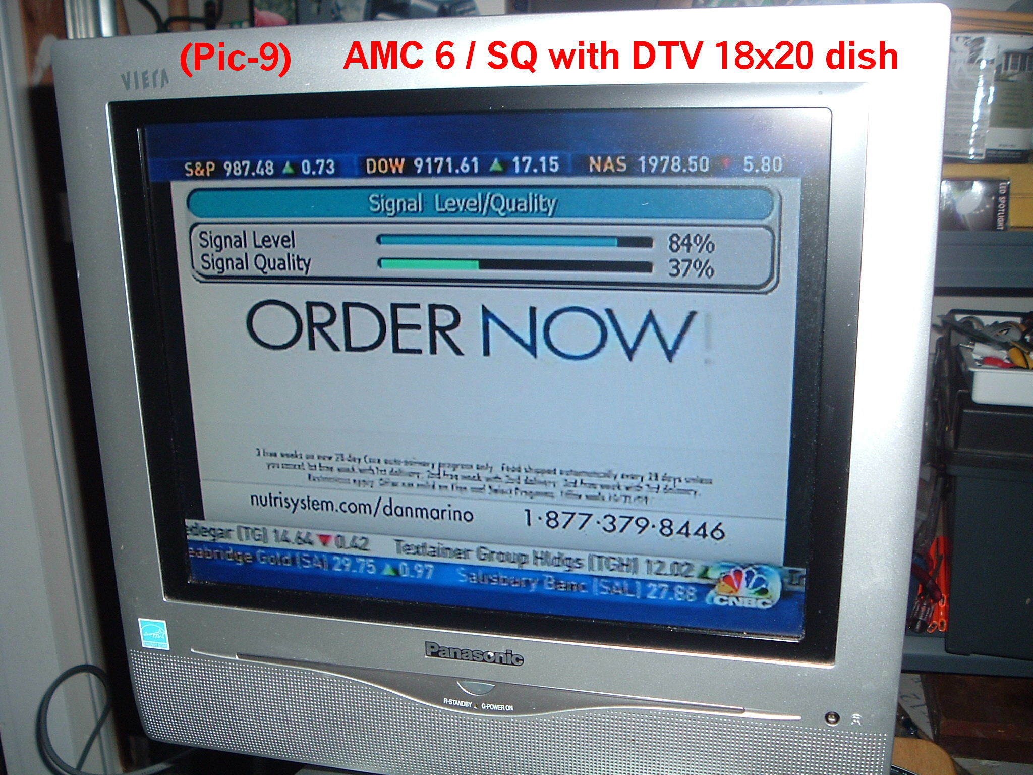

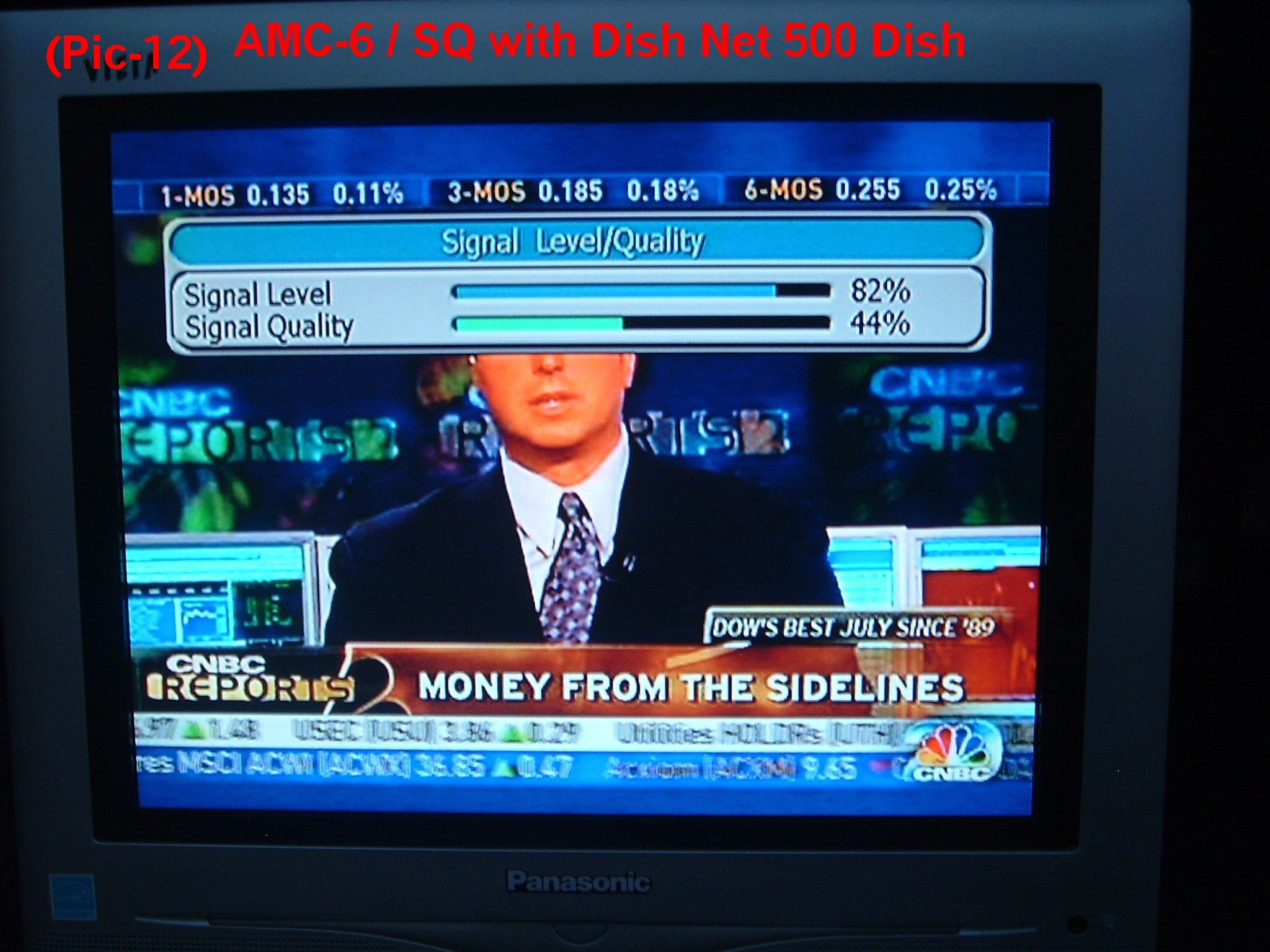

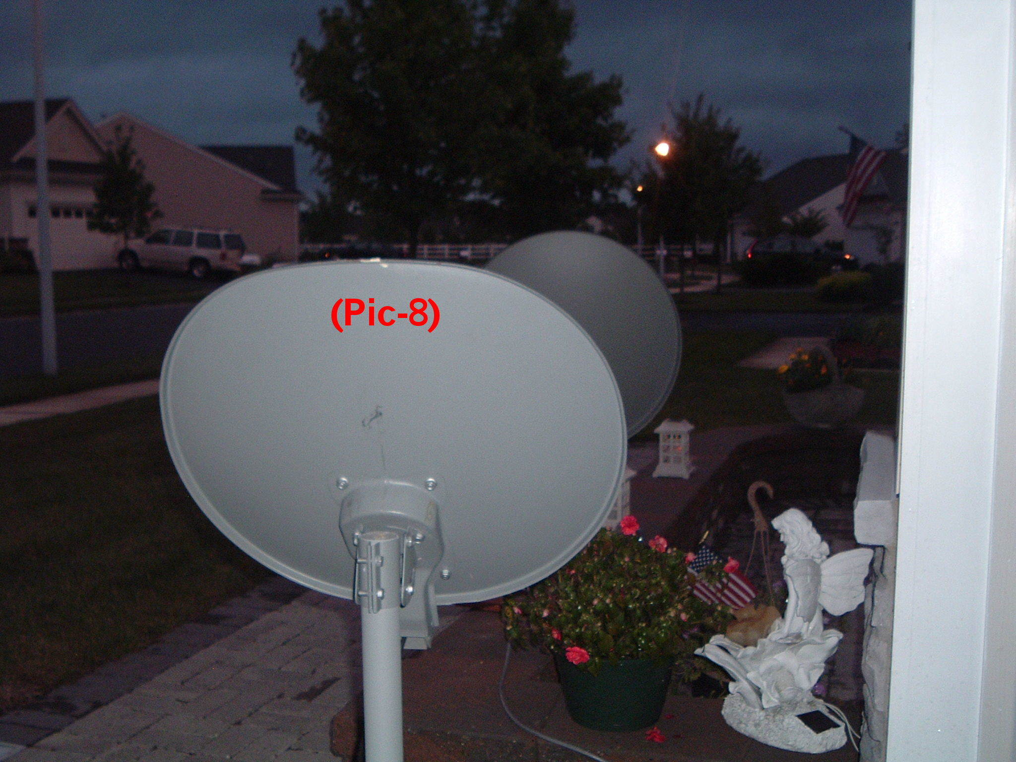

It was a nice night (Picture 8) and I decided to set up the 18x20 DTV and the Dish Network 500 dish and check the signal quality using the mux on AMC-6.
I tuned both dishes to give maximum signal quality, and I used the Invacom SNH-031 LNB on 500 dish and the new all metal Chaparral LNB on the DTV dish, I found that the performance for both LNBs are about equal. This little experiment does prove the bigger the dish the better the signal. (Pictures 9 to 12)

coming clean:
Actually, you built the bracket design by z4ccamaro.
I took a little liberty with his idea.
... but did put mine on a DirecTV Phase III dish with an Invacom! - :D

Looking at your pictures, it looks like that LNB is just too close to the Dish 500 reflector.
Template trick to locate new LNB at the proper focus, when replacing it:
http://www.satelliteguys.us/free-ai...ert-superdish-true-fta-use-2.html#post1540313
