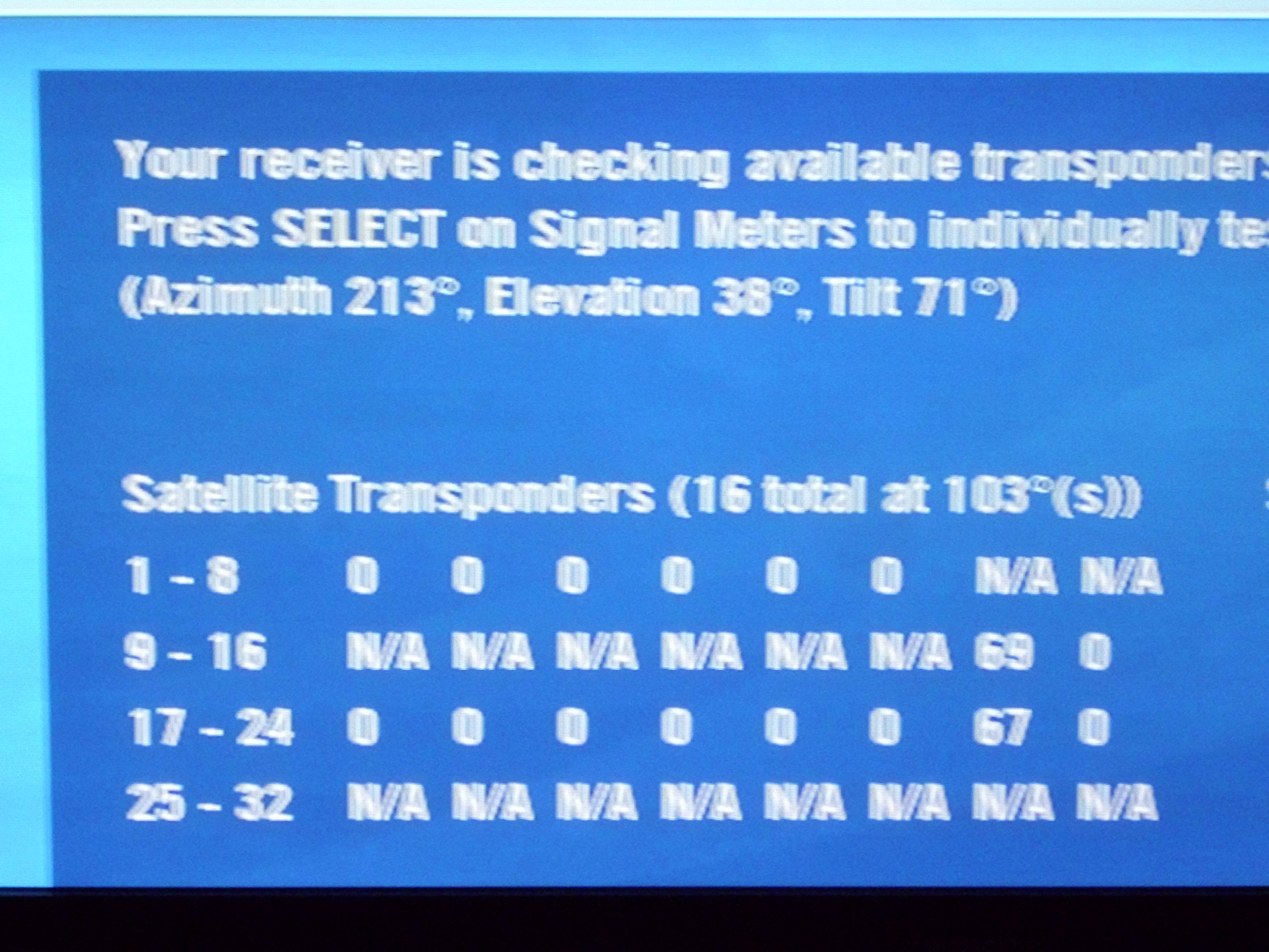

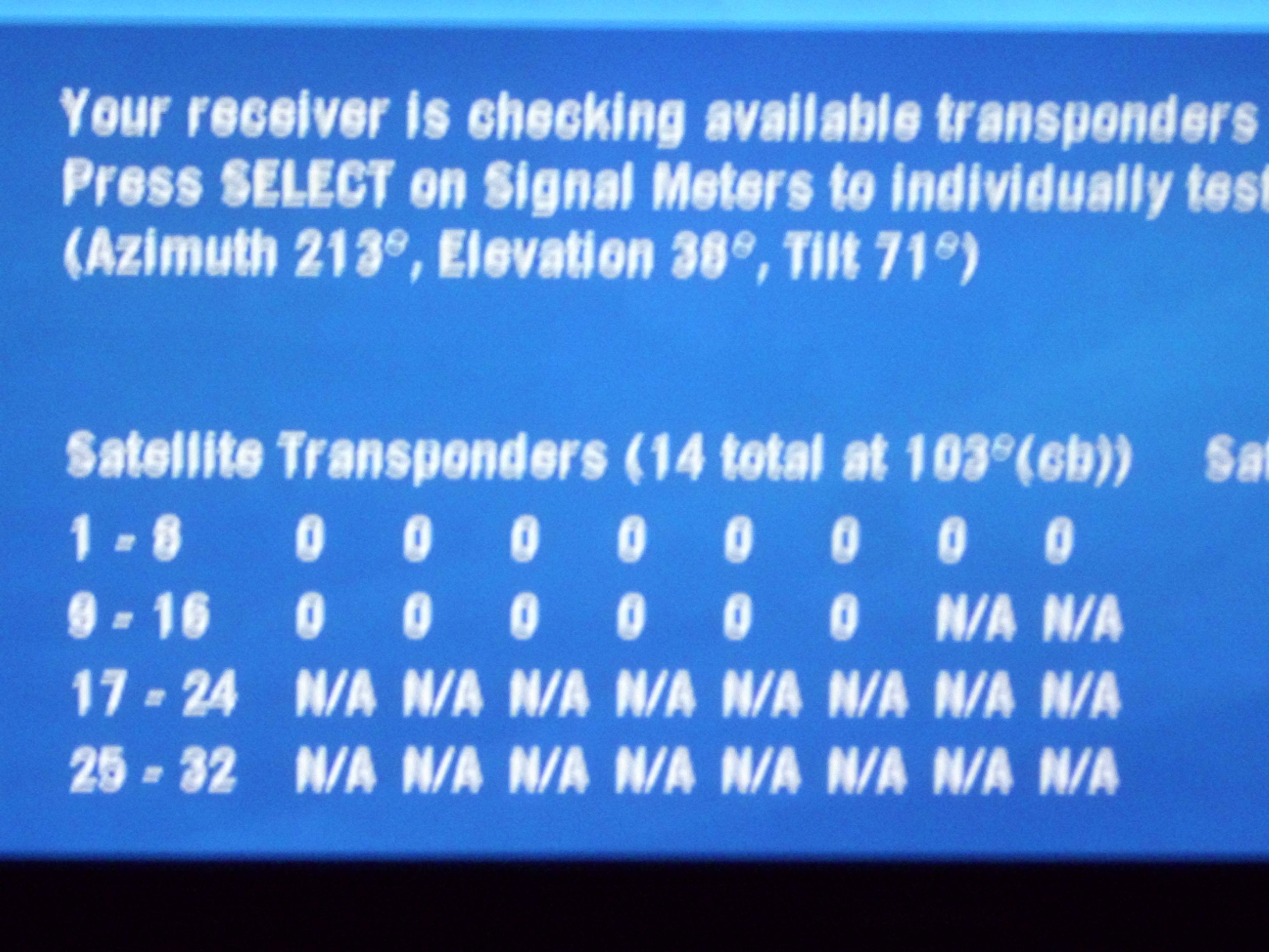

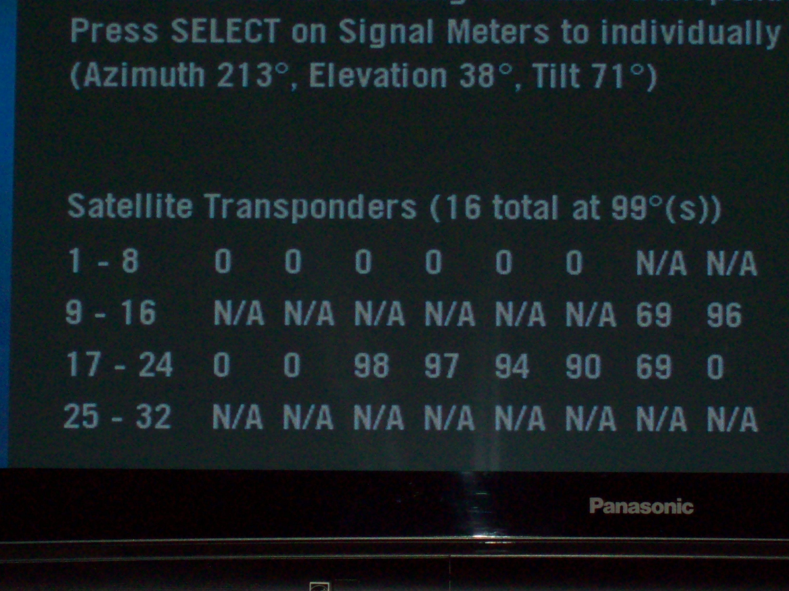

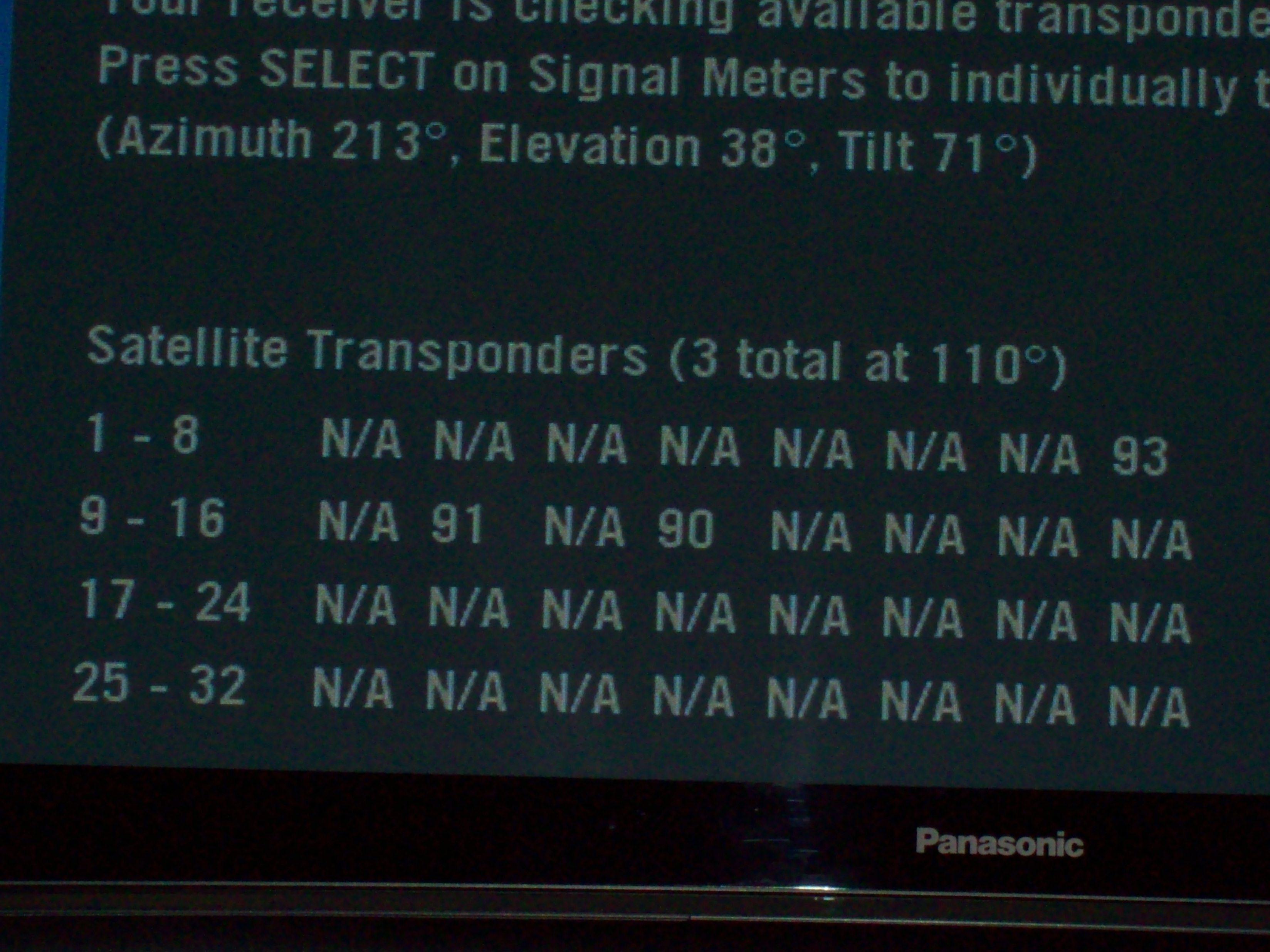

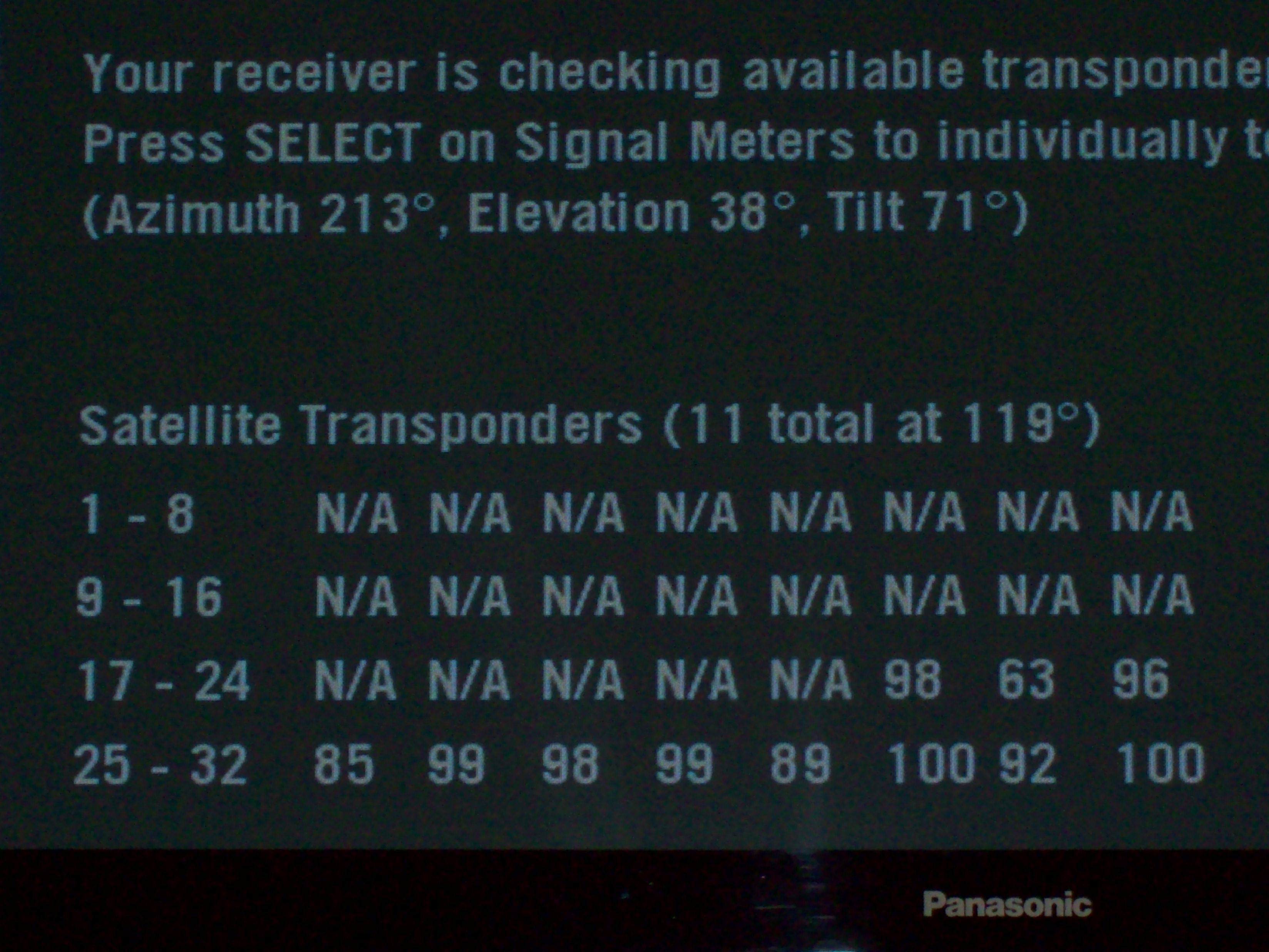

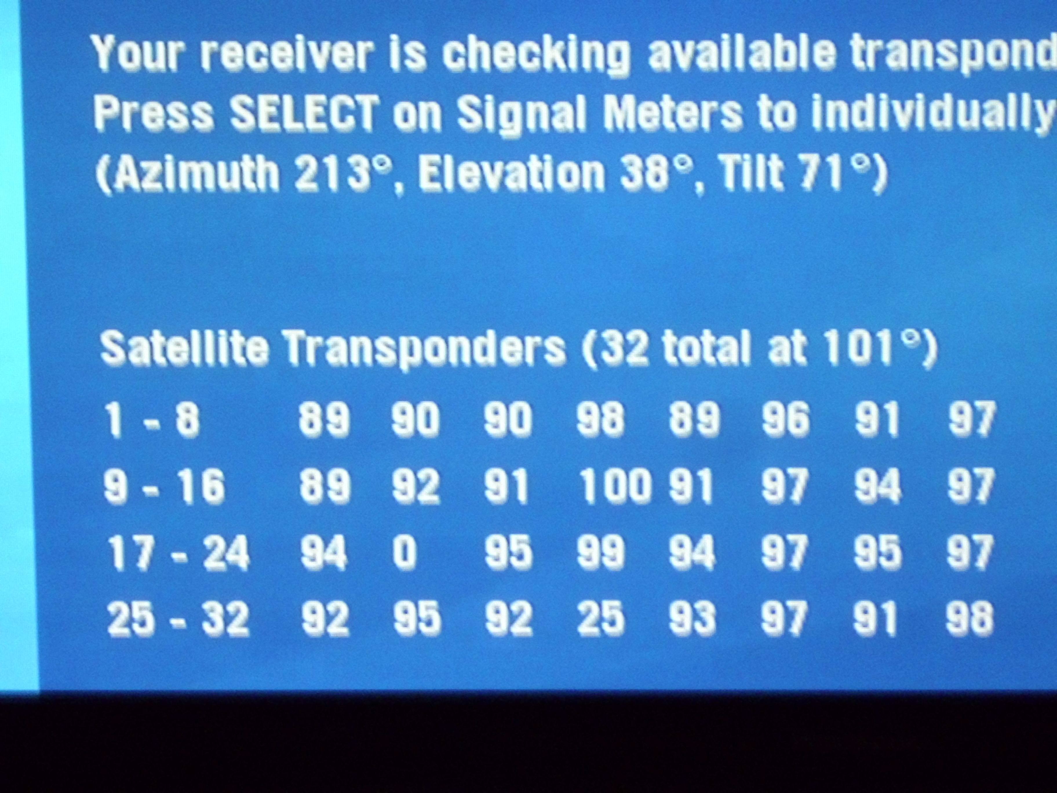

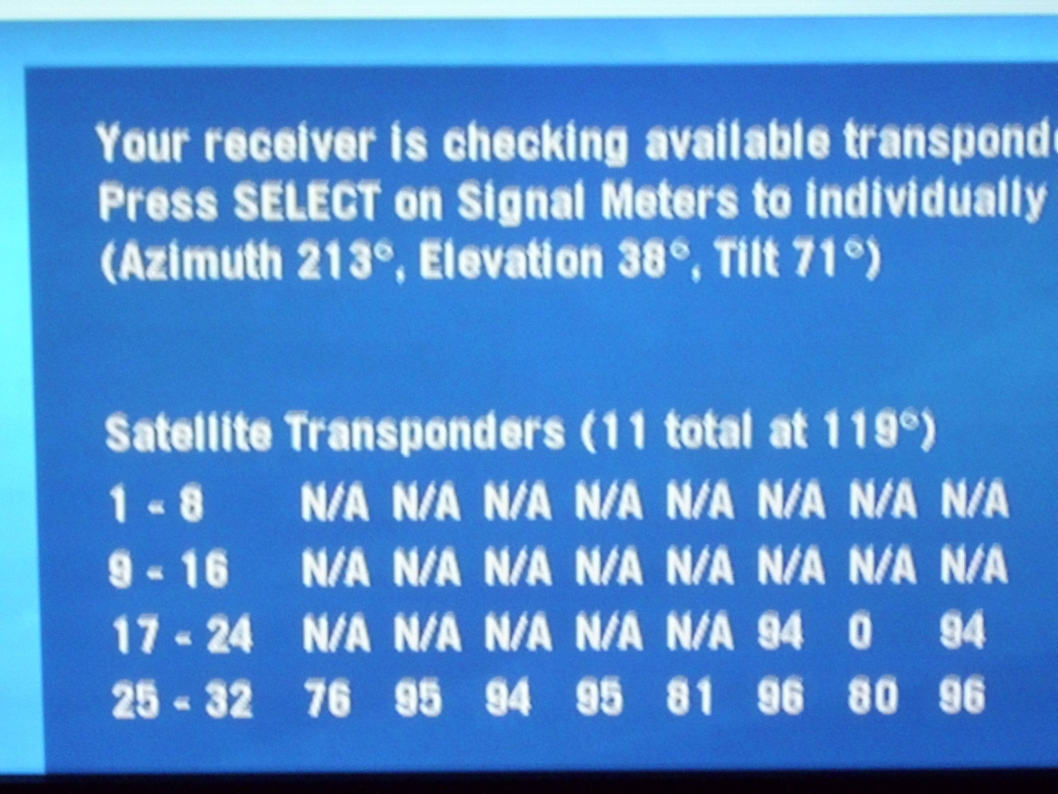

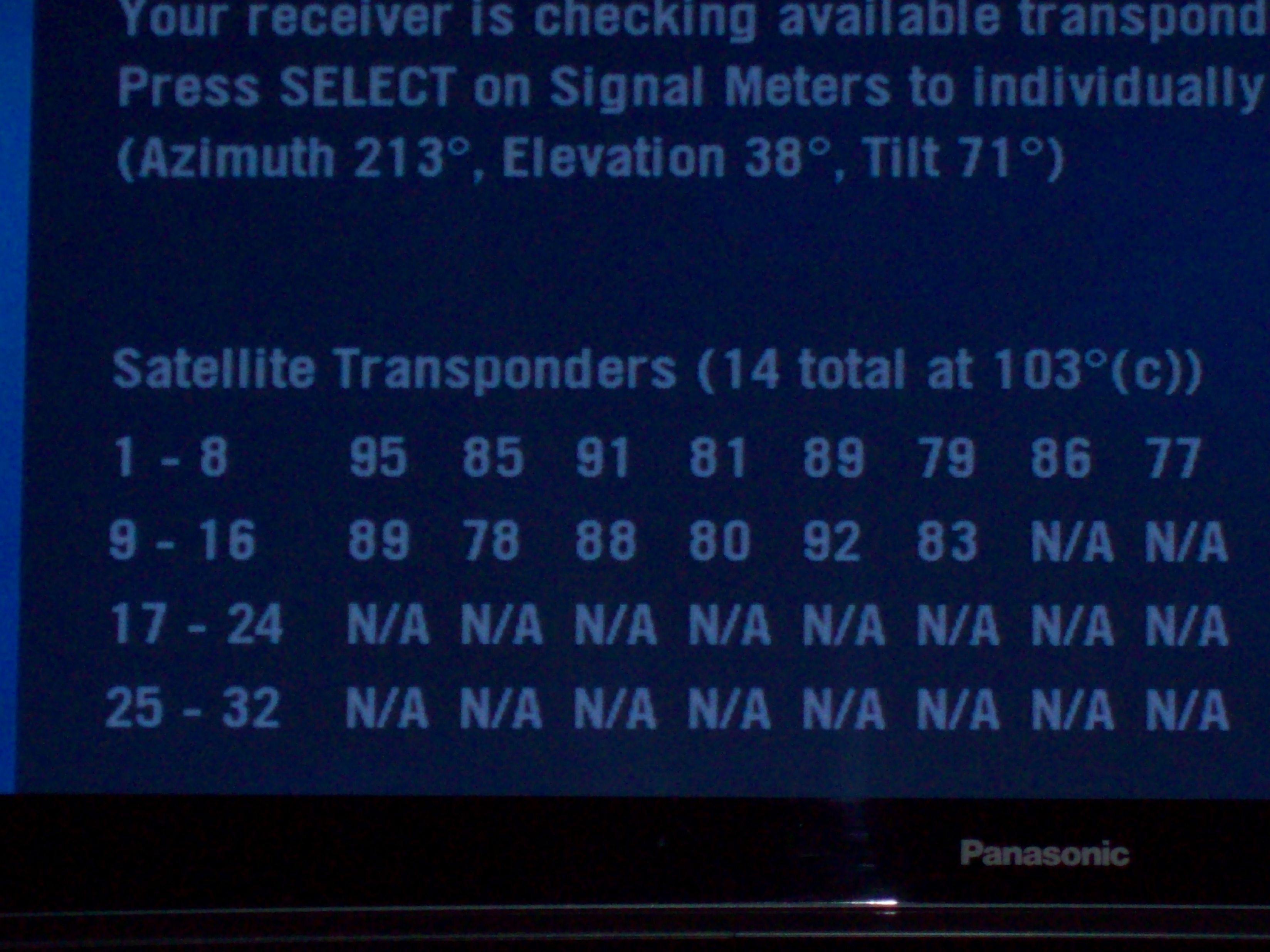

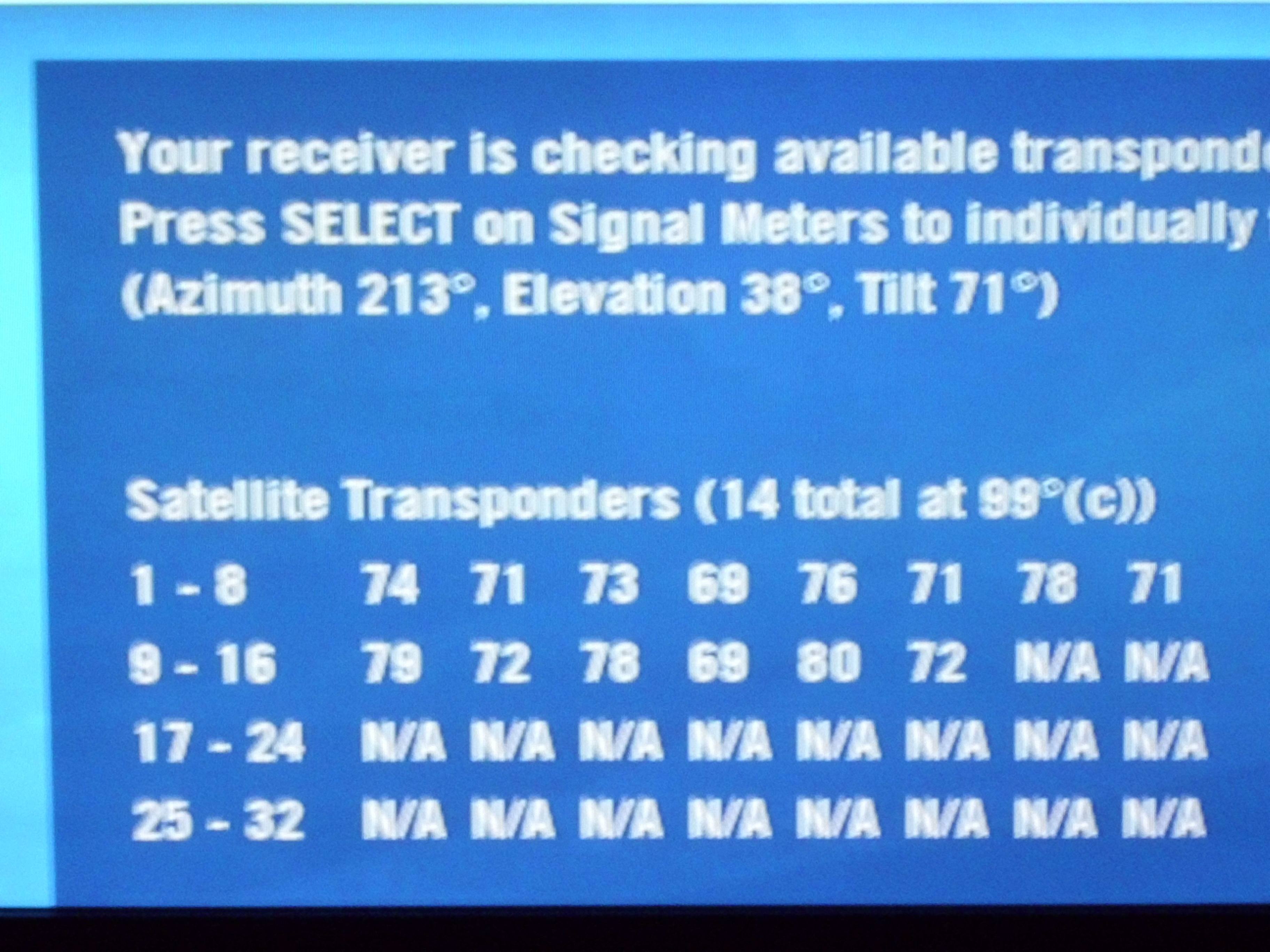

Can you post all of your signal levels?

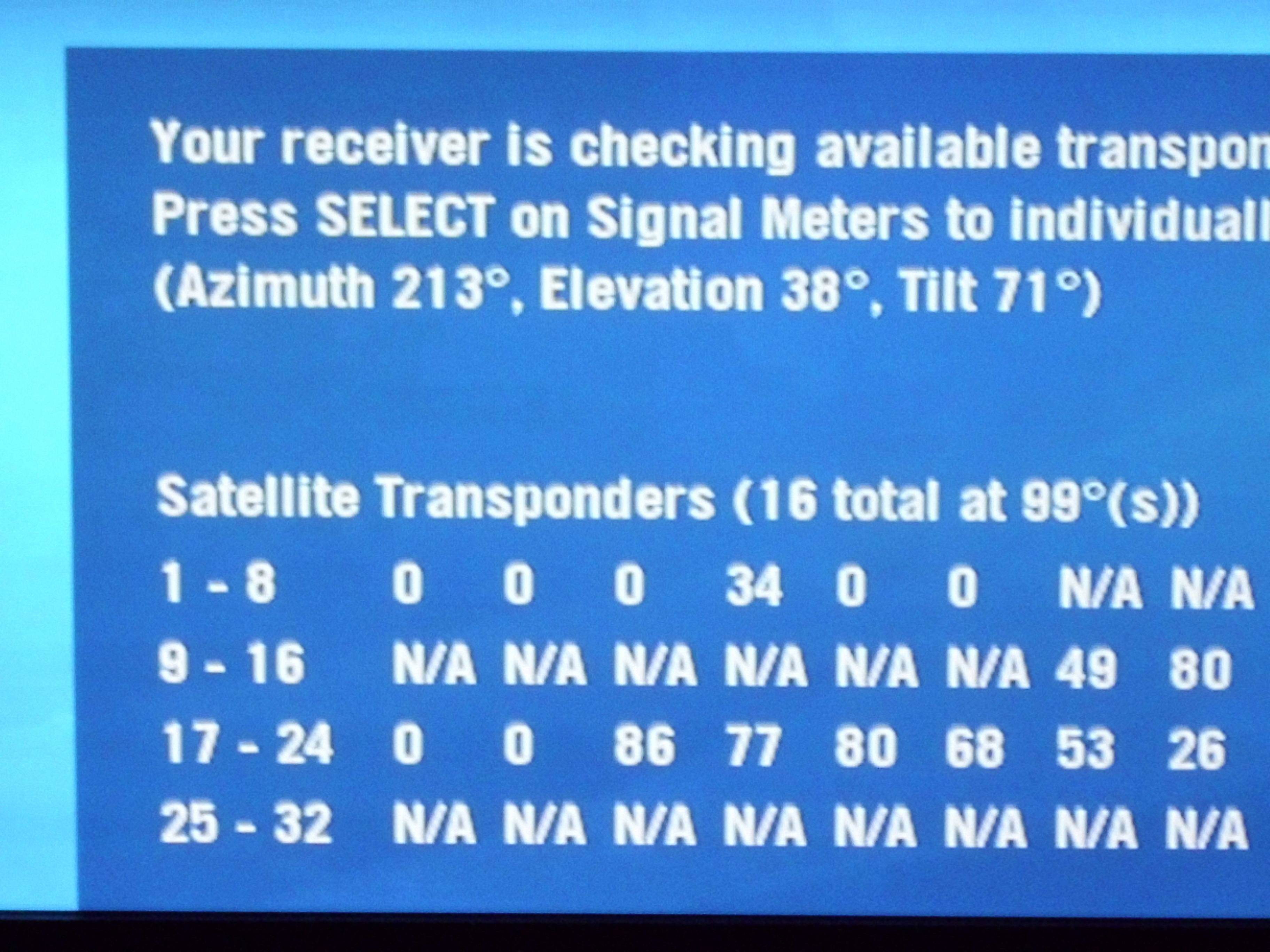

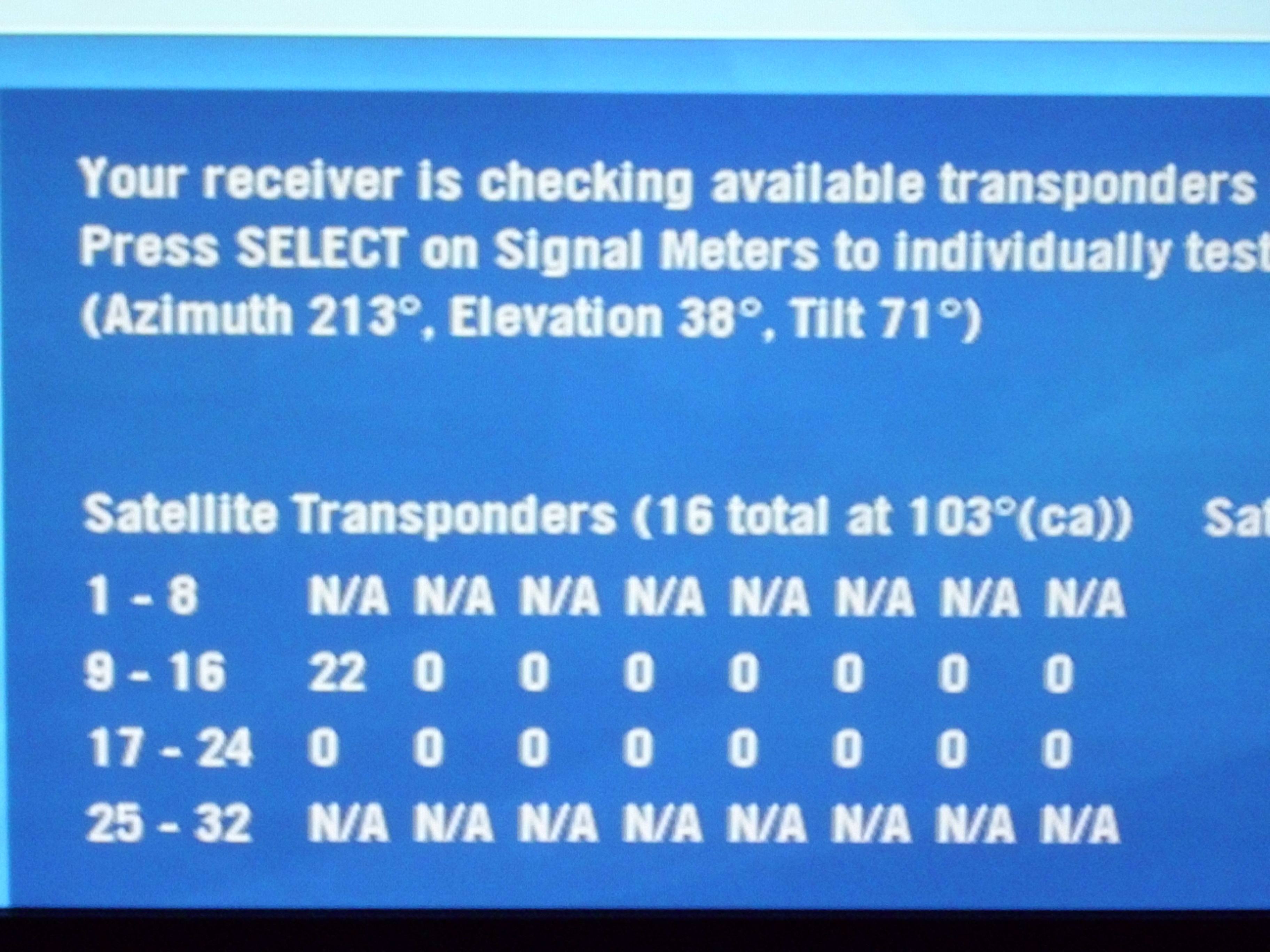

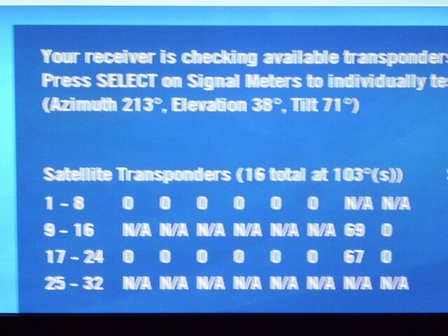

Will do raoul ... just got back from vacation. One thing though .... all sats are there, even and odd, with the 99 & 103's (odd only) at low levels. NO 103 evens at all. I'll post my levels.

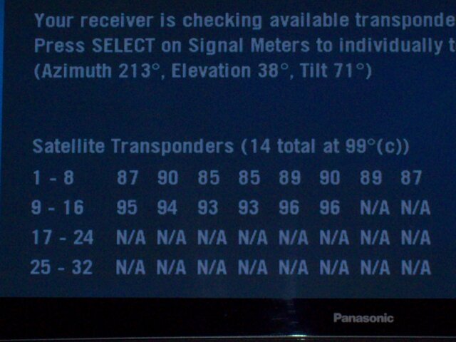

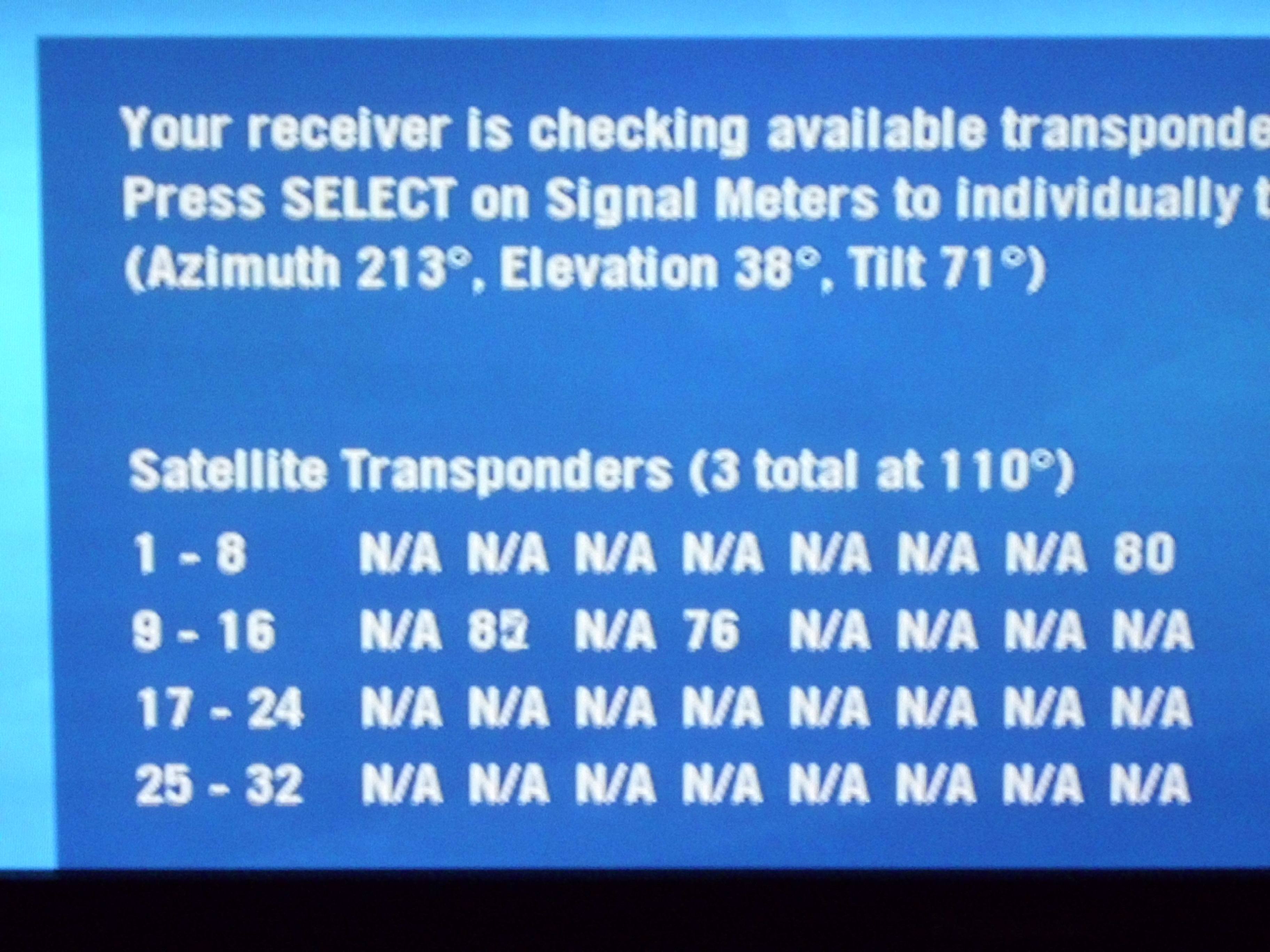

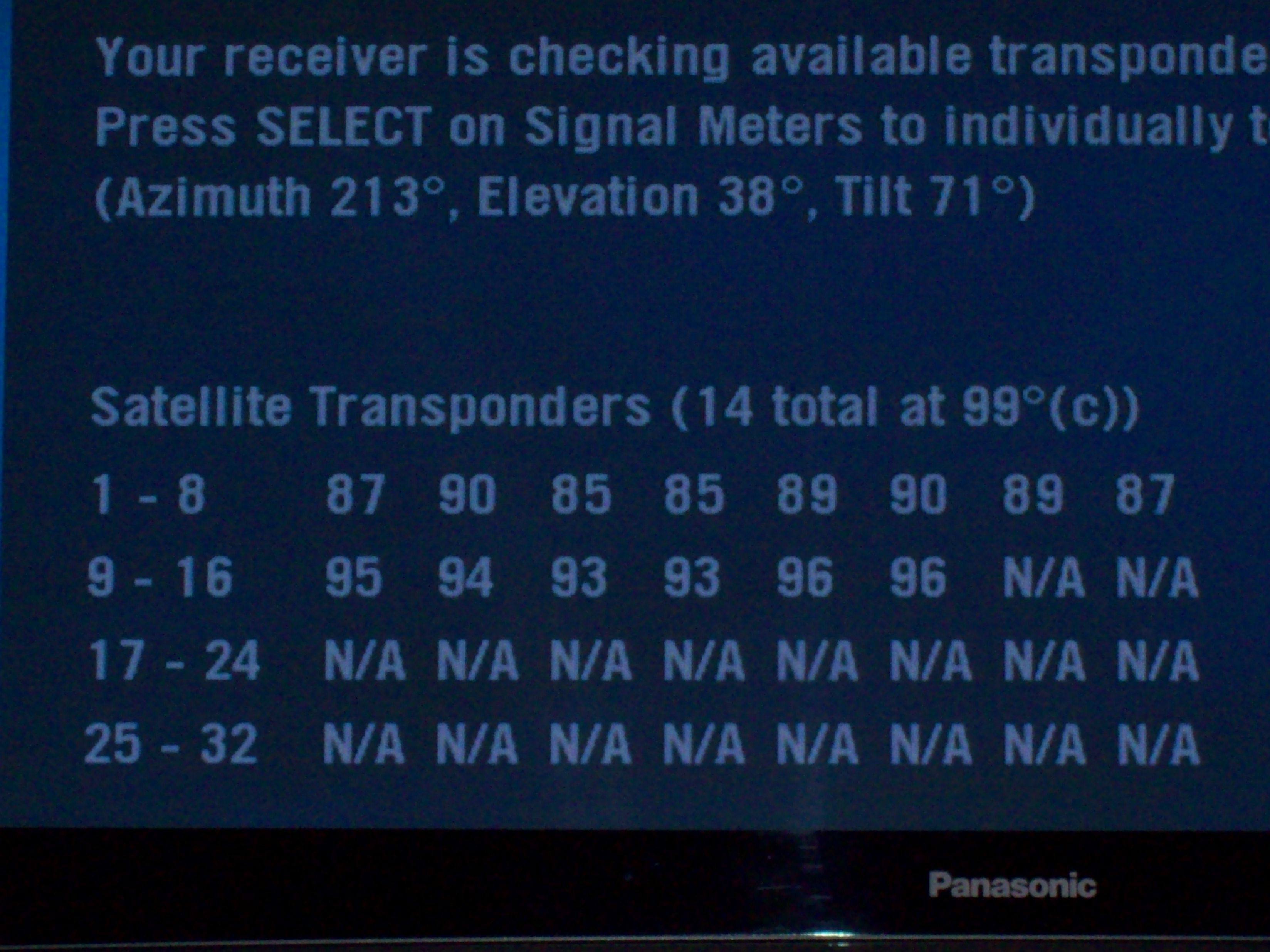

Here are all my current levels ....

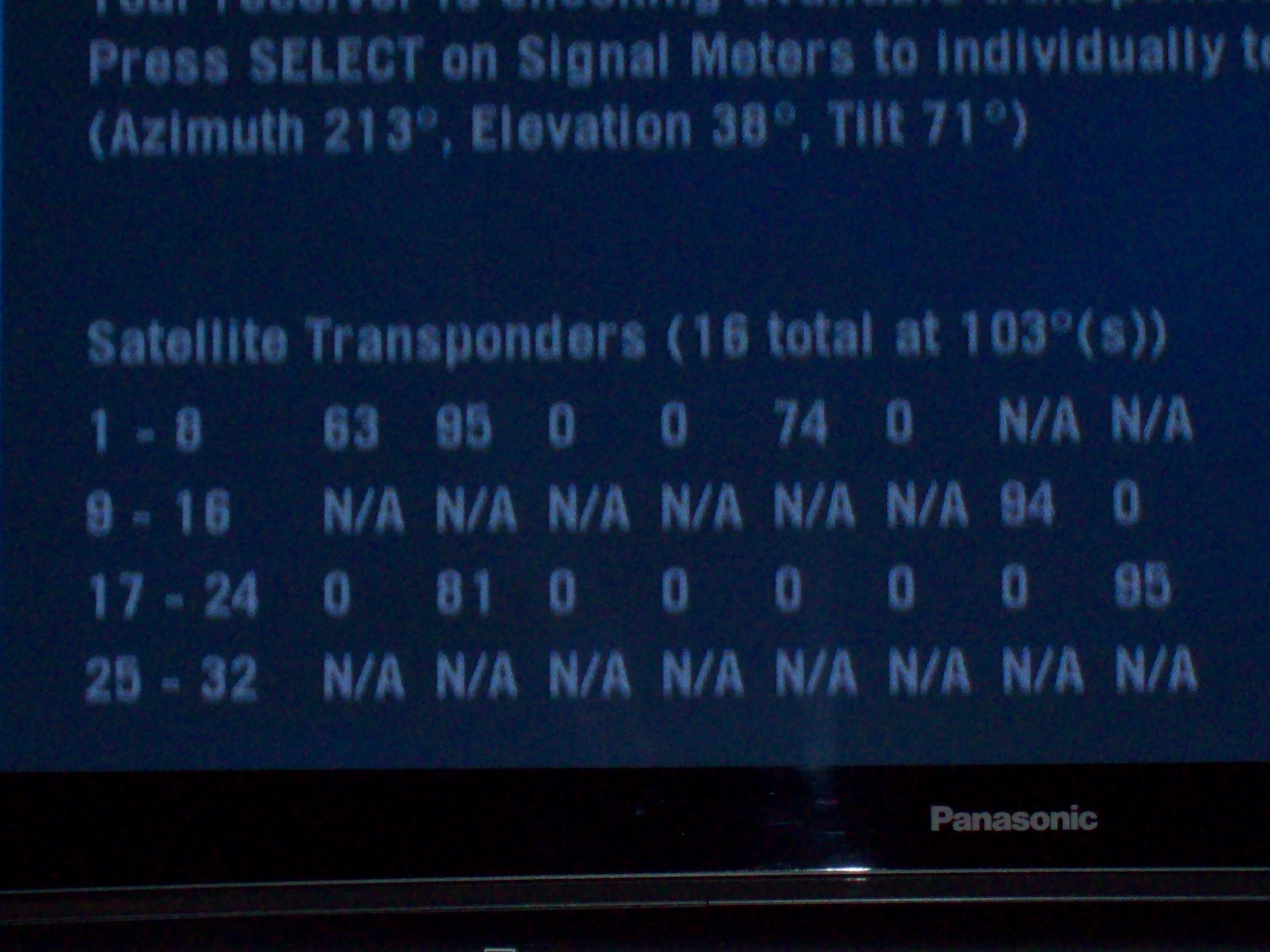

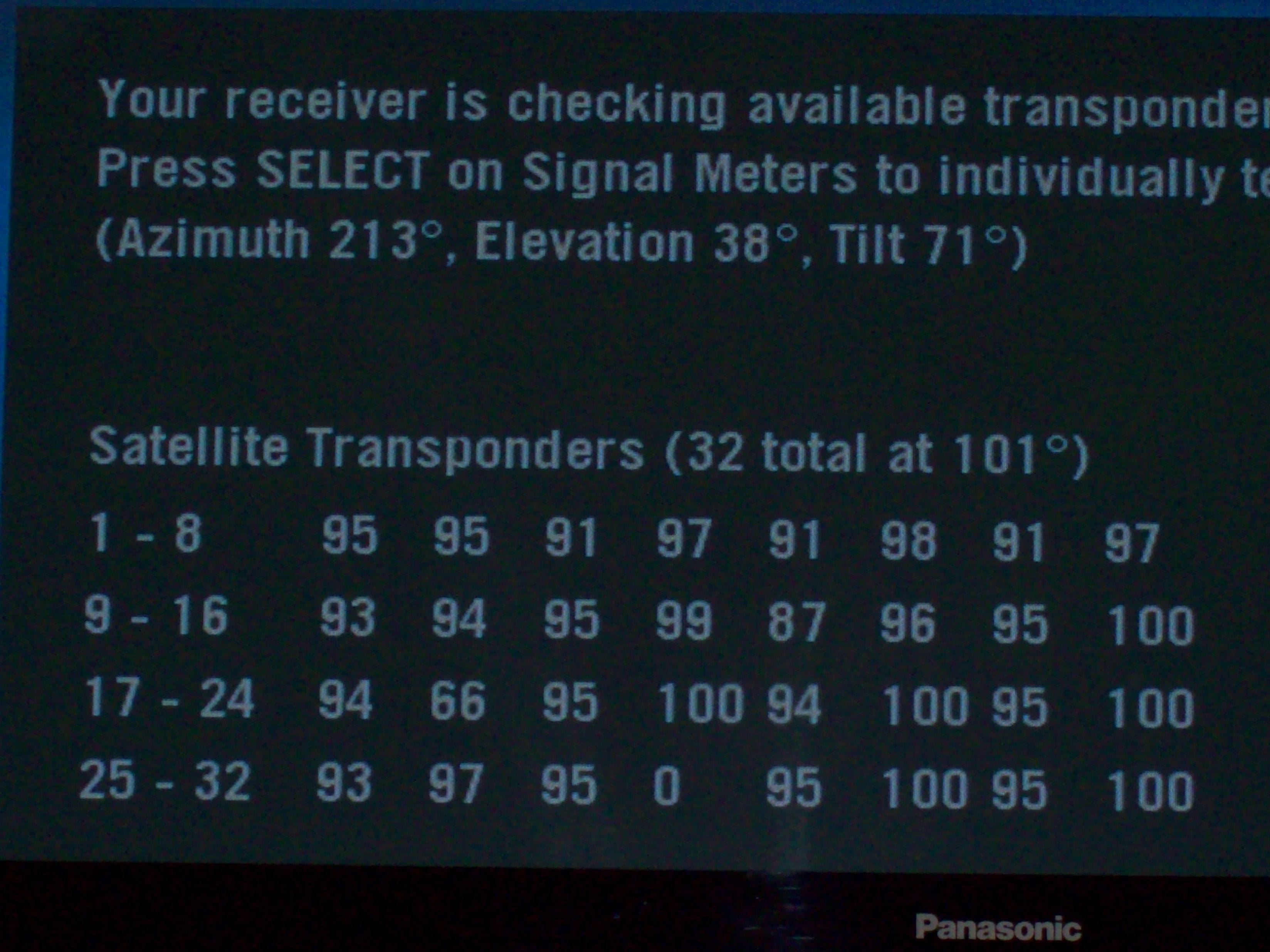

Here are my original install levels from nearly two years ago ....

Your original numbers are a little low, but not bad. The new ones are! It looks like you are well out of alignment. Have you checked the dish to make sure it's at least bolted down? ;) Seriously, check it to be sure it's not loose and tighten anything that isn't. If all looks okay, first put a witness mark on the mast and base of the dish, then try moving it SLIGHTLY in one direction and see what that does to your levels.
