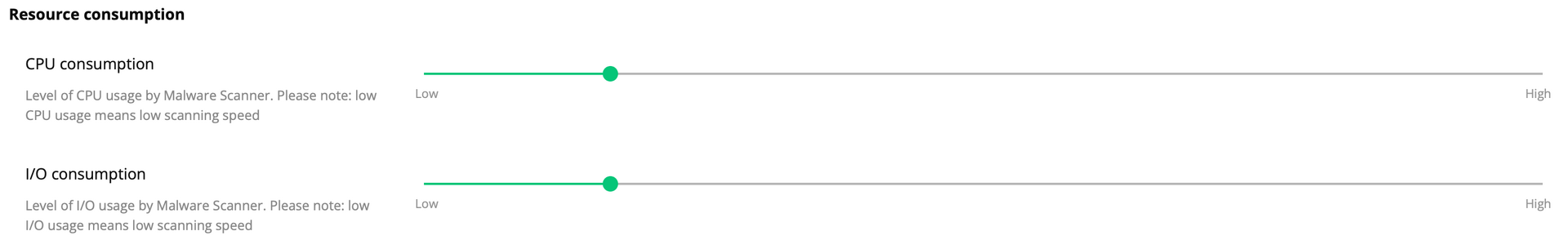

Looks like the server is doing its initial AV / Malware scan, and that is slowing things down. I will change the start time of this scan NOT to start at 8 am. I can stop the scan however if I do this the next time it scans it will be slow as well as it will have to scan everything again not just new and whats changed.
Seems back to Pretty Snappy again for the last :30 minutes at least :)
Yeah I turned down the CPU usage on the AV scanner. :D

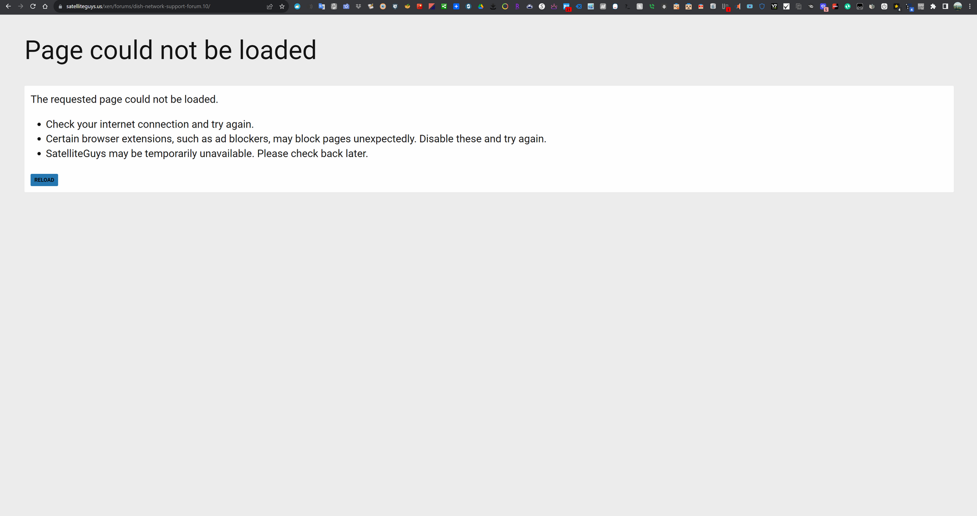

This site is rendering slowly or not at all, sometimes. It's just this site I'm having issues with.
I wish I had an answer as the server seems to be running like a tank and there are no errors to be found in the logs, and no services restarted by the server when you guys are reporting these outages. (And I 100% believe you as well)
