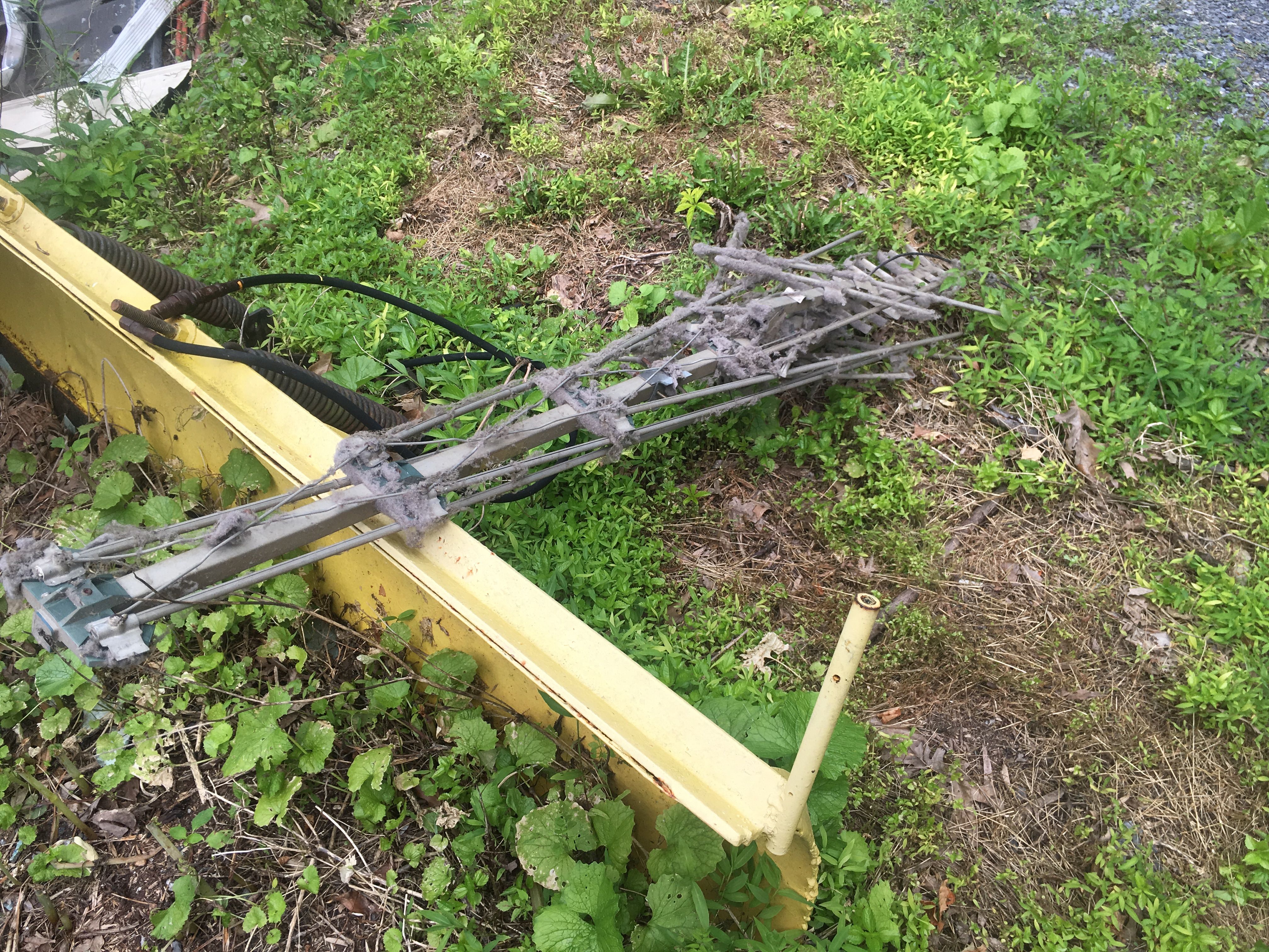

I think I might have found another Gem while searching for the rest of the 10 footer. My dad isn't sure where the rest of the 10 footer is stored, but he says he kept it. While searching the attached garage, I noticed something tucked way up in the crawl space... So I called my dad. "What in the world is that long pole sticking out of the space above the garage." "That? It's an old tv antenna. Not sure if anything is even on them anymore."
Score? Do the old "Porcupine"/Tree OTA antennas still work? The ones with multiple branches.
If they do, I'd be looking at a different receiver to add OTA to the "farm", but it would expand my viewing options
Does it look anything like this? http://cs.yrex.com/ke3fl/Articles/Antennas/BuildingThePorcupine.htm
Not really. It's metal (aluminum, I think. Didn't check though), must be at least 15' tall and has arms that are probably 5' long. Pretty sure at least some of the arms were L shaped too
If you get a chance post a pic - would like to see that! Sounds like a monster. :D People are still using their antennas from the 'analog days' :rolleyes: to get digital so I bet it would still work. Only one way to find out! ;)
There is not such a thing as an antenna for digital OTA. OTA TV still uses the same frequencies today as they did 50 years ago. :)
Yep, that's what I meant by putting 'analog days' in quotes with the :rolleyes:. An antenna is an antenna. Design and build quality will determine how well it works. ;) Give 'er a try and post the results. :)

There's more than 1 hiding up there, it's like playing a game of Jenga getting stuff out of the crawl space, there's tv stuff, audio stuff, lawn tools, etc up there.
I grabbed the smallest of the OTA Antennas, because it was all the way at the front. Holy dust and cobwebs batman!
Reactions: FTA4PA
View attachment 117528 There's more than 1 hiding up there, it's like playing a game of Jenga getting stuff out of the crawl space, there's tv stuff, audio stuff, lawn tools, etc up there.
Like you said, a bit dusty, but as long as the elements aren't damaged it should work for you. Probably made better than many newer ones! :)
Ummm,not totally true,but I know what ya meant Titanium. The old antennas still work.... there is no such animal as an HDTV antenna. But the bandwidth is much narrower today.UHF used to go to channel 83.We lost 52 and above,with limits restricting 51 as well.(Possibly about to lose even more channels)
So an old UHF will have some elements wasted on unnecessary higher channels and have a lower "Q" than a modern UHF antenna cut specifically for Channels 14 thru 51. Provided it is built correctly.
In areas where there are no longer any VHF channels: Chop the mast and remove the VHF off an old antenna..Reset the mount on the UHF section to center of gravity,and you'll have a darn good UHF antenna. ;) People give the old antennas away and any damage is usually on the VHF elements,not the UHF section. ( I made one like this and installed it for the man who gave me my first BUD.He's tickled pink with all the channels he receives OTA now and dropped his pizza box service. :biggrin)
