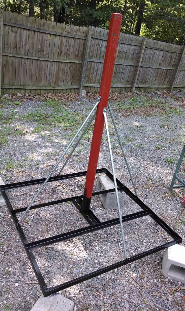

Before putting up a pole in concrete, I'd like to test out a couple of locations to see how the signal reception is from there. Has anyone done this and do you have recommendations on how to position the dish for temporary testing?
I live in the woods with lots of obstacles (trees) so I have a rig I use for scouting purposes. It costs some bucks to build and having a welder is a must:
I put it where I want to test then pile cinder blocks on it then proceed to mount the dish and aim.
