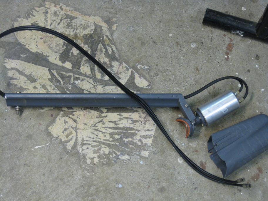

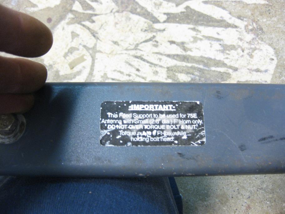

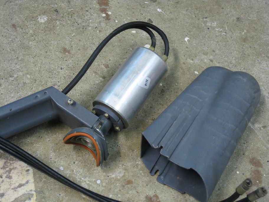

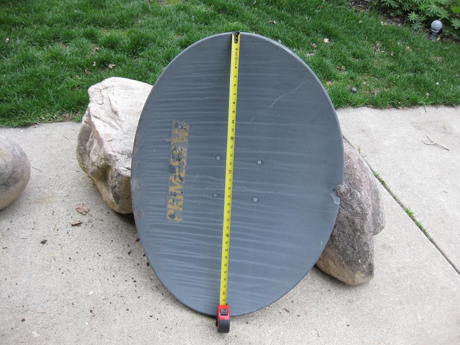

OK, so, im sure many of you can appreciate how busy things can get and how it cuts into your hobby time, well that sure has happened. Add to the fact that the one day i purposely sat down to get a back log of computer work done my internet was down. After a call in to an automated system i got a range 3 days it would take to get things fixed, how annoying.
As you can see, this is some pretty old looking stuff. and i totally forgot to get pics of the receivers...
OH Yes.... That is a dish you can not use. You must immediately package it up and send it to me, ;)freight prepaid..!!!! In other words,
That is one of the best KU setups you can find!!! :D
Now
what was the question ..If you check out my signature, you will see that I do use that dish set up. As far as the receivers go, I know very little about any of them. but others may be able to tell you more.
From the sticker, that's what we call a 75e (for elliptical) dish.
You might check the back end of the LNB, where the cables attach to it, to see if it has an H and a V stamped into the soup-can bottom, one by each connector.
If so, it's a pretty old one, but should still work fine.
Just that it may put out H on one connector and V on the other.
If so, we can help you with that, too. :)

Hanlonmi,
Busy, busy! Certainly understandable, especially this time of the year and getting everything going for summer: i.e. mowing, gardening, farming, etc.
That 75e dish is quite acceptable, but you MAY not get everything with it. That is simply just due to the overall size of the reflector panel.
I have one (actually two) myself and I judge it with a positive rating. The one I acquired (for $5) had a different LNBF attached than the "silver bullet" LNBF that you have. The LNBF on mine was what I call "The EGG". I modified the bracket on the end of the arm to accept an LNBF with a larger diameter "neck" and used an Invacom QPH-031 LNBF. Worked very well for a single fixed point dish. I keep it set up, but I don't use it currently as I purchased a 1.2 M GeoSatPro dish from SatelliteAV and motorized it.
I hope that the 75e that you got there still has the elevation adjuster on the backside of the dish (with the elevation jacking bolt). That is one of the BEST assemblies ever in my opinion, albeit quite heavy (which is a plus in itself, but difficult to modify to a motorized system for the same reason - weight). With that, aligning this dish is a breeze and a pleasure! Maintaining it and tweaking is no question as a fixed point single dish. I was actually able to modify it to accept two LNBFs to get 97W + 99W or 99w +101W. I think I can get 123W + 125W with it but I never actually tested it for those two.
It doesn't have a means to "skew" the dish for multiple satellites, but I manufactured a homemade "ring" to insert in between the dish and the mount that allowed me to do so. It looks very professional and works very well, but I did not provide for any skew angle markings so setting it up was just by trial and error. It worked, but it was a project in itself just to align with that modification.
Yep, that is a keeper for all sorts of projects.

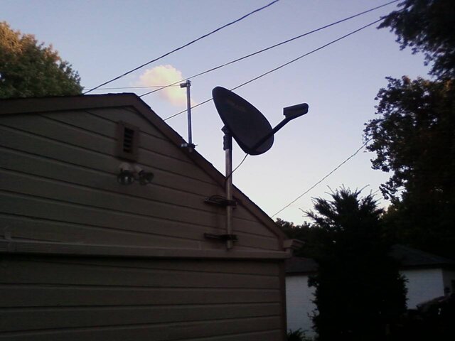

Thank you to all that replied to this thread. i apologize for dropping the ball but the summer just got away in a serious way- but the wife was out of town a week and i got the dish put up!! i did get the... "what is that thing!?" question but its sometimes easier to ask for forgiveness.
So my next step is to politely ask for direction towards some threads or resources or heck, straight up model numbers that can get me some digital FTA stuff going. It seems that the receivers i had listed are all analog models.
sorry for it being a cell phone shot, but there it is up in the air. i have to run coax and as mentioned, see about a receiver, so hopefully we can get the ball rolling again on this!
oh, and yes, it still had the jack screw hardware on the bracket, so it shouldn't be to hard to tilt but the tube i mounted it too was a tad large so might be a bit to rotate it, but we'll see.
