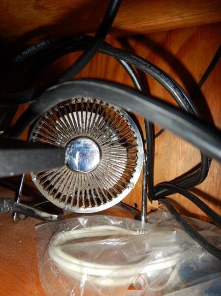

I use the little fan in the photo behind my receiver and ASC-1 to keep air moving around the electronics. I think I paid around $10 at Dollar General.
