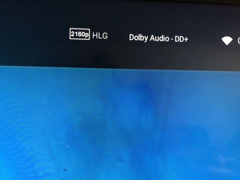

My guess is this has something to do with how my TV is receiving the HDR signal from the C61K. I know the tv is receding an hdr signal from the C61k because it came up with an "HLGHDR" notification on my screen.

FYI here is video someone just posted where they are getting DTV 4k hlg hdr to work on an LG OLED TV. So that confirms it is HLG and that it should work. I thought I'd already went through the settings on my tv and Genie mini, but I'll give it a go tonight again just to make sure.

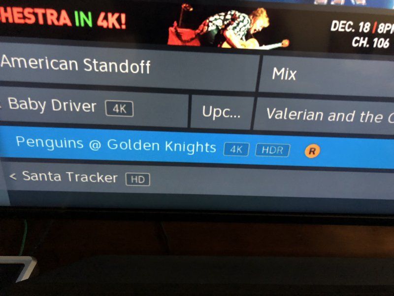

a quick scan of the guide only shows tonights hockey game as an HDR show for the next two weeks

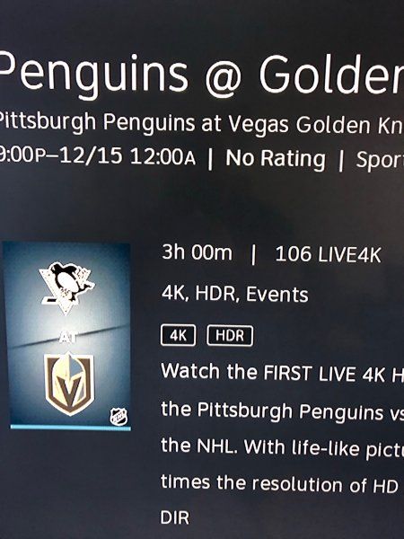

I show HDR in the info but not in the guide for the game tonight. Something odd is going on though. Someone else commented channel 104 was kicking there vizio info HLG mode but the content was clearly not HDR. Would be curious if someone with a TV other than a 2016 LG or Vizio is getting HLG also. The whole thing is strange as there is zero news about HLG being used in the US yet
Reactions: bgothard72
My guide does not show the HDR symbol but does show it in 4K.
Me, too. We have HR44s, you have to have the 4K client to see all this fancy stuff. We dont even see the banner for the Brian Setzer Orchestra concert in 4K, which is fine.
