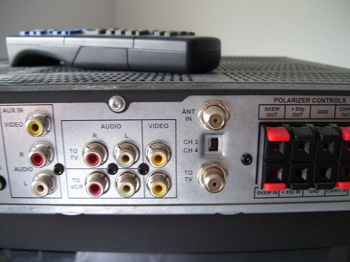

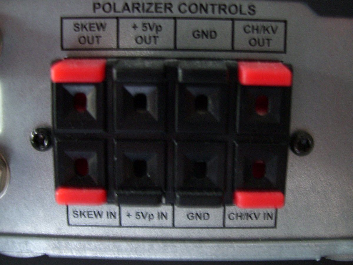

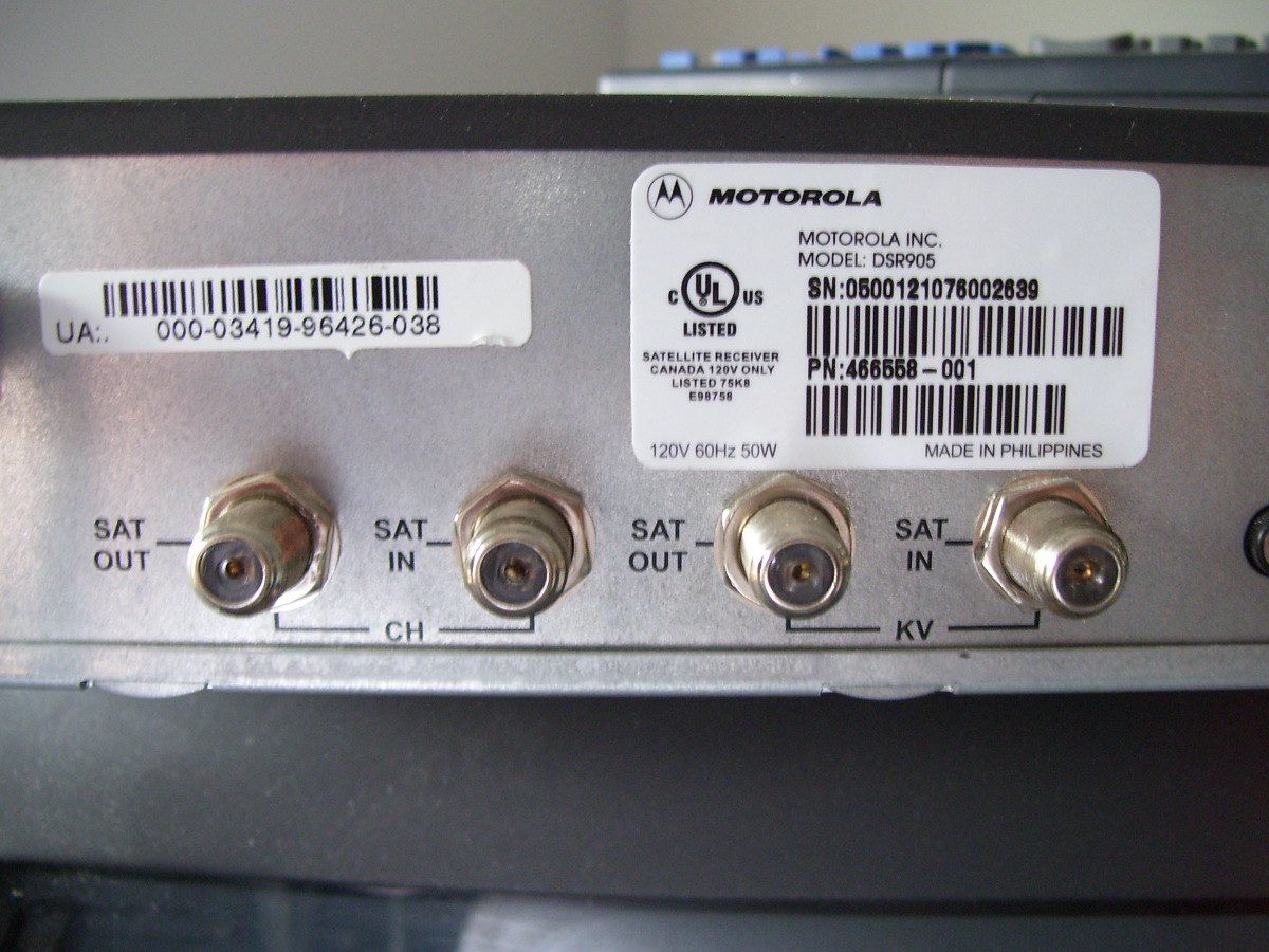

yes. The 905 has inputs and outputs for C-Band, KU Band and the polorotor. There is a "A/D" button on the remote that switches between analog & digital (like a TV/VCR button worked on a VCR back in the day ;) )
When hooked up that way, when the 905 is on, it controls the polarity but when its off the analog box controls it. I guess the question would be if the OP is mainly going to use the Pansat then I would just wire up the polorotor to the Pansat
edit: found some old pics I took of mine
