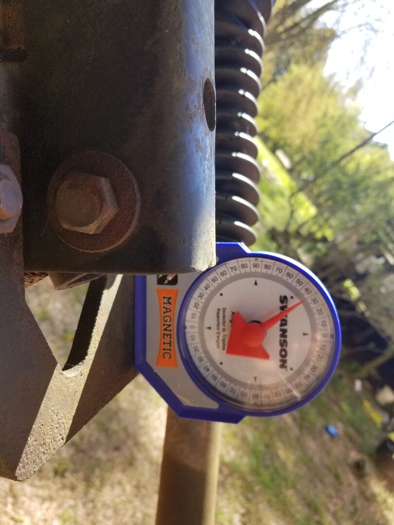

Boy could sure use a little help, before I end up doing something I may regret. First let me say, I know very little of the history of this dish and it had sit for the past 25+ years before now getting around to doing something with it. That said, I'm a little confused. I am following the TVRO guide and declination table to verify/align this dish. My location is ~/= 35.5N 78.5W. Acordding to TVRO chart, my settings would be 36.63 elevation and 41.78 declination (36.63+5.16). I set the dish for true south and aligned the elevation saddle to the highest point in the arc. When I checked my elevation angle it was at 50 degrees, (I had played a little with this adjustment will spanning the arc before hand so I was not that concerned and made an adjustment to ~36 degrees.) When I checked the declination angle it was at 60 degrees which seems quite off for my area. I tried to make the adjustment back down to the ~42 degreen but when I got down to about 50 degrees the adjustment bolt was striking the elevation piviot bolt restricting movement. My question is this, I assumed that the dish was correctly aligned and setup 40+ years ago but would not put it past the previous owner to screw with it prior to selling the home but that does not appear to be the case as hitting this mechanical limit tells me something else is not right. Before going cannabal on this and grinding away a 1/4" inch of the adjustment bolt to obtain the clearance needed for the adjustment I thought I would bring it before the group and just double check my settings a procedure.
For 35.5N, axis elevation would be 36.63? No way.
Modified axis declination would indeed be about 36. And with axis declination = 36, axis elevation would be 90-36 = 54 degrees.
See post #40: "At Latitude = 35N, axis elevation = 54.4 (modified angle), and declination offset angle (modified) = 5.0 degrees."
So the total dish declination value of about 41 degrees is indeed right.
Elevation means number of degrees UP (backwards), from vertical position=0 degrees.
Declination means number of degrees down (forwards), from horizontal position=0 degrees.
Elevation = 90 - declination.
Declination = 90 - elevation.
So I guess there's a bad mixup in terminology, and as a result of that, of which numbers to use, from TVROsat.
They write Your elevation angle is approximately equal to your geographical latitude.
But that should have been Your elevation angle is approximately equal to 90 degrees minus your geographical latitude.
However in the picture, they indicate the angles right.
The chart again uses the incorrect term 'elevation angle', for the value of the 'modified latitude angle'.
As your pictures with the inclinometer are taken from so near, I cannot see where you were measuring. So I cannot comment on that.

Thanks again for the input. If I understand you correctly, my elevation setting would be 54 degrees and the declination would be 41. That does agree with a phone app that I had used to find the satellites. I realize that my pictures really did not provide enough detail. The phone had issues and I was unable to provide any additional pictures at the time. I now have new phone and once set up I will provide additional pics after making dish corrections and to see what satellites I can find. Thanks again. I think my wife wishes I would just move on with this project :).
