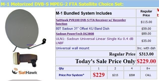

He was looking at the combo setups on Saduan's website they have a "motorized" setup for $229. I'd add a link but I'm not allowed since I'm a new member. But here are the specs as listed on the website.
Would this be suitable for our needs? Or should we piece meal a setup on our own? Is motorized required if we want to receive both NA and International channels?

I would suggest you look at the package SatelliteAV links I his signature.
Yes, he's an advertiser here, but I wouldn't recommend if he didn't have good stuff.
First off, his is a 36" dish. Some day, that'll matter to you. :)
His included LNBF is a new PLL model, with lifetime warranty.
The microHD receiver seems the current leader in capability, price, and support.
Pick one satellite to aim at and get educated in the ways of FTA.
Later on, by all means get a motor; that 380 @ Sadoun is a good choice. ;)

You will need MPEG4 receiver and 36" dish...
...to get PBS and other HD channels. The Sadoun combo linked to in the original post is an MPEG2 receiver and 31" dish.
Suggest the MicroHD receiver and 36" dish with PLL LNBF from Satellite AV. That's what I would get if just starting out. Later you can add a motor or more dishes with a DISEqC switch to access more satellites.
