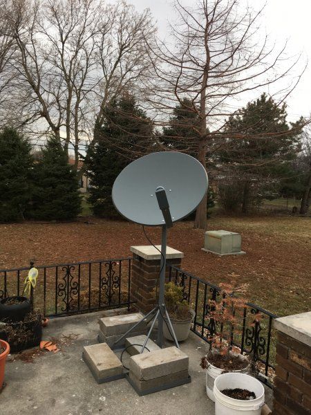

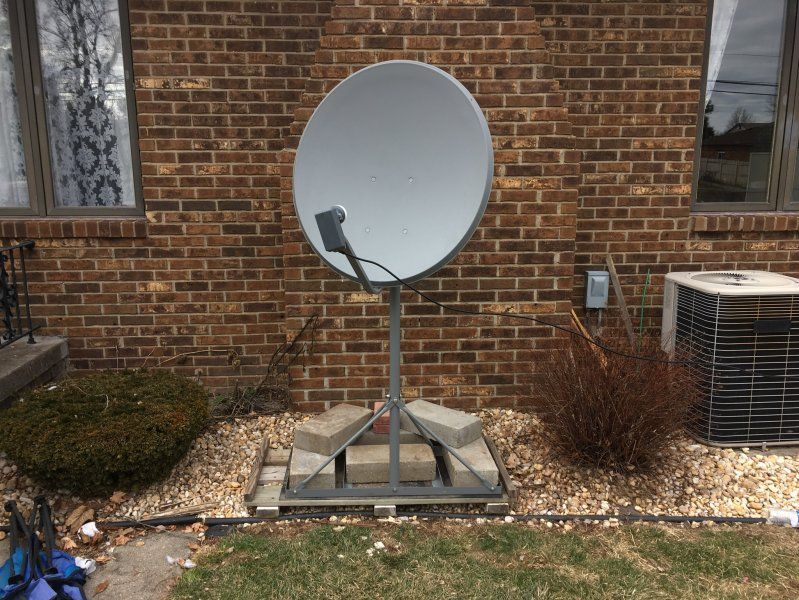

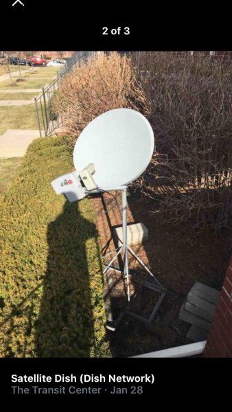

I'm having the same problem. Yesterday, I wanted to move my dish since it was in the middle of the sidewalk I moved it to my chimney. I checked my Q near the chimney and it was 33%. I moved back to its original spot and I got nothing at all on Galaxy 19. So, I spent 30 minutes looking for G19 but I didn't get anything. I moved it it back to the chimney, decided to try Galaxy 3C and got 67% Q. My receiver won't pick it G19 at all. Is it the trees? I have no clue what's the problem.
(The second picture is the best picture I could find of the trees. Will take more tomorrow)
View attachment 131797View attachment 131798

Can be hard to go by pictures as there are to many variables(camera angle, etc).
...but sometimes they can help. However, showing pictures looking at the dish is not going to help. ;)
You need to stand behind the dish and try to capture the same area the dish is pointing.
I think it's normal that you get lower signal quality on 97W compared to 95W - it's like that for me too.
This said, you should still be getting 97W loud and clear, I even get it with a 50cm Dish500. if you move west from 95W, are you able to get anything at all? 99w is usually very strong. Also if you lower the elevation by 1-2 degrees, you should be able to get 103W, at least the NHK/RT transponder - that one is very strong.
can you take a picture from right behind the dish, looking toward 97W so that we can check for obstructions such as tree branches?
