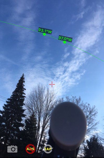

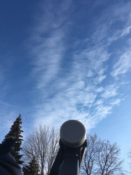

Looks fine to me - I don't think those trees are any problem for 97W.

48% on 99W seems low, especially since you're getting 73% on 95W. I would expect them to be a bit similar (assuming that was on the transponder that has the Jewish channel and the Russian radio stations). So may there are some obstructions after all

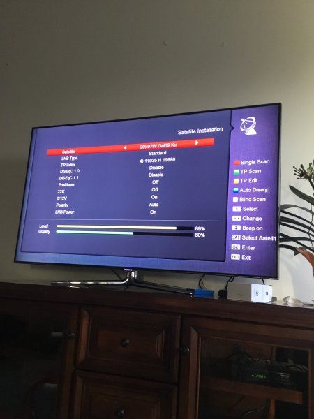

Ok, I finally got a lock on 97w with 60%Q. Thanks everyone!!!

Yes - 12152 is a great one to find 97 with. Agrees. But if you want to know if your dish is aligned the best then you will want to aim until you get 11842 and believe me it's the hardest to get in and a real pain at some time.
I get average of 55% to 58% with 11842 and 12053 I get 65% to 68% on average.
Reactions: Phalaenopsis
FYI... On 90cm and smaller dishes, 11842 requires a slight pan to the West to optimize SQ as there is adjacent satellite interference on this TP from 95w. If a dish is optimized for 11842, other TPs Signal Quality will drop and visa versa.
1.2m and larger dishes reject the interference.

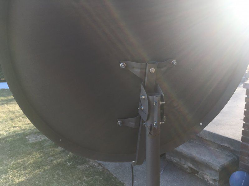

I'll go out to try to get better Q. My lowest Q is on TP 12152 and I only get 39-46%
1.8 meter prime focus dish
